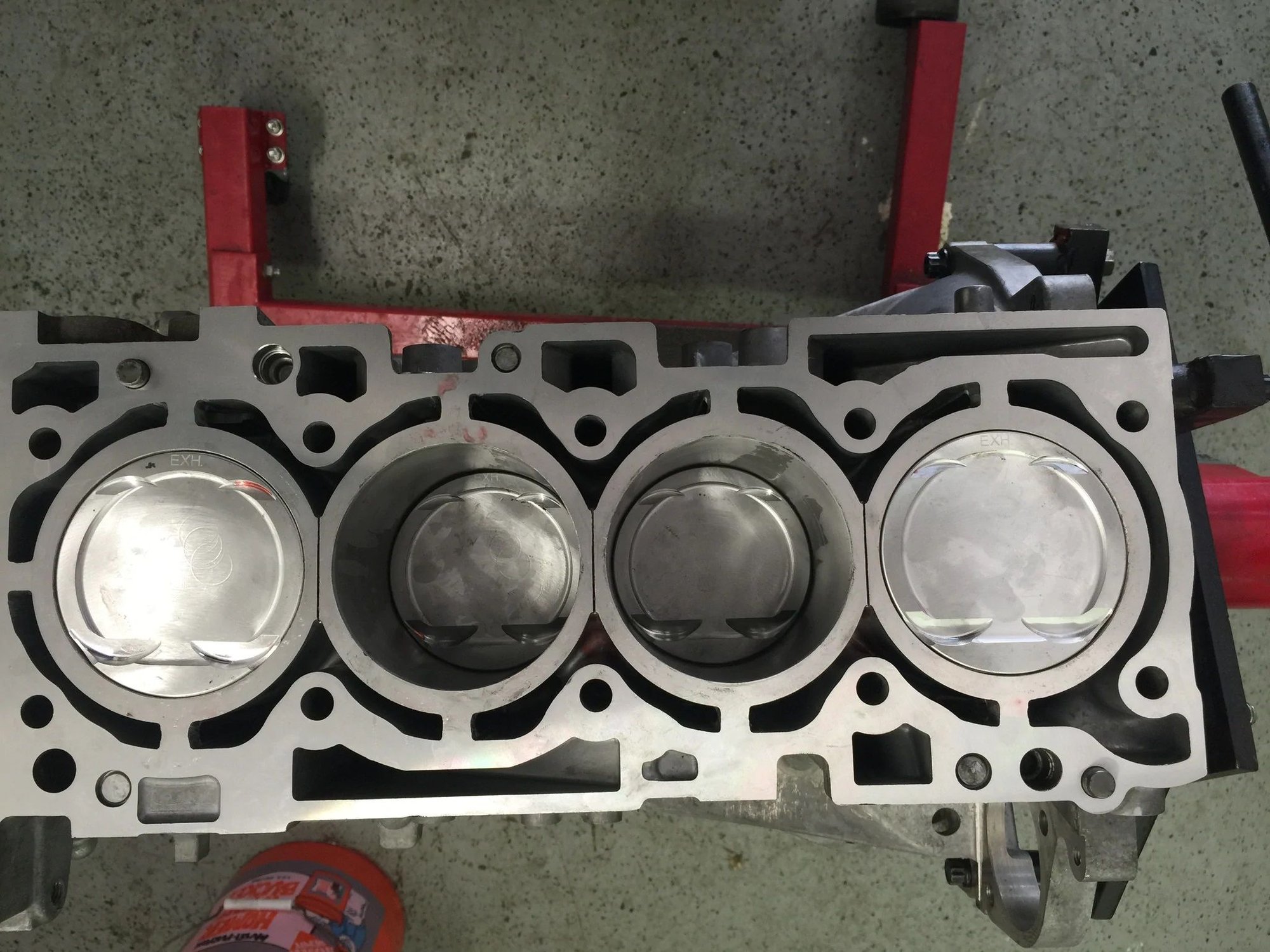

Consider the block of the 4B11. It certainly appears more beastly than the K20 w/the reinforced cylinder wall pillars and what appears to be thicker cylinder walls. Even the 4B11 needs sleeves at certain high HP levels

Honestly, after looking at the K20 vs the 4B11, which is actually a better comparison vs the 4G, i am a bit disappointed w/the weaker looking K20 block (totally understand it can hold great NA pwr)

Kseries will do 600whp on stock sleeves. Then they need sleeved same as a 4B.
FWIW, I don't build 4B's without sleeving them. Just not worth potential issues.

Thanks Sean. Still likin the 4B's block vs the K20. Totally get the sleeve issue during a build (might as well for sure)

Based on K's that have been built well into the 4 digit range the block doesn't have any issues
