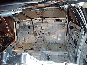

Sunday afternoon progress.
Attached Thumbnails Pikes Peak or bust!-2006-evo3.jpg   Pikes Peak or bust!-2006-evo4.jpg

Front of the car is just about stripped clean. Drivers side strut tower was pushed in so far I can't get the brake booster out.
Attached Thumbnails Pikes Peak or bust!-2006-evo7.jpg   Pikes Peak or bust!-2006-evo8.jpg
