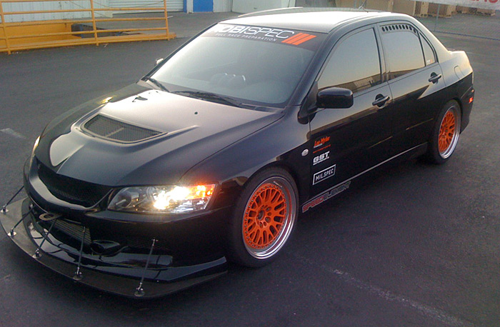

Busting our asses this week for Redline @ Utah this weekend...
Car is coming together. Wish us luck!
Pardon the iPhone photos. Will get real photos this weekend.
Some of the stuff isn't as well done as we had hoped but limited time forces revisions after.

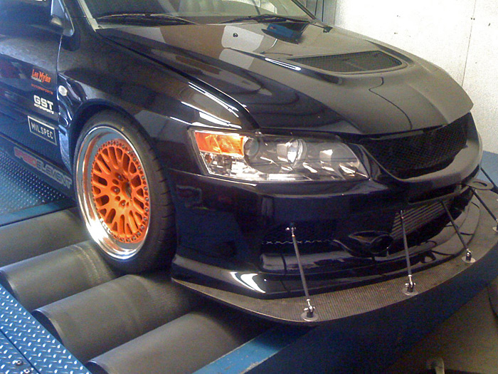

Splitter looks really stout... have you put a good angle finder on it? from the pics it looks to have positive rake... if so, being so big, it might create lift like a hover craft. shoot for -1.5 to -3 rake.

Hell, I'll be happy if all this Aero crap just stays attached to the car for the whole weekend . I sure wish that I would have had time to get all this stuff done and TESTED before making this trip, but you all know how that goes.
I sure miss the clean look of the stock wingless car......we'll let you know how it all works out after this weekend.

Did you guys bolt that splitter to the chassis under the car, like at the radiator support and engine brace? I also thought the splitter looked a little pointed up. With the high pressure area above it pressing down it shouldn't really create lift, but it would be better flat or raked down. What's the construction of the splitter?
yes it's bolted to the bumper beam in the front and the frame rails in the back.

I just realized...good luck bleeding those brakes on the fly. As nice as those wheels look with those color combos, bleeding brakes on the fly and removing those wheels look like a necessity.
