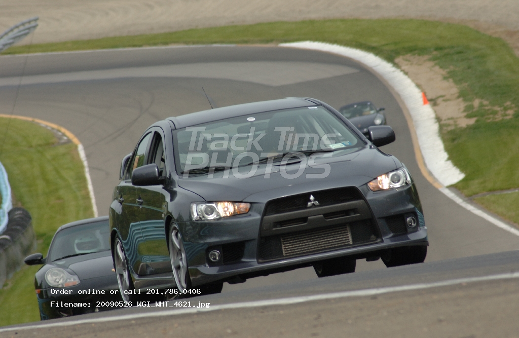

Some shots on the move from Track Time Photos, I'm going to have to buy a few of these. You can see my brake guides under the car in the first picture but I need to have much more airflow ready to go for my next event. Likely I'm going to get some 3" ducting in there and replace my front rotors with the 2 Piece Girodisc.

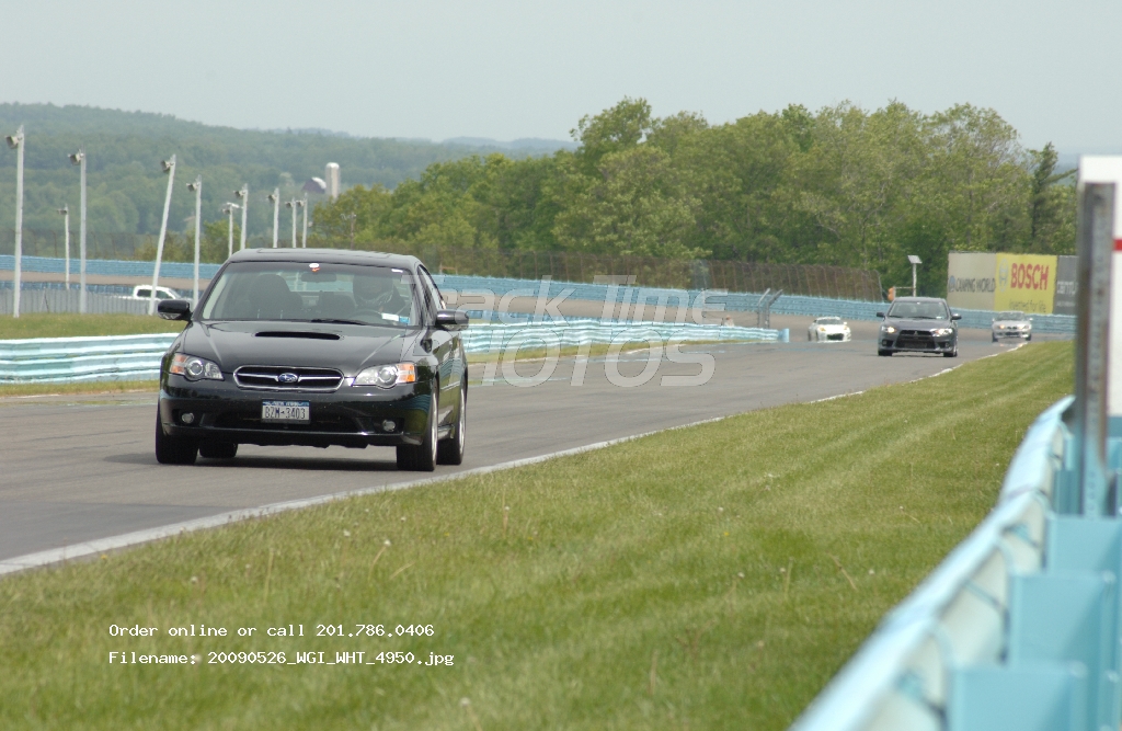

Entering the back stretch out of the esses.

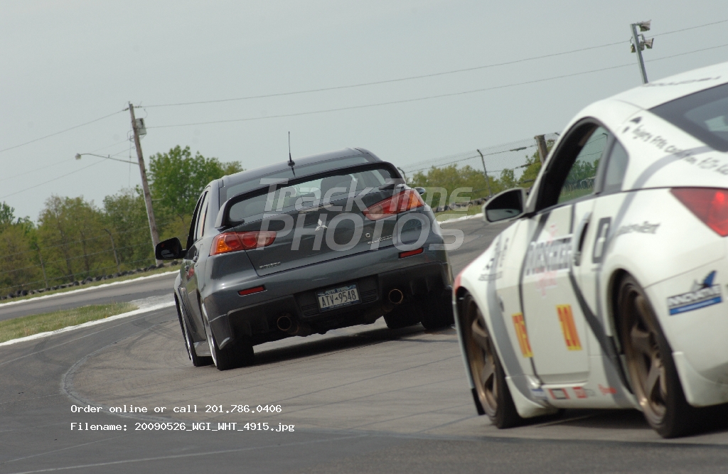

Practicing a late pass into the Bus Stop

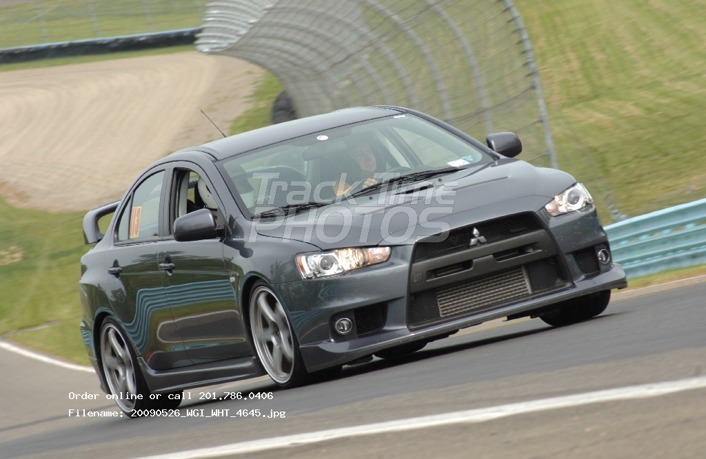

2009 One Lap of America VR4 at Seneca Lodge

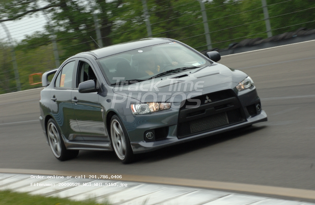

A 350Z in the Instructor group that needed a reminder why the proper speed and line in the rain is important.

3" ducting, yes. But I'd hold off on the 2-piece front rotors and put the money elsewhere - unless you've killed the OE's already
Wow - gorgeous shots

We'll see, the front ST43 pads barely showed 1mm wear in 8 sessions while the rotors got hot spotted and shuddered on track when pushing more than 8/10ths. These OEM rotors got replaced by Mitsu 1 month ago and were fine on the street this time but warped badly when overheated. Perhaps I didn't bed the pads in well enough the night before and the lack of airflow didn't allow them to hold up. They seem almost 100% fine when cold so last night I moved to Magic Pads for the street and cleaned them up. I evenly sanded the surfaces with 60 grit and with a little luck they will come back. I may try and get them turned if that didn't do the trick as there seems to be plenty of meat on them of course. I took it easy on the drive to work and will properly bed the magic pads in tonight.

Probably bedding issue - I've been using the ST-43's as well on stock rotors (I love these pads). Seeing about 145mph into turn #1 at Summit Point with ZERO issues.
Big difference, I guess, is my weight; 3260 with me and about 1/2 tank of fuel. As well, AMS brake ducting kit.
Also- think about bedding the rotors in the night before. That's great if you're at the track already, but normal use (on the way to the track the next day) may in fact scrub off those rotors of the very material you want?? Acting like the 60 grit you used to clean them. Just my take - I'm certainly not an expert.

I've seen this to be 100% true. I've had TONS of brake problems in the past. Now that I properly bed my brakes I've never had juddering at all. I used to just live with it. Trust the experts when they say it's not a warping issue, it's a transfer issue.

Thanks for the pointers guys, turns out I didn't really do a proper bed in procedure as I was rushed to get out the door Sunday night. I only got on the brakes a few times towards the end of the drive down thinking the pads were seasoned so no big deal...
Big ooops as the first session on Monday morning was the first real heat cycle and then the cooldown wasn't long enough before parking it nor was the time period before the 2nd session of the morning. Next time I'll know better and getting some better ducting back in there again certainly won't hurt matters.
