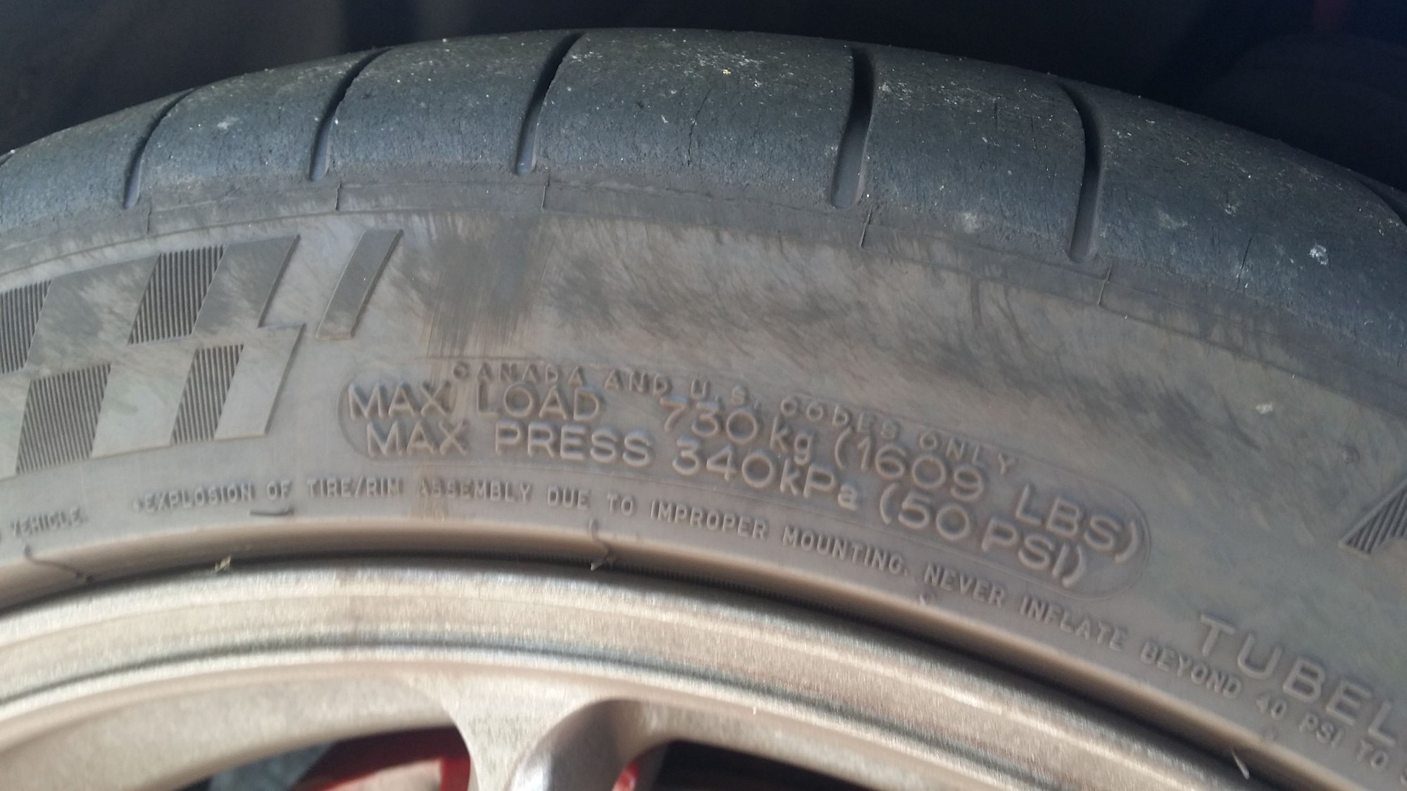

I noticed after every autocross event my front tires have this wavy look on it. The last event I marked the side with chalk and it didn't fully remove the chalk but it did make it look a little bit hazzy. I am running 32-34 psi on the front cold. Tires are pilot super sports. So is this the sidewall being rubbed and I just need to increase my psi? If so what are some good psi I should be running. This is on stock struts with swift(red) springs.
Yea, bump up your cold psi a few lbs, or get an alignment for more negative camber. And for your next set of tires, move up to the next performance category. For autocross, the Bridgestone RE71r or BFG Rival S will be your fastest options.
I'll try bumping em up to 36 for fronts and 34 for rear. If they still show the same thing then maybe some more until they no longer do that. I don't plan on getting a more competitive tire. Just using pilot super sports since car is DD and want some decent miles out of tires. Also I think I learn a little more running tires with less performance than the big hitters .
If you're autocrossing, you're going to wear those PSS's out faster. The RE71r or Rival S are soft. But if you go with something like the Dunlop Z2*, you'll be able to get 20k miles out of them. I had a set of Dunlop Z2's on my car when it was stock turbo/E85. 15k miles and 10 autcrosses and they still had about 4-5/32's of tread left on them. Or just find another set of OEM wheels for $300-400 and run something really cheap and long lasting for the street. Like the Bridgestone re760..

The super sports deflect a lot. It's possible that it only just barely touching the pavement. A local guy here in vegas had the PSS on his car and they looked the same.
A buddy of mine ran 1 event in his modded Evo X. Full bolt-ons, H&R springs, and some 255/40/18 Continental DWS tires. Even at 44 psi hot, he rolled his tires bad and it looked just like what the OP posted. I'm attributing some of it to improper driving and the car spinning out on almost every run.

if it's rollover, i dont understand how the center of the sidewall is scuffed more than the edge of the tread, there's a lighter area between the heavy scuffing and edge of the tread where its not scuffed much. if tire is rolling over that far, i would think that the scuffing would be uniform from the tread to the middle.
btw, i dont autox much to know what tire rollover looks like, im just speaking from logic.
I didn't hit any cones and there were no curbs at this event. It only happened on my front left tire and not my right. There was a sweeping right hander that I had to brake for and then turn right. I'm thinking that's the corner where something was causing the tire to roll over/mark it up.
