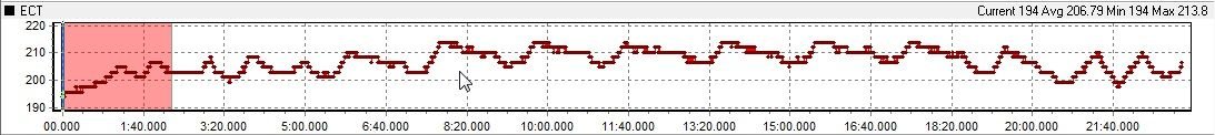

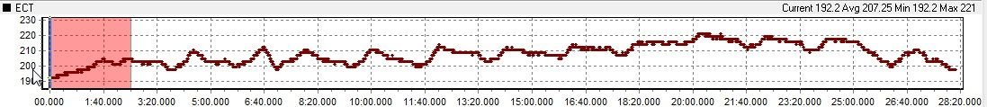

Yes, highest coolant temp hit was 221 deg F during one of the afternoon sessions. Still running with OEM coolant since she's not completely dedicated to the track. Temps can dip here in the northeast early spring and late fall, and I park it over the winter.
Here are some logs from the afternoon sessions at Palmer.
D1 S3
D1 S4
D2 S4
D3 S3
