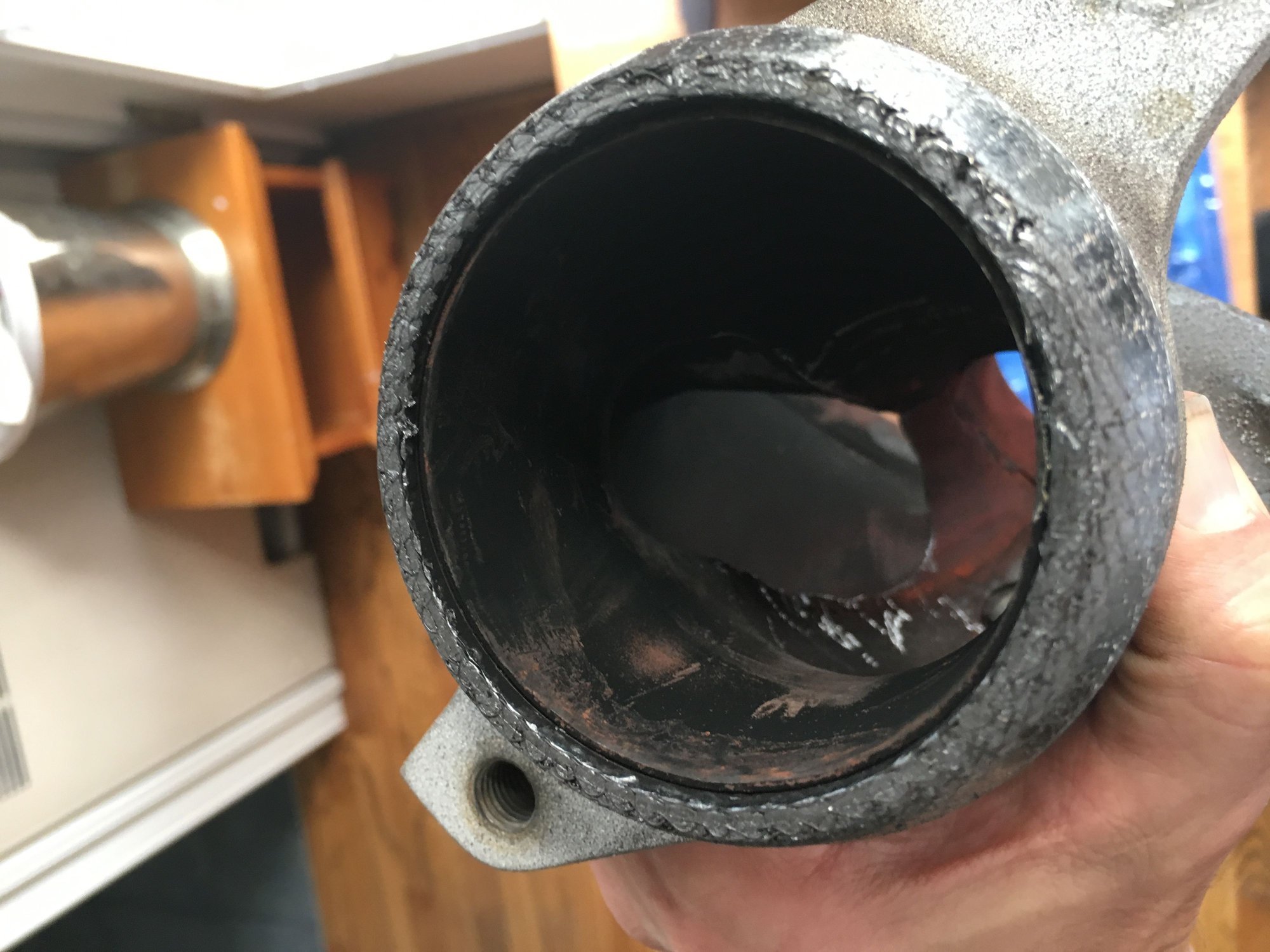

Originally Posted by codgi
Yeah HPDE with the longer sessions put a lot more heat and stress in the system. Like Dallas said you want to do what you can to get that boost controllable and predictable as well. So it's worth pulling that down to get that solved as opposed to having to pull it down for other reasons IMO.
I finally pulled the ebay O2 housing off, without removing the turbo (yay nickel antiseize used in previous installation), and ported out the passage for wastegate flow. It wasn’t that small, but I mostly removed the internal wall in the housing. Took care of the creep issue.
Old Oct 13, 2017 | 02:47 PM
kaj's Avatar
kaj
iTrader: (60)
Posts: 13,634
Likes: 824
From: Fresno, CA
By "wall" you mean the separator between the WGA and turbine portions?
Yes.
Yes.
And it helped? Noted (I literally have a notebook full of informational bits LOL).

No before pics, but here’s the after porting result:

those sheet metal o2 housing dont last very long for heavy track use. i've seen many cracked on track. get a cast stainless one, usually dont have divided ports, so you wont have that boost creep also.
Now you tell me! Any recommendations on brand?
