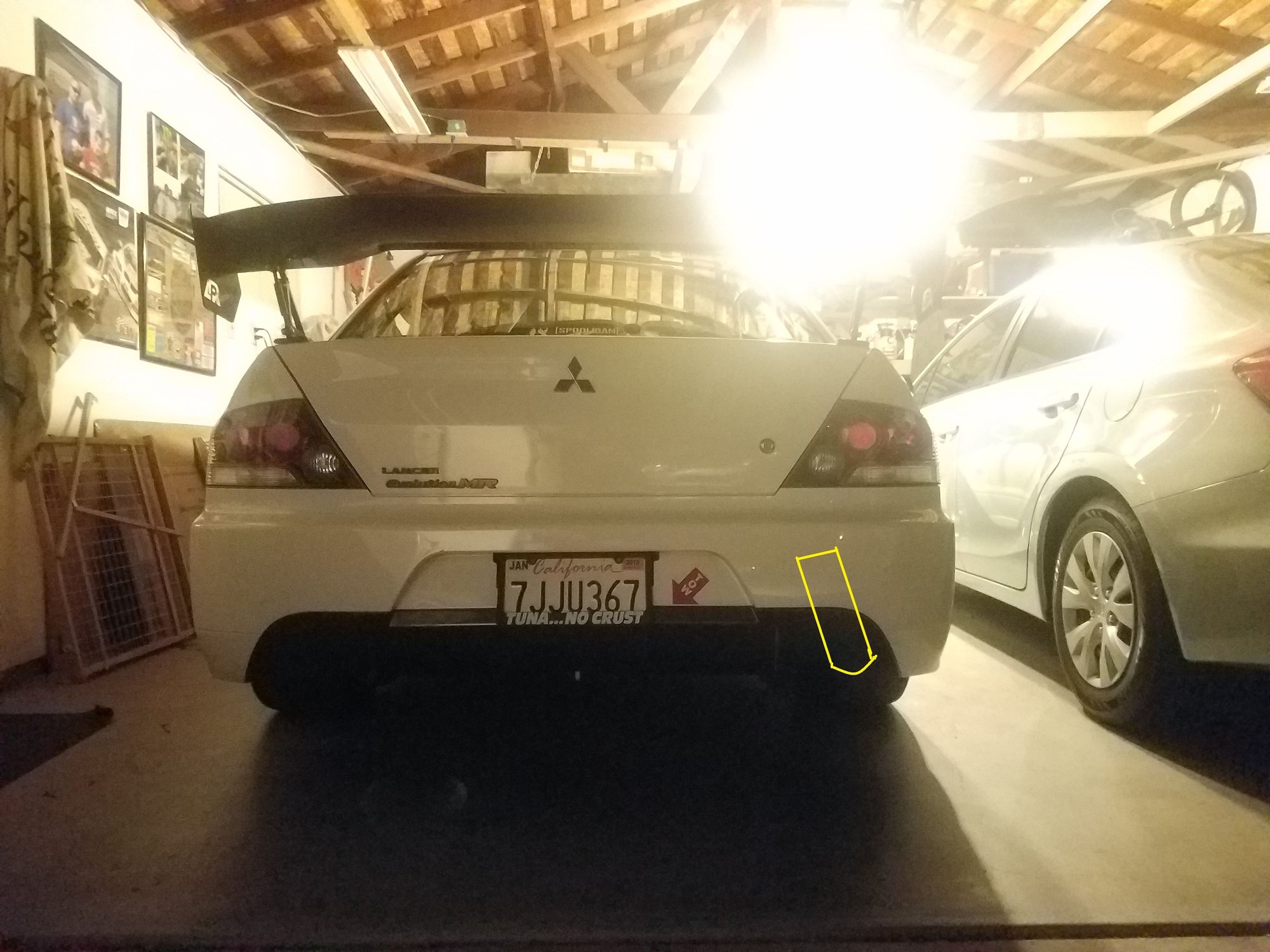

So, I have an MHI turbo,
resonated test pipe (probably Megan),
and a 3" SS straight-through Magnaflow (4" tip) on a 3" CBE that I can't remember the name of. Anyway...
I'm adding a 4" 45* or 90* elbow (whichever fits) that will extend up
approx 10-12" and to the left.
Has anyone passed MRLS's sound limit with a similar setup? it's a long drive and VERY pricey so would hate to get kicked off.
My plan b is to put the stock CBE and do a retune... but I can't imagine an FP Green being too happy with that kinda back pressure.
Opinions?
This is approx where the elbow will set. I am worried a bit about heat; I've seen a melted car once.

When we had issues passing for sprint car races we put 45deg tips and pointed them down to the ground.
Seems like pointing up would make it worse.
Another trick is find the location of the sound Meter and point your exhaust the other way.

The MRLS sound tower is on the straight before the kink, on the right side I think. I would point the deal to the driver side, maybe 5-10* below level. 90db is funny. A lot fo stock cars won't even pass that...
Below horizontal? All the tips I've seen are at approx 45° upward. Hm.
I had a WRX that passed With a test pipe and a reasonable muffler. That car was uncommonly quiet though.
Maybe I should just retune with the stock car back.
Yes.Pointed to driver side will point the sound away from the sound tower. Pointing it slightly down will angle it towards the ground a bit, which will make it a bit quieter.
I like that idea; I've seen more than one car with melted bumper covers from the exhaust pointed upward. Running a lil' rich, I guess.
I'm tossing on my stock cat back and retuning with less boost. Gonna see how it does. I may go that route as long as I'm at at least 300-350whp.

I tried a Greddy Evo2 w/ a Coastfab 10" mini muffler added back in 2011, and still hit 94 when WOT. It depends on the weather that day, as there was a whole lot of cloud cover in the morning, so lots of people were blowing sound, but the afternoon went fine once it was sunny. If you do an elbow and point to the left like you show, you should be okay. Most of the setups I've seen at Laguna point up, not down for whatever reason.
