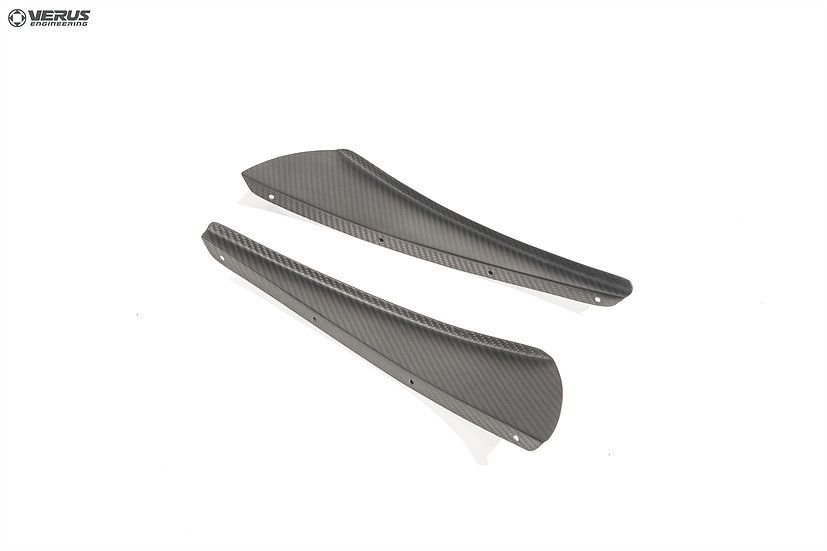

I've been working with Verus Engineering (formerly Velox Motorsports before the name change) on my Aero bits and recently visited and saw a lot of their parts and design process first hand. I have heard a lot of guys over the years say they wished there was a front canard/dive plane for the OEM Evo bumpers that was tested and proven and bolt on that made some real differences.
Verus has done CFD designed canards for several platforms so far and I asked them about the Evo and they said they'd love to get into that market if there was a demand. Any guys seriously interested? I'd love to help bring a product to market that is truly motorsports grade, CFD tested and proven, and could benefit a bunch of folks. Their canards are true pre-preg dry carbon and I think for other platforms run around $300. If enough guys are interested maybe I can talk Paul and Eric into going through the process of laser scanning stock E8 and E9 Evos, modeling and designing and producing these.
Here is a link to one of their Porsche canard products. . .
https://www.verus-engineering.com/pr...ane-canard-kit

“Through our back to back testing with GearOnePerformance, we were able to increase corner speeds by 5-6 MPH with the additon of our dive planes only.”
Really? That sounds like a massive gain for a couple of dive planes.

From discussing it with them, part of the gain came from shifting the aero balance forward and making the car more balanced. Some of the gain came from the driver having more confidence in the corners due to a better balanced, easier to drive car.

Interested. Just want to see CFD and data-logged evidence of effect. There are plenty of bolt on dive planes/canards for Evos, none of them come with the data to back them up.
Would these be for stock bumpers/bodywork? Wide fenders? Splitters?

That is exactly what they do. Everything is 100% CFD optimized from 3-d laser scans of each individual platform they do. So fitment is perfect, and performance benefits are proven. They have tons of CFD data on their IG page and website.
Each aftermarket bumper company already makes canards for their bumper. If I can get Verus to do this for the Evo, it would be for ONLY OEM bumpers on Evo 8, 9, X. That 3 separate cars they'd have to scan, and 3 designs with CFD data, and 3 sets of production mold to make. So lots of work. . .
