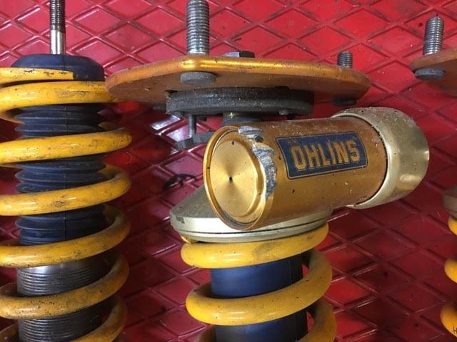

Edit: Have you seen the replacement pin for the Flags I have? Have you checked if your pins are in tact? I havent heard of anyone not breaking them, but I did get some nice scuffed up canister pics from a guy today in EU with a set and broken pins.

I saw your pins. Wish they were around 4 years ago, before i damaged my canisters 🤦🏻*♂️ Had to wait almost 6 months for them to get parts to rebuild. Rigged up a pin from a parts bin, been working so far, but of course yours looks much better 😁

Ok cool. I need to put more effort into getting the knowledge of the breaking pin and damage that can happen. I was pretty annoyed when I got my first set and found the out about the pin issue but now that's fixed they're amazing shocks.
These are from a guy Im talking with en EU for various parts.
