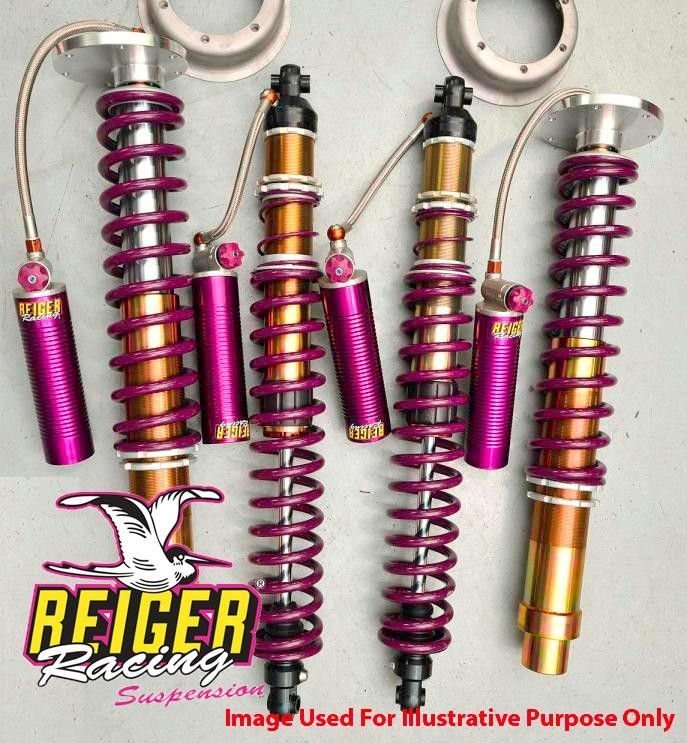

If it's actually group N suspension that's not a bad deal, BUT also really doesn't do you much good unless you're planning to build a rally car. All the group N suspension I've ever seen lifts the car a few inches and has some pretty long shock travel and very long springs. Great for racing off road, not too great for circuit use. This is what a typical group N suspension looks like:
Expect to pay $4-6k for good suspension, my Ohlins flags used to cost around $4500 when they made them, and most 2 way adjustable, external reservoir, properly valved coilovers will be a comparative price. Of course there are plenty of companies that offer a similar suspension,
Fortune Auto has their 2 and 3 way dreadnought series which start at around $4k and can get up to about $8k if you fully spec them out I believe.
KW clubsports 3 ways go for about $5k and the 2 ways are about $3800.
Moton 2 ways run about $5500.
Looks like some time attack guys are starting to run Reinharte stuff which I believe is owned by Stance suspension and they offer 3 ways as well.
AST, JRZ, and pretty much every other big suspension name out there sells something of comparable performance for a comparable price.

good grN suspension will also have extra heavy duty large dia front dampers. I have a set of Sachs 4 way Gr N dampers and fronts use 76mm ID springs..
new top quality grN dampes are 10K + per set..

Looks pretty similar to the 46mm shock shafts used in my flags. I'm guessing they are similar to the 3 way clubsports just with heavier duty front shocks. You should inquire about their valving and spring rates. If the valving isn't proper for your car you're looking at another grand or so to get them revalved. But if it's all proper then that's not a bad deal.

KW is Nurburgring company, they do everything for the ring, and this 3-way was developed as Rally setup that is easy to convert to track setup.
Here are the issues, that I see:
$5K is near new price, maybe new 3-way is $5500 now in Germany, or could be negotiated for that money.
The setup you will get has A) old valving which is ok but far from present day B) has modest support in USA (If you were in Germany, awesome)
Finally, you can buy NEW Reiger 3-way starting at Euro 7,000, and so many more setups including Ohlins TTX40 (Gr N) and TTX44 (Track) for starting maybe $7500, and have the latest and greatest built into them.
Probably the Exe-Tc can also be had in 3-way or 4-way for about $7500-8000, starting. New.
Big difference buying new, custom tailored for you and with latest and greatest setup, than used, valved 10 years ago for somebody else for something else.
Furthermore, the Ohlins R&T are really good for the money.
So I find the temptation very small for the KW...the price would have to be better.

AST 5300 vs Sachs 4 way gr N.... 46 vs 58 mm damper and some 30 mm more travel and more serious (I am guessing at least 30 mm) bump stop travel... if you ever wondered how can they jump... WRC stuf is AT LEAST 250 mm longer still..
