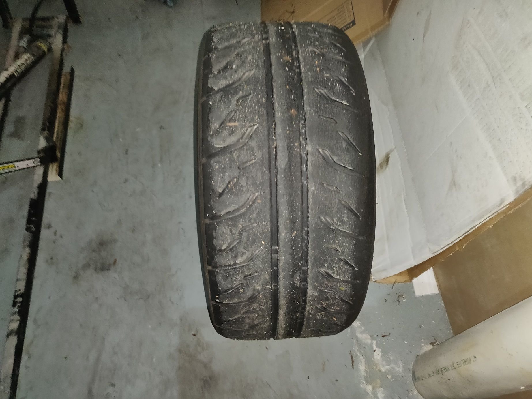

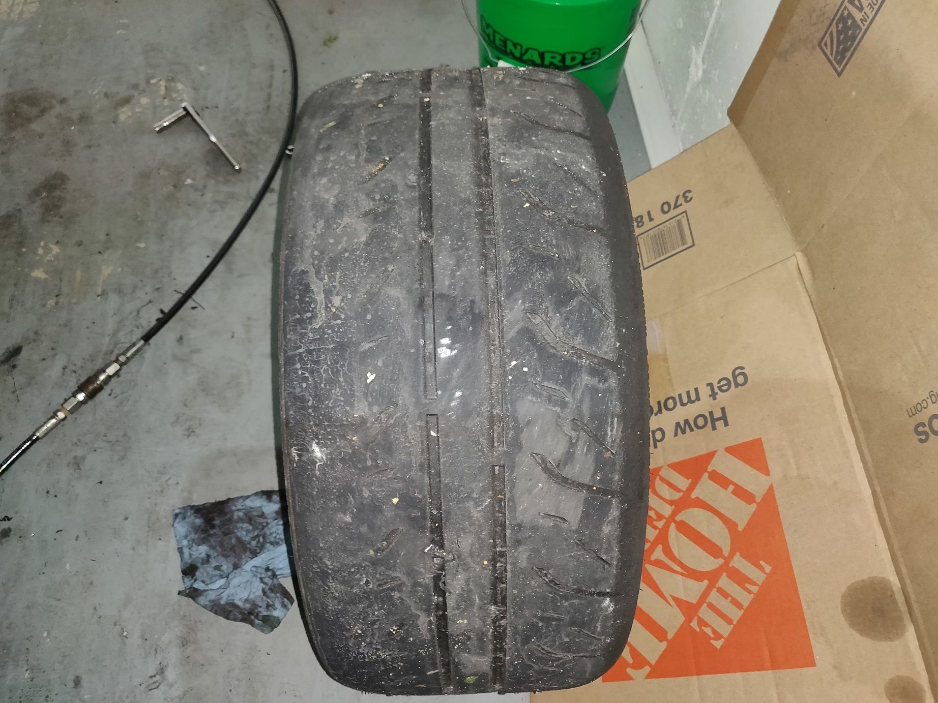

Originally Posted by ayoustin
Measure the angle your tie rod and lower control arm are at. If they're equal then you shouldn't have much of any bump steer.
When was the last time you had an alignment?
i dont have any bumpsteer but i do have toe for sure. Alignment was in March. Took off the tires last night. The rear tires actually look decent, maybe a few events left out of them. The front driver's side is worn on the outside and the front passenger's side is worn out on the inside (aka both left). Car drives straight but clearly something messed up
do our cars toe out Under heavy braking by chance?
If you had toe out (or in) under heavy braking, you would have bump steer to some degree, they both cause suspension compression. Hence why I said to check the angle on your tie rod and LCA.
If you're just seeing tire wear that looks like it's from excessive toe then it's time to get that alignment checked. Something might have loosened up on you. Also what tires are you on and how many days are on them?
I think checking the alignment is a good starting point. Driver front, pass front, driver rear and pass rear in that order in pics below. 4 track days, a couple of them were 2 day events, and maybe 3-4 autocrosses on these.
I'm also switching my rear pads to ST43s (had Girodisc S/S) to match the front ST43s and that may gain some improvement in braking stability as well. I've never been on as high speed of a track as Road America so I think little things that were okay in terms of spec get amplified out there. will be better prepped next time for sure.

Fronts don't look terrible. Passenger rear seems decent, kind of hard to tell if there's toe wear on the driver rear.
Either way, you've gotten a lot out of those 71rs. They're short life tires. Competitive TA guys only get 1-2 weekends out of a set (meaning like 15-20 laps MAYBE) and HPDE guys usually get 5-6 days out of a set. Obviously track and car setup amongst other variables affect that but that's the middle of the bell curve.

Originally Posted by Dallas J
Im not sure why its even a discussion of whats wrong before getting an alignment :P
On a related note, when my front diff last year was broken (all plates in the clutch inner tabs were sheared off and housing was cracked) I was having a lot of inside tire wear from it spinning inside front wheel.
just in case anyone really feels a part should be replaced - ie you mentioned tie rods, but if it's just the tie rod ends it should be fine right?
i guess.. the fronts looked like the rears before 4 sessions at road america. just odd that both front left sides wore out, but just an alignment tweak should do it.
