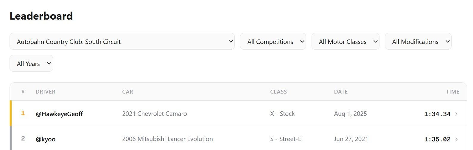

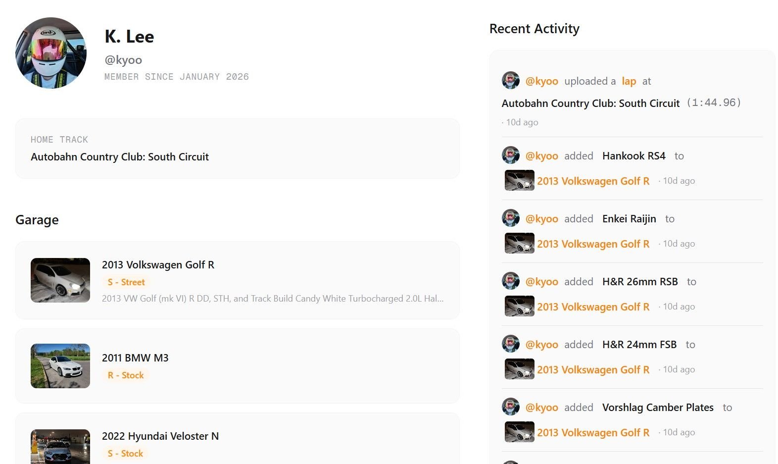

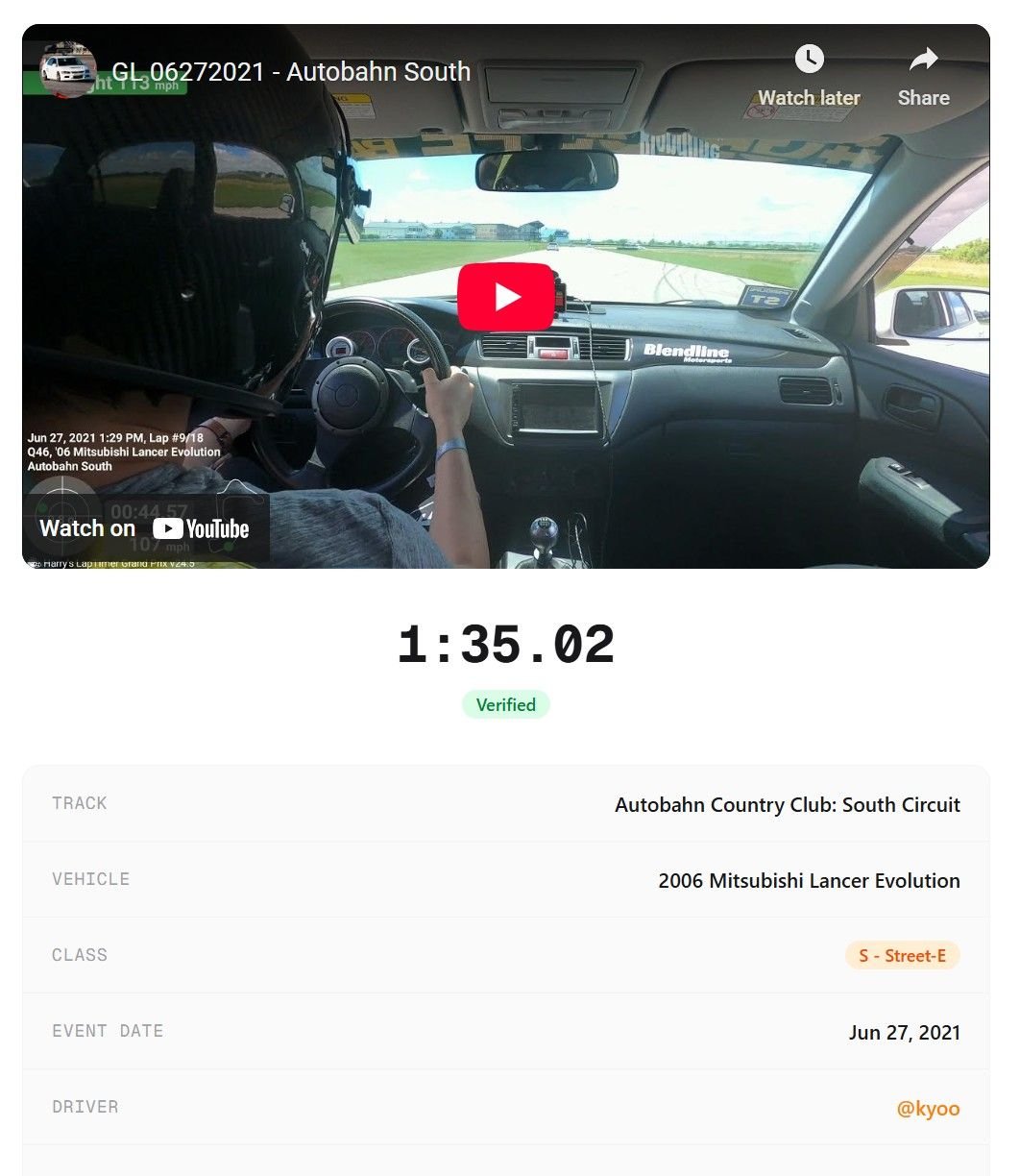

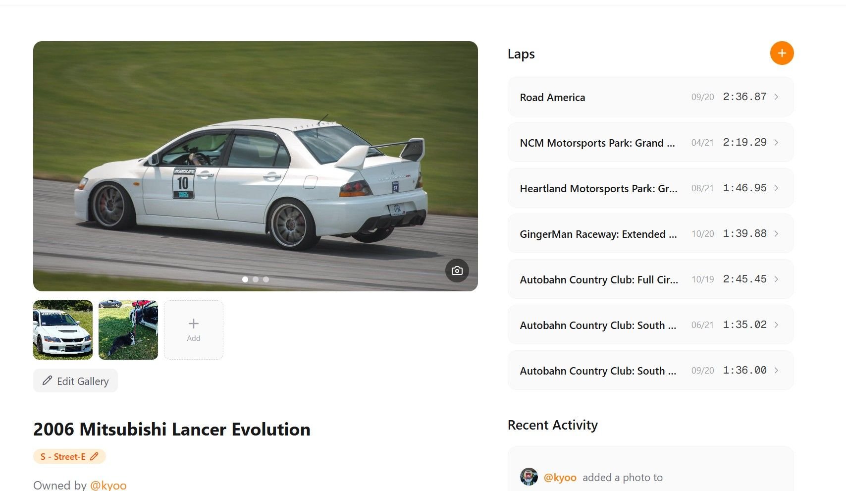

re: my online time attack project - we're launching now! invite-only still for the time being, please DM me if you're interested. Would be great to see more evos posting up laps as we get started here! https://qualytimeattack.com/
https://qualytimeattack.com/profile/...7FKRcVccM1krH3 is my profile. Here are some screenshots of what the site looks like.
