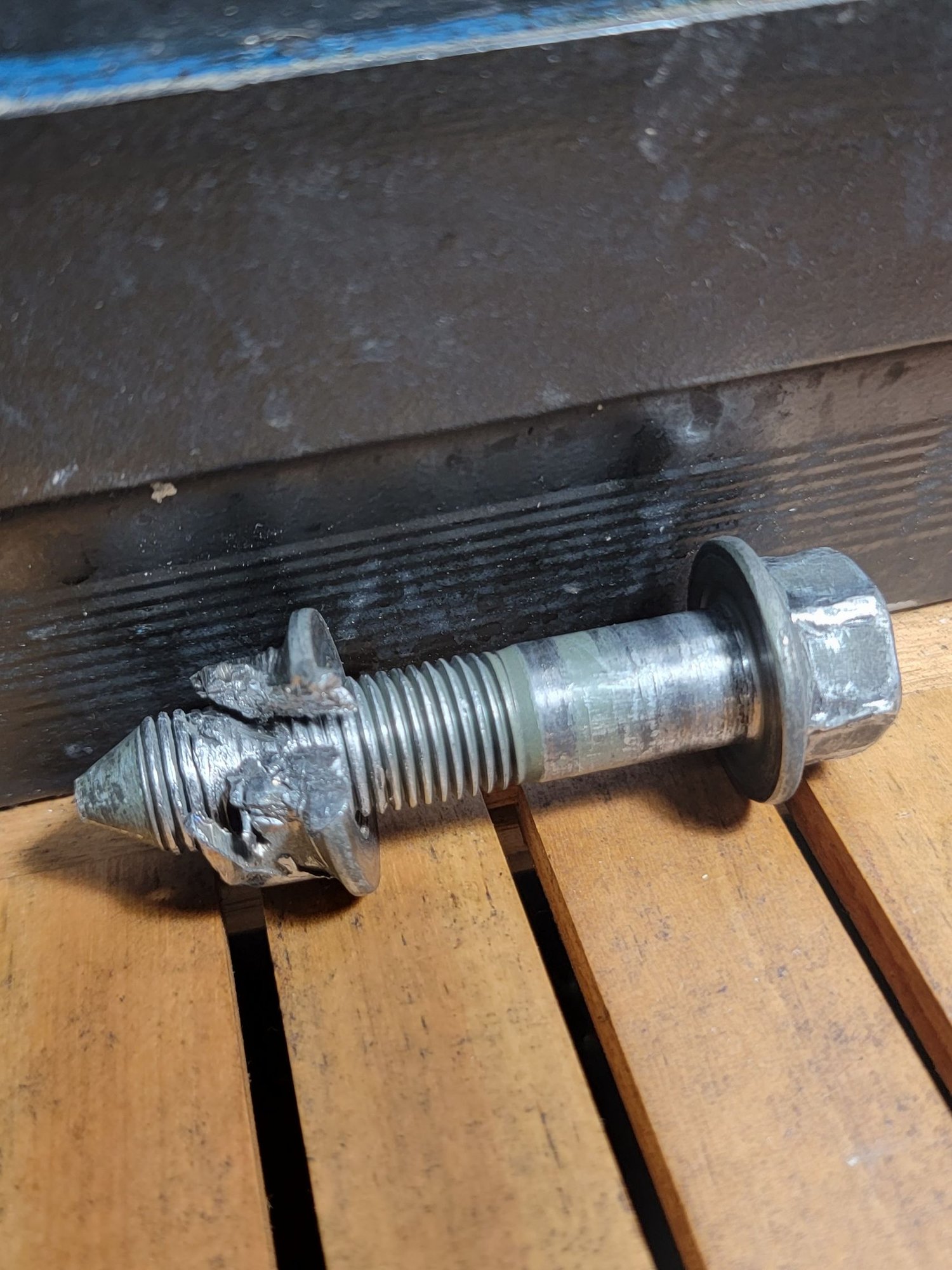

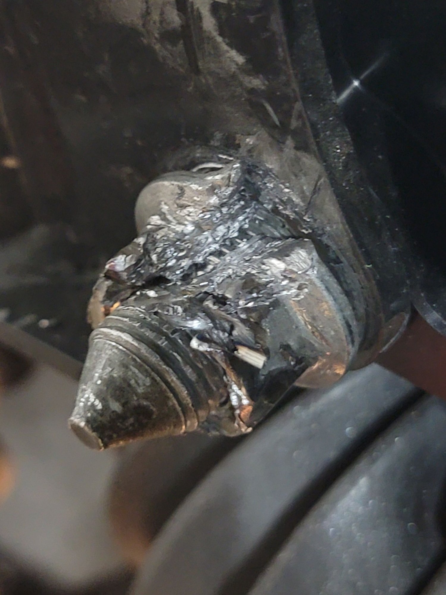

Bolt seized inside the control arm bushing and it ripped it, so it spins with the insert inside of it

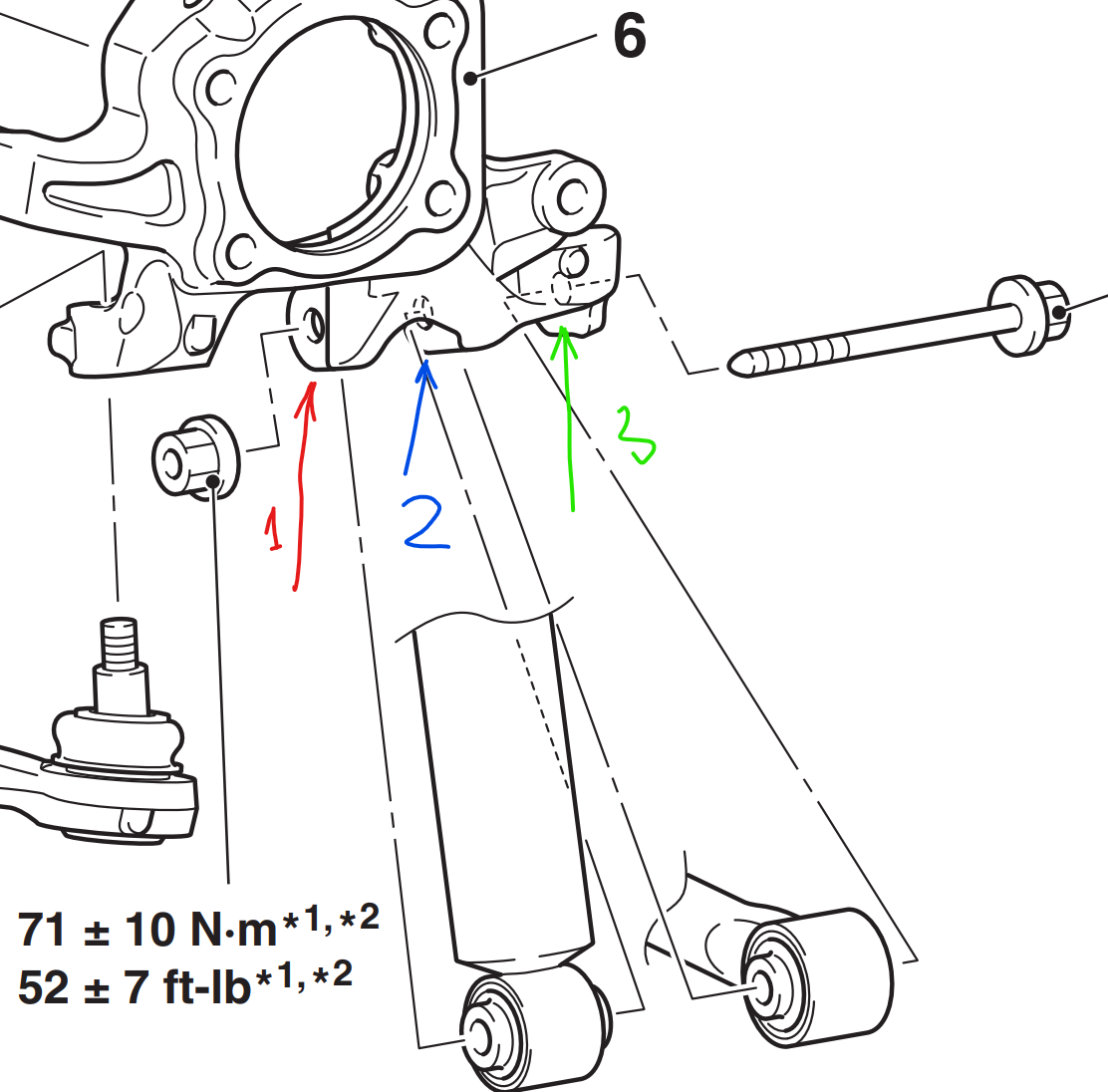

Here is a better view of the section:
There are 3 holes that bolt is going through. Red one is on the side of the shock where nut is and that can be cut on both sides. Problem is between the holes 2 and 3 where the arm bushing is. You could probably cut the bolt close to the hole on nut side and remove the top of the bolt on the right side. It would still not fall down since bolt will be in both holes. Some hydraulic press would perhaps be able to push it out, but once you cut the head of the bolt, there is nothing much to press it on that side. Pressing on the shock side would be even harder, since there is more material where the hole 1 is that is in the way. In other word, it sucks!

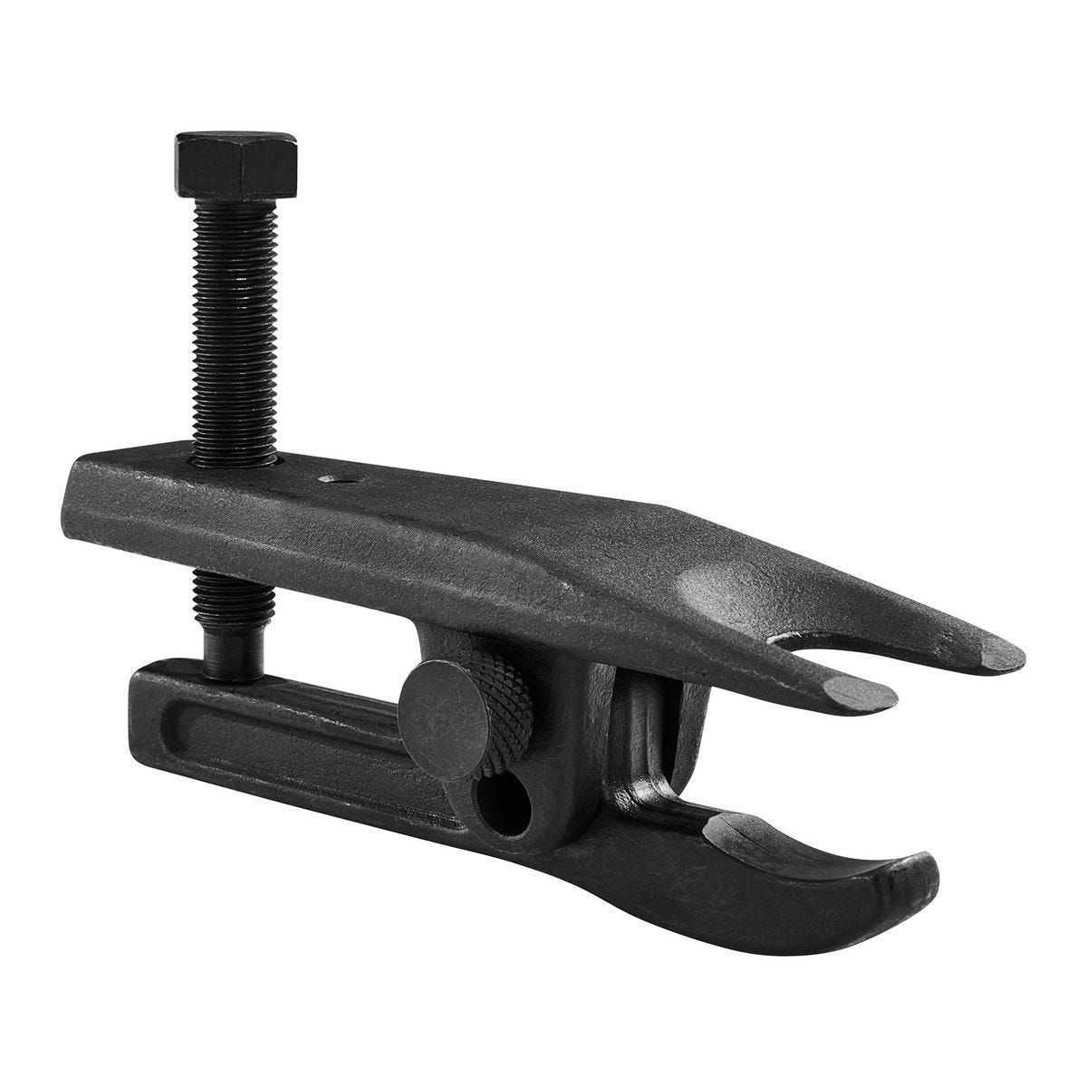

@MrAWD have you tried using a ball joint separator on that threaded side of the bolt? I just cut my HF ball joint separator to widen the "fork" when I was helping a neighbor. they were 3 generations of guys hammering out a ball joint thats never been serviced since 2012. it was no match for the HF tool
Looks cool, but I think I would need something that goes in the opposite direction. Either way, I am just done with it at this point! Thanks for help!

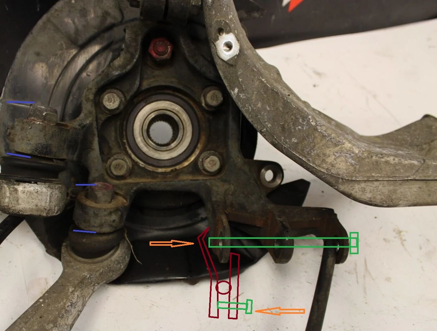

is this the way you guys were imagining it and that it wont fit? normally you'd leave the nut loosened to the max so the tool doesnt damage the threads. you only need to move that bolt a few mm to break the rust between the bolt and the bushing(might give you an opening to spray wd40 under the bolt head). the "fork" opening need to be wide enough to get passed the bushing so the tool is straight and do its job properly. the tool might be too big so a taller nut side might help (blue is where its normally used)
Looking at the picture, that could have worked...I am passed that point right now...just want to be done with everything
