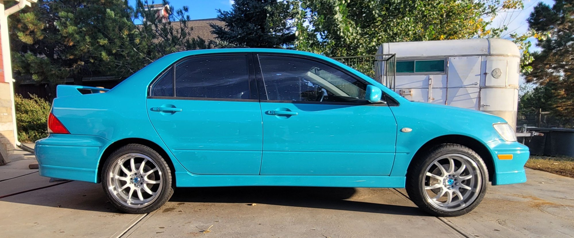

finally starting to make some progress on my upgrades. Did the 5-lug swap and got rear discs on my OZ last month. Still collecting parts for my 4g64 swap.
