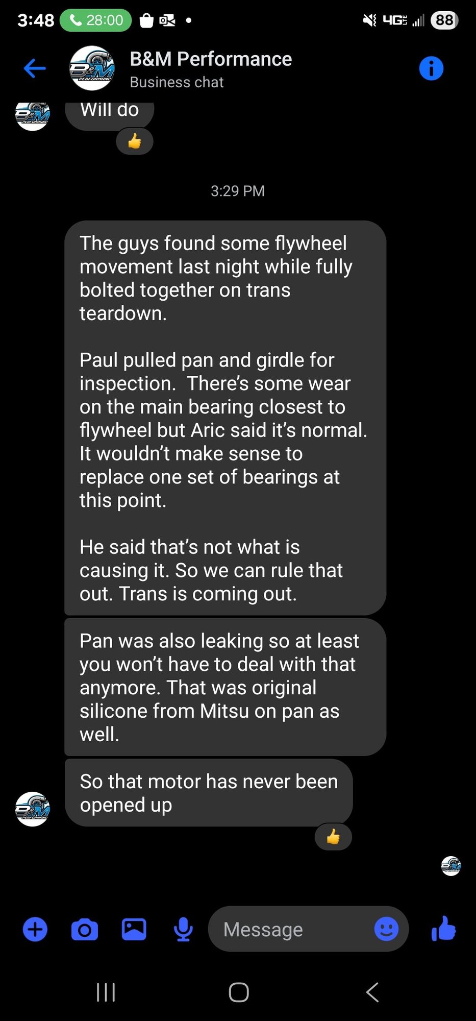

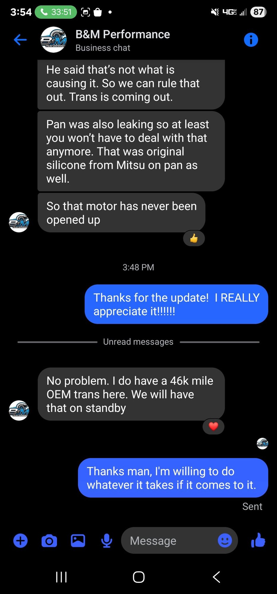

Here's what they have found so far. Keep in mind the event before this issue got really bad, we push started the car like 14 times that day due to my starter failure. Coincidence?
Possible bent input shaft?

is it possible? yes my life's filled with 'bad luck come in threes' scenarios. one BS thing leading to another BS thing lol
