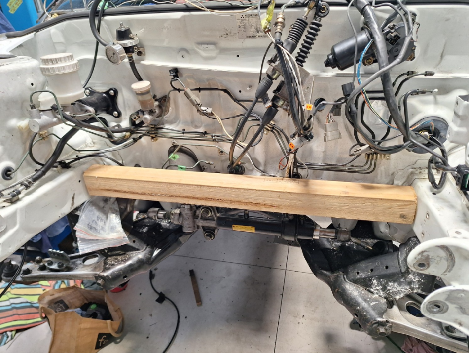

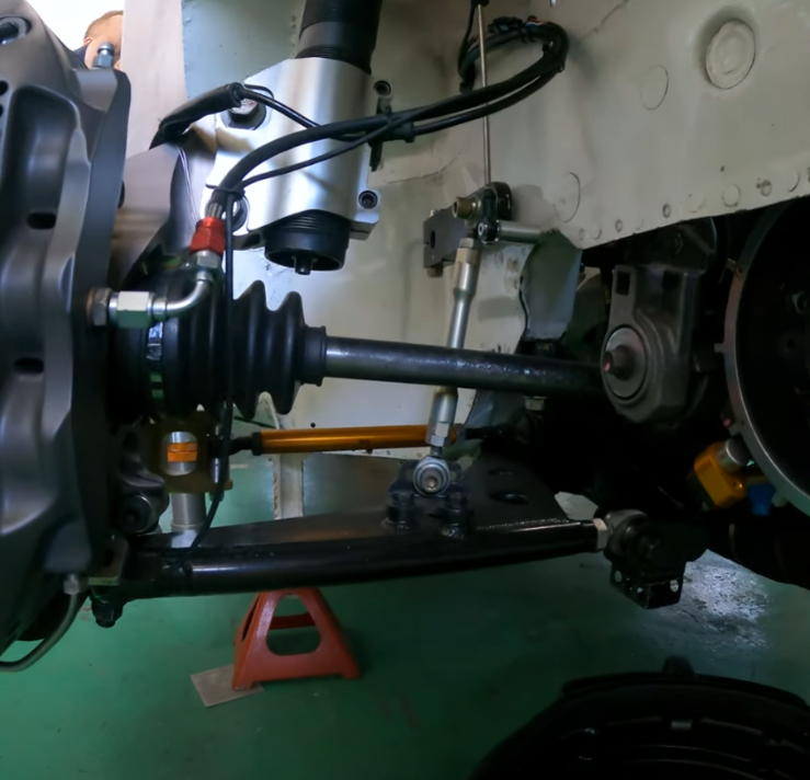

New project for the Evo, front sway bar!
Going to a thru-bar setup for a much heavier rate bar to give it a go.
I've found that going heavy on the front spring has helped a lot, so i'm guessing it's a symptom of the bar rate being too low.
With the Evo 4-6 CP9A chassis the transfer case goes under the rack and the subframe, so there is space here to do this.
It's very tight, but I should be able to make it work.
I'll be using a 1" solid chromoly bar inside a 1 3/4" tube welded into the chassis.
I'm tying the rollcage through to the front strut towers also, i've found some of the sheetmetal has cracks from stress. This should help stiffen up the front a lot also.

I dont like front bar over spring because it works in effect by unloading the inside wheel. Which IMO is the opposite of what you want on the front of an Evo. It works in the rear because the unloading of one inside wheel is matched with the loading of the other because total weight transfer is fixed and bars just move the ratios around.
One thing I wonder about, do we have chassis stiffness numbers comparing CT9A and CP9A? A flexier chassis will reduced the effective cross transfer forces making small bar changes less effective. DSMs were pretty bad for this, especially with a sunroof. The chassis is so flexy you almost cant lift a rear tire and nothing compared to how much Evos do.

yeah the setup i'm going to use, I can either use a 1" solid chromoly torsion bar or a 0.77" solid chromoly torsion bar.
Rates will go from 1800 lb/in right down to 280 lb/in depending on the length of the arm.
So I can go from standard rates up to 600% stiffer
Very interested to see how it goes

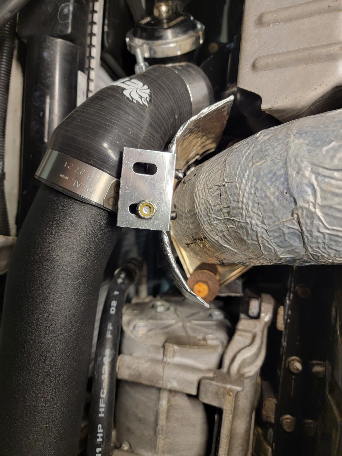

LICP silicone coupler (non FMIC side) burst at the track yesterday - the pop was so loud I was sure I popped the turbo. First time this has happened, almost split itself in half, while the clamps still held. Bummed because it was my second session on track and it's been a while.
what brand? you got to really check on those parts especially when you get "techs" work on your car. man, now i'm going to worry about mine going. i put a heatshield on this one i hope it helps

maperformance. I've had it since 2019 (installed myself). just a random failure. haven't gotten under the car yet.

That's a common issue, nothing to do with whoever worked on it last. Too much ambient heat that close to the downpipe for silicone, it eventually weakens and splits on tracked cars. Before switching to vanjen clamps I was carrying multiple spares with me to the track.

idk what a vanjen clamp is but the clamps held on, it just burst in the middle. gonna call map today to order 2.
umm It has not happened to me or any of the evos with me on the track. theres also a lot of airflow under the IC even if the splash shield is installed. if you have a splitter maybe it'll make it too hot in there. if you were using worm clamps before yeah maybe thats more to be the problem
IIRC kyoo also had 71HTA installed recently
