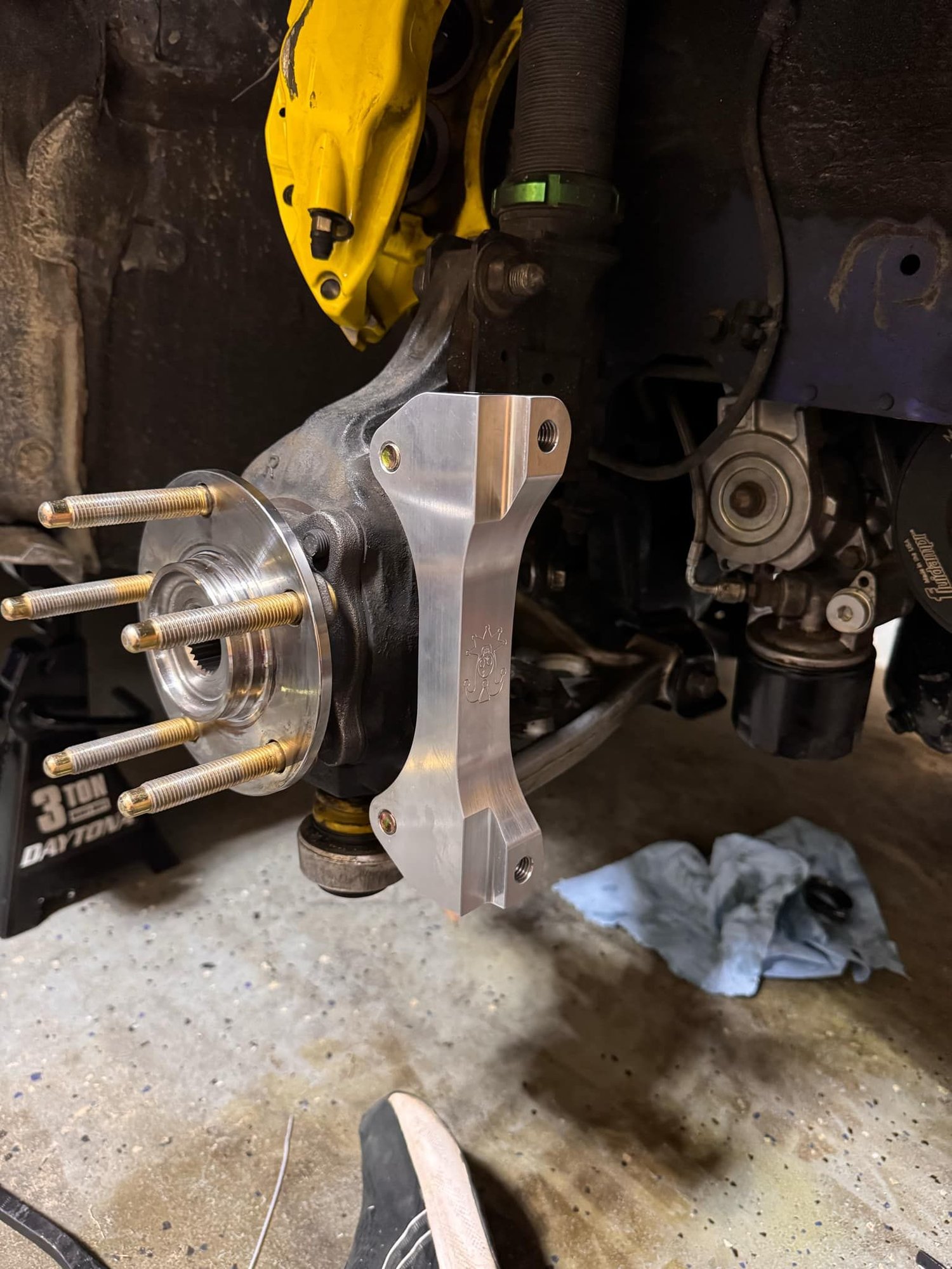

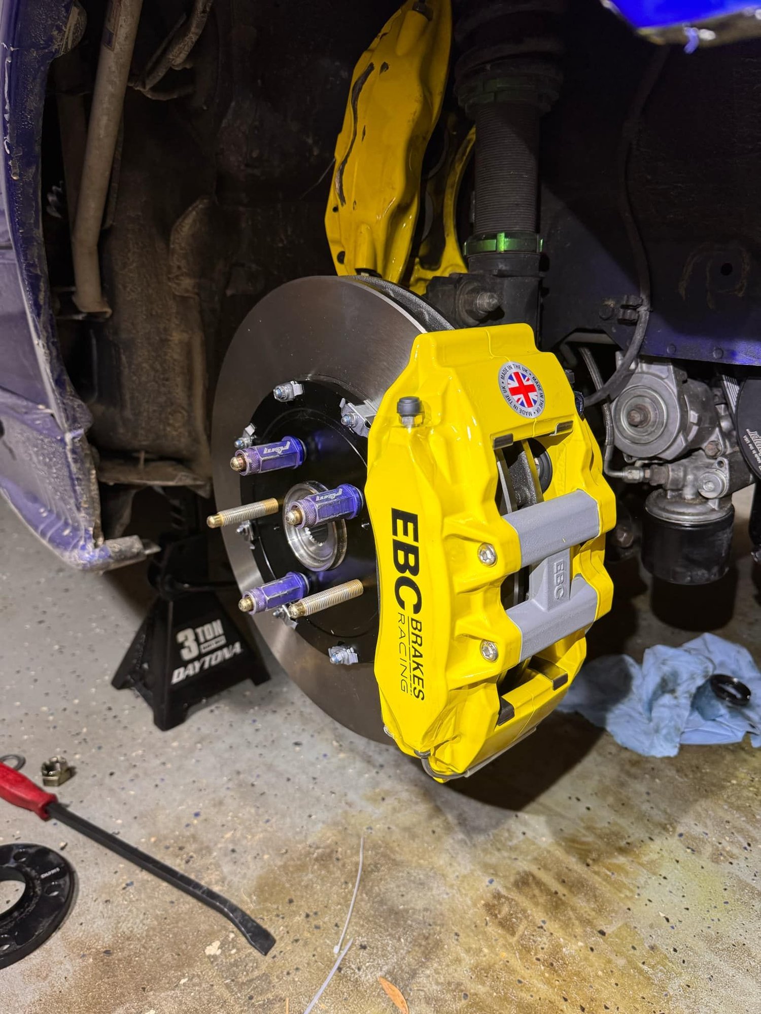

Did someone say they're looking for a big brake kit that doesn't kill your wallet? 6 pot caliper, super common pad shape (tons of compounds available), uses Evo X rotor so replacement rotors are easy and cost controllable. Calipers can be configured with different colors of paint, dust boots and aluminum pistons for street use or hard anodized finish with no dust boots and stainless steel pistons for track use.
Hoping to have it on the market by end of Q2 this year.

Would this work for X as well?

Good question. I have no idea haha.

i think it should. the X calipers just have longer 'legs' and bigger bolt holes

Match the bolt spacing for Evo X and then use steel inserts for 7/8/9. Same thing that Dallas did on the hubs he makes.

Not everyone has a version like that, but all the ones going forward are machined 14mm with a 1mm steel sleeve pressed in for 8/9 use. Also found I could put both the 8/9 and X ABS sensor mounts making basically a universal upright. Also means I can convert 8/9 to X but not the other way around.
