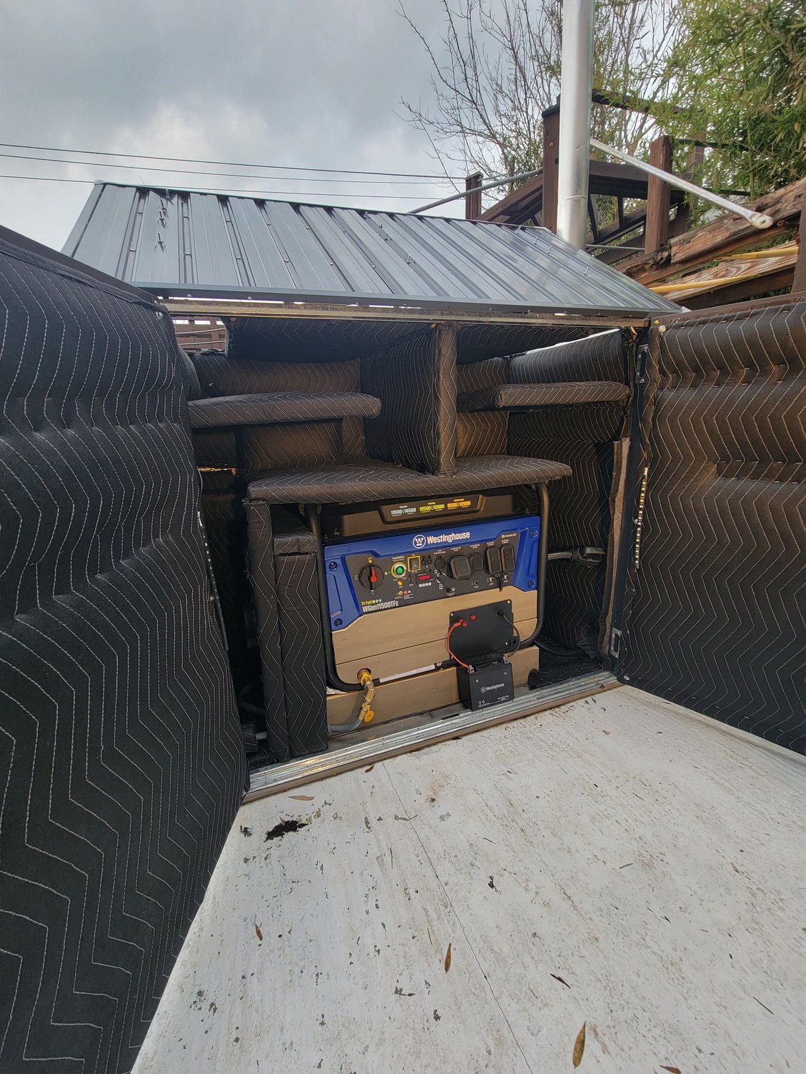

Well I can say a NEW YORK freeze is worse and that sucker starts right up. I did have to locate/buy a 3/4" flex line to go from the hardline coming out of the ground to the generator because a diameter restriction would be devastating at the distance I was from my home feed line. I can post some pics here if you like of my setup. It started at 2F out, and ran for three days straight without issue a year or so ago. I put it far enough away from the house with a vinyl fence wall (to block it and the pool equipment) that you can barely hear it. The first year our house was built we lost power SIX TIMES, and that is what made me take on the project. That was 10 years ago, and it still works great.
Highly recommend Predator generators with a natural gas conversion.
My new motor is coming out soon i think so im done working this, Project Looney Bin. Wanna do a sound comparison?

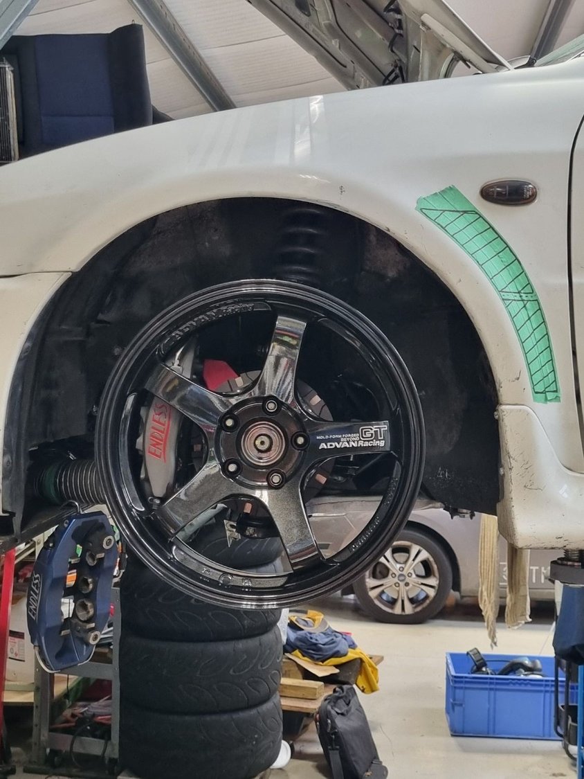

Doing a brake upgrade at the moment on the Evo, i'm now outdriving what's currently on the car.
Being full weight (1420kg with driver and fuel - 3124lbs) doesn't help either!
Going from a 7.1kg disc to a 9.1kg disc, Girodisc custom made me a 350x35mm rotor with large 64mm annulus.
Using a set of Endless RacingMONO6 calipers that I had on the shelf using RD62mm pads and 25mm thickness.
Should make a big difference with the extra weight to better control the temps.
And they will fit under my 17" rims. Advan RG4, Advan TC4, Advan GT. WedsSport TC105X. They all **just** fit!
Running 20mm spacer helps move the caliper to the tapered part of the barrel for more clearance.

Thats pretty slick how you left a large hole on the mounting bracket for brake cooling!
