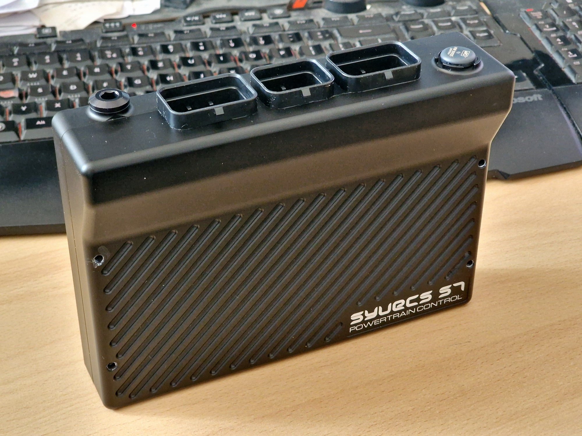

speaking of projects.... this came the other day.. Secret wish is to manage to control both ACD and AYC with it... Syvecs has a diff control unit that might do that job, but the dealer I got this from insisted all the diffs can be done with just the s7+... Looking into control strategies... documentation is a bit lacking to say the least..

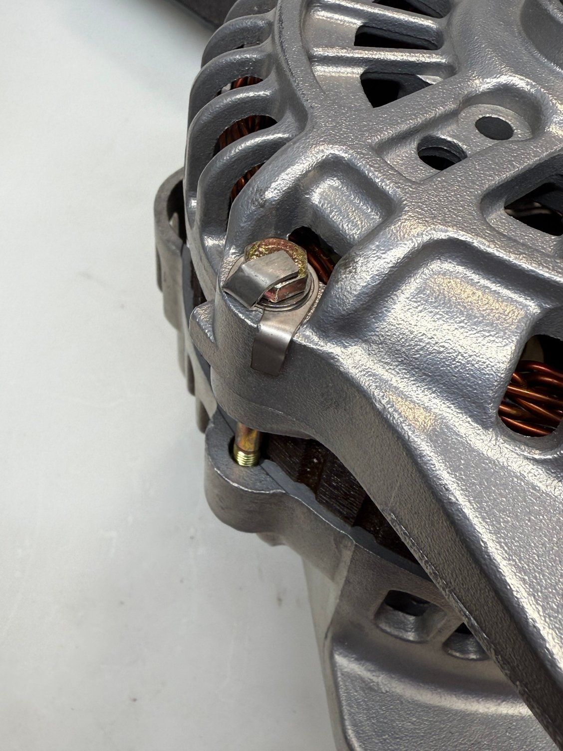

The past few years I've seen more people talk about alternator case bolts backing out. They're long M5 bolts and access around them is a bit tight but I came up with this locking tab washer to hold them in place. There's two tabs, one gets folded over the bolt head after it's torqued and the other gets folded over the alternator body. This keeps everything from being able to spin or back out. I'll likely get this added to the site for anyone interested, will be sold as a kit including new bolts and washers as well as the tab fold washers.

why this over a nordlock?

Thanks. I've seen others try friction based lock washers and still have the bolts back out.
