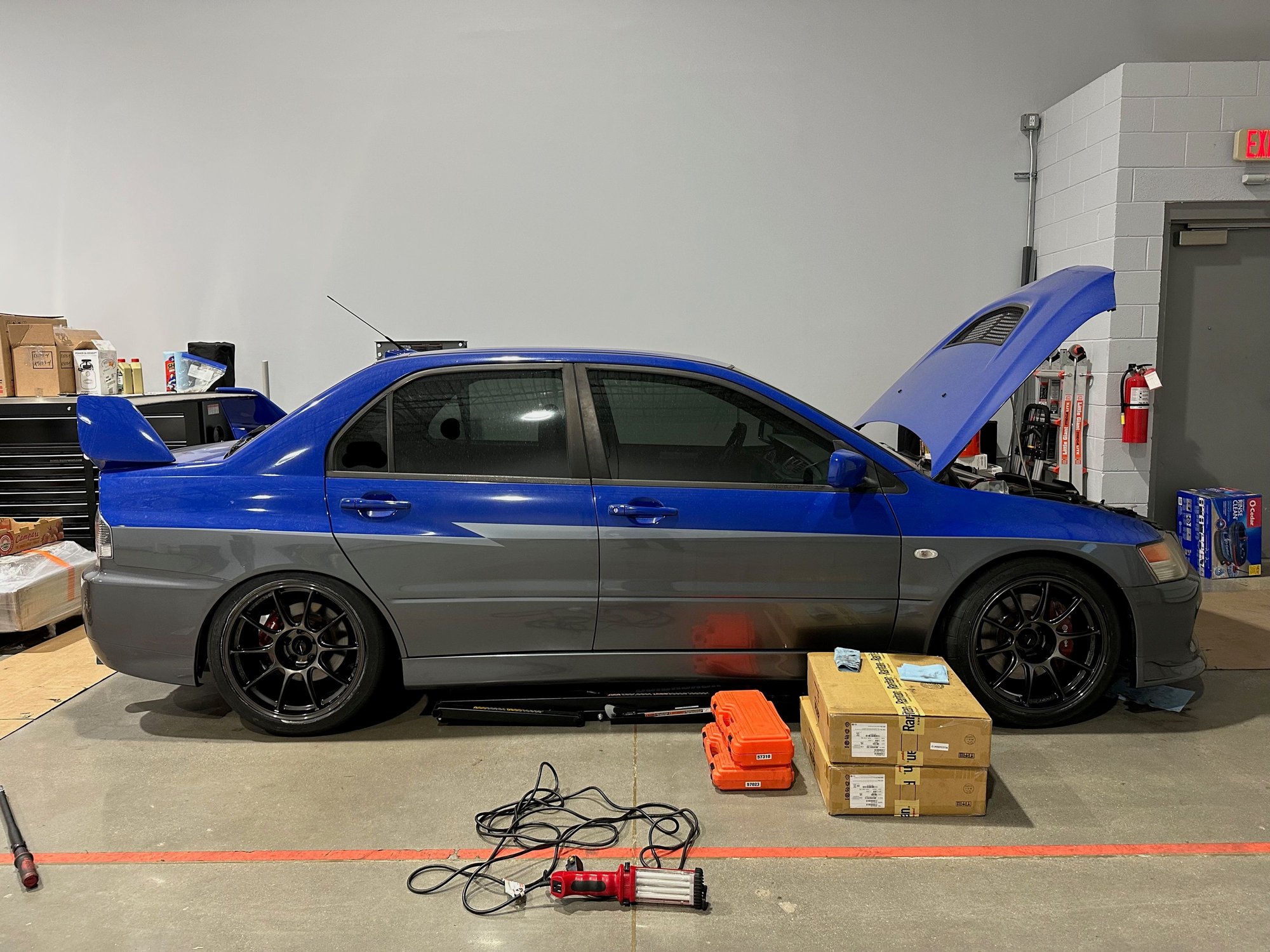

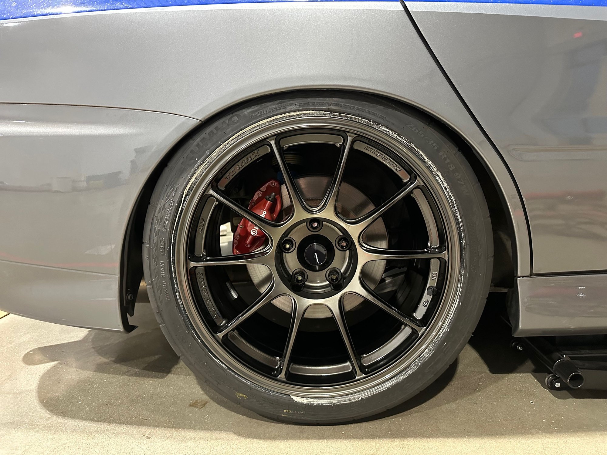

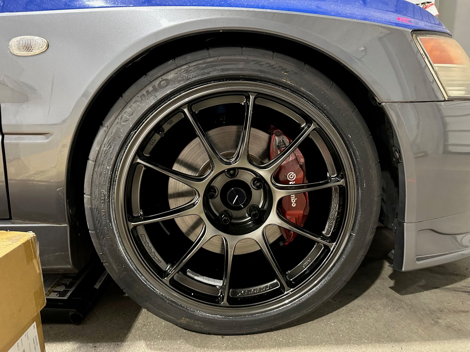

Coincidentally I installed SSB rear knuckles today and now the rear wheels are so low the tires are tucking into the wheel wells. I adjusted my rear coilovers the exact same way I adjusted my fronts and this is how my car came out:
How the car currently sits
Front wheel
Front wheel
Rear wheel
Rear wheel
I took these photos right as I was packing up and leaving so I haven't measured anything yet. I'm worried that preloading the rear spring significantly more than the front and/or adjusting the bump stop in order to increase the rear ride height will make the rear of the car behave funny.
Front wheel
Front wheel
Rear wheel
Rear wheel
ok im glad i'm not the only one who has experienced this - thought I installed something wrong.
I emailed ohlins, hoping they have a longer bottom cup, maybe 30mm. There are aftermarket lowering cups from "Urge" for s2000s using ohlins, but I don't see raising ones.

yeah, it's not long enough and @rustykan 's looks exactly like mine, though I have flipped the control arms which helped a little, but I'm already at the most I can add height to at the bottom. it's just too tucked in right now. you saw his pics in the above post right?
