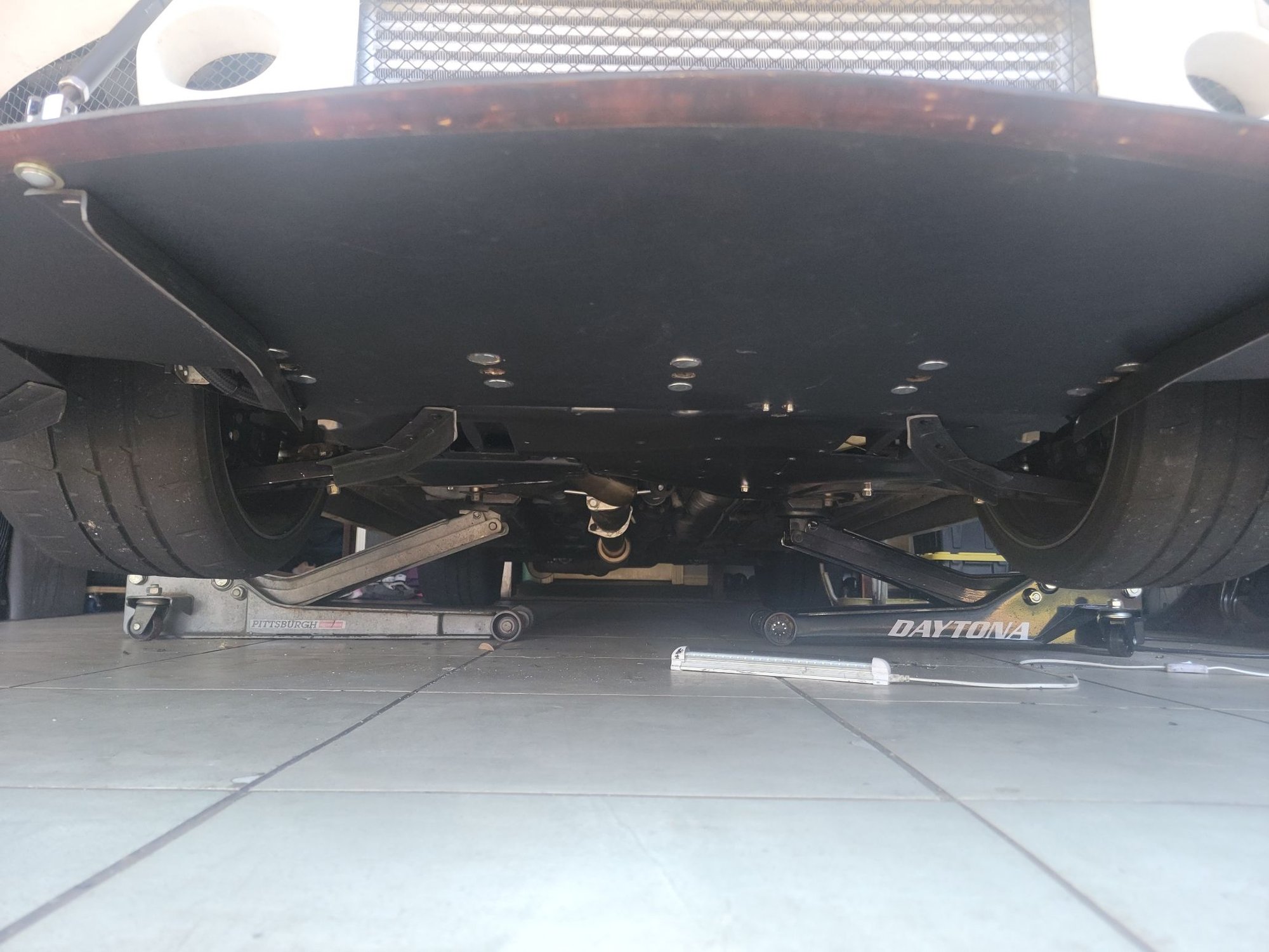

retrofitted an engine splash shield from a prius. for extra fuel efficiency and cleanliness of the TC and transmission. has an access panel for the oil pan
i'm still working on the front part

wrapping this up. I installed the front part of the splash shield from a prius... i went for the cheapest one so it has a 'made in taiwan' embossed and its very flimsy I'll replace that. anyway, it should be good enough for those long 'break-in' drives. dont mind the studs, those are for my experimental splitter

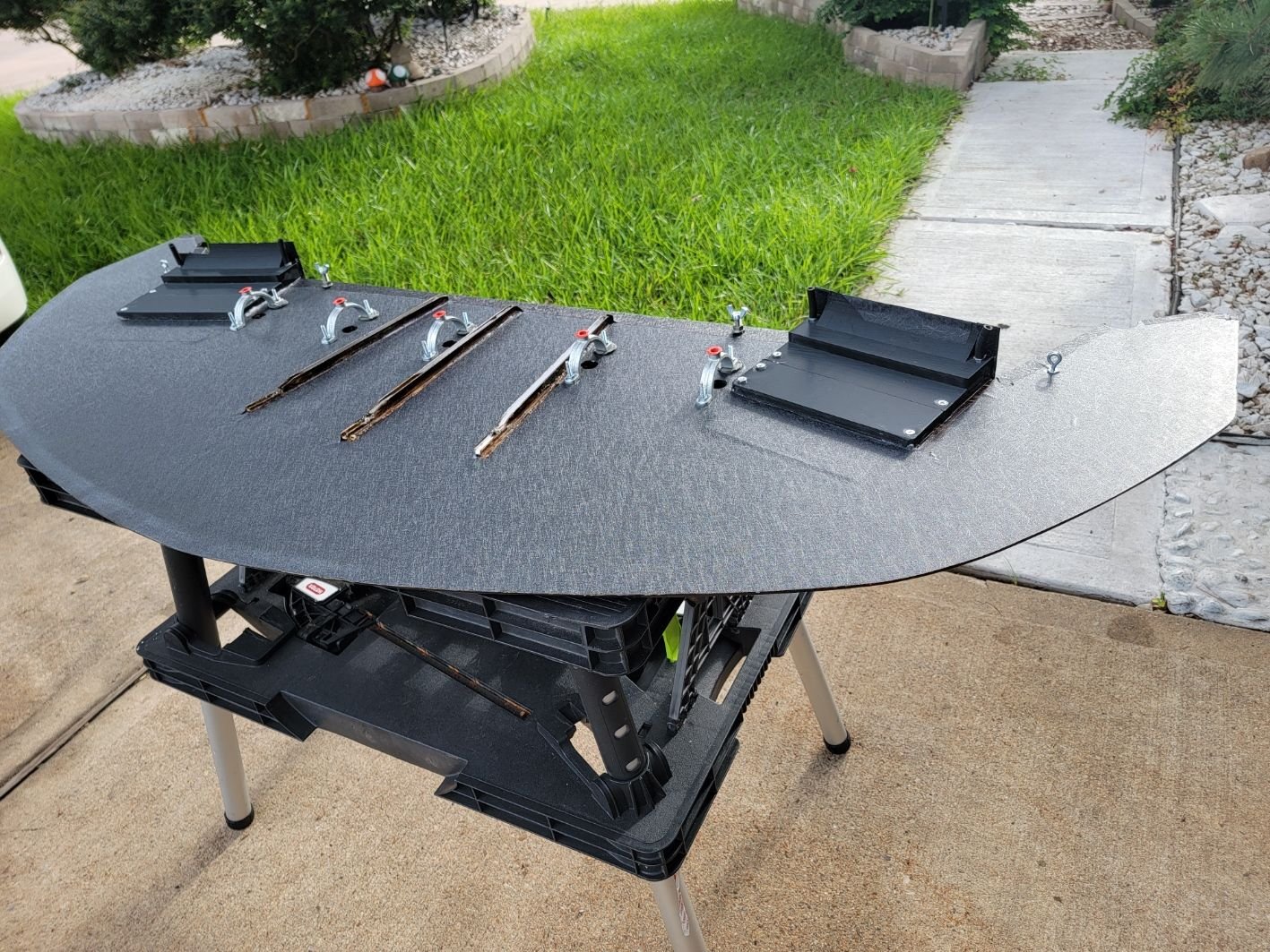

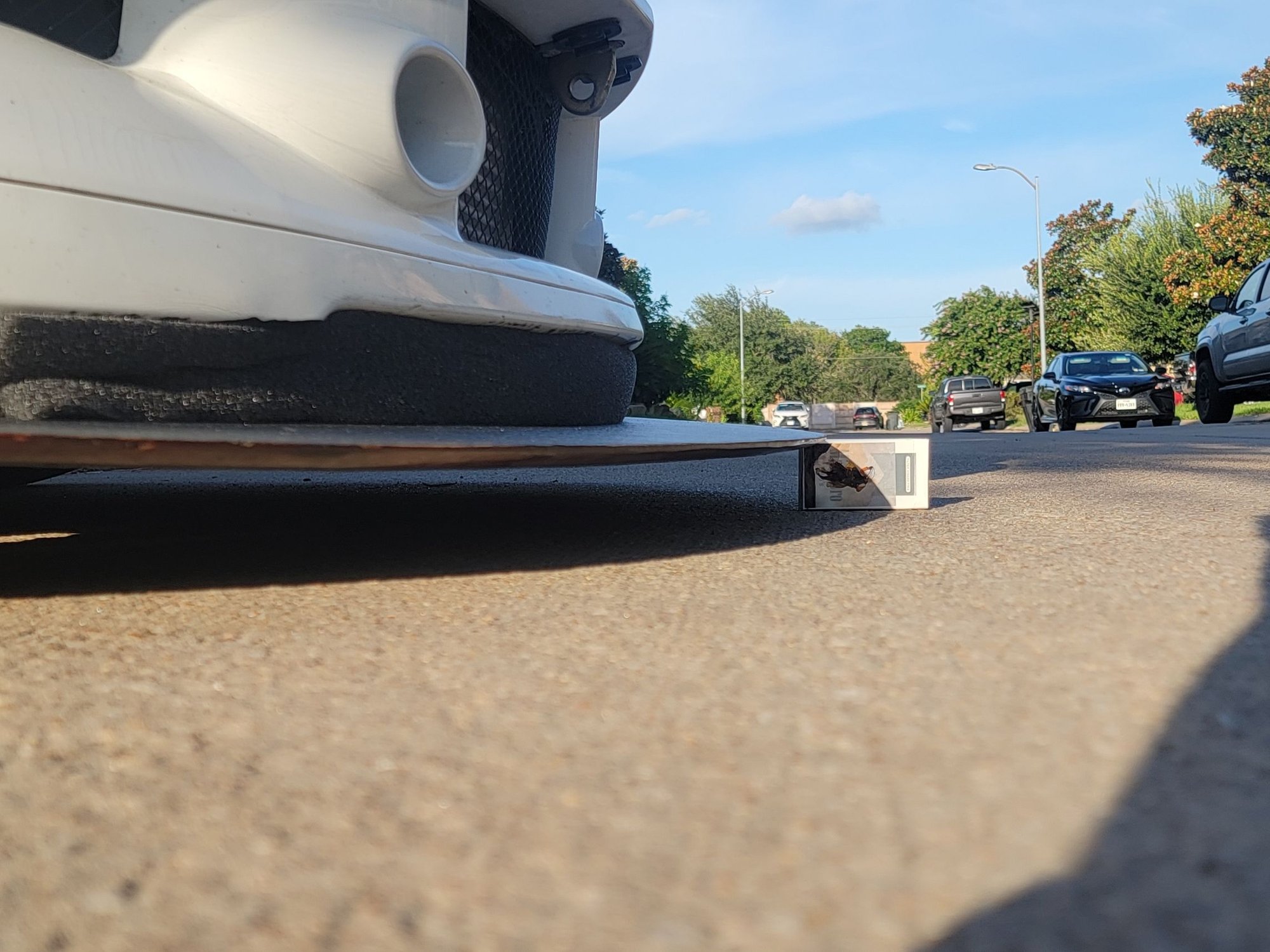

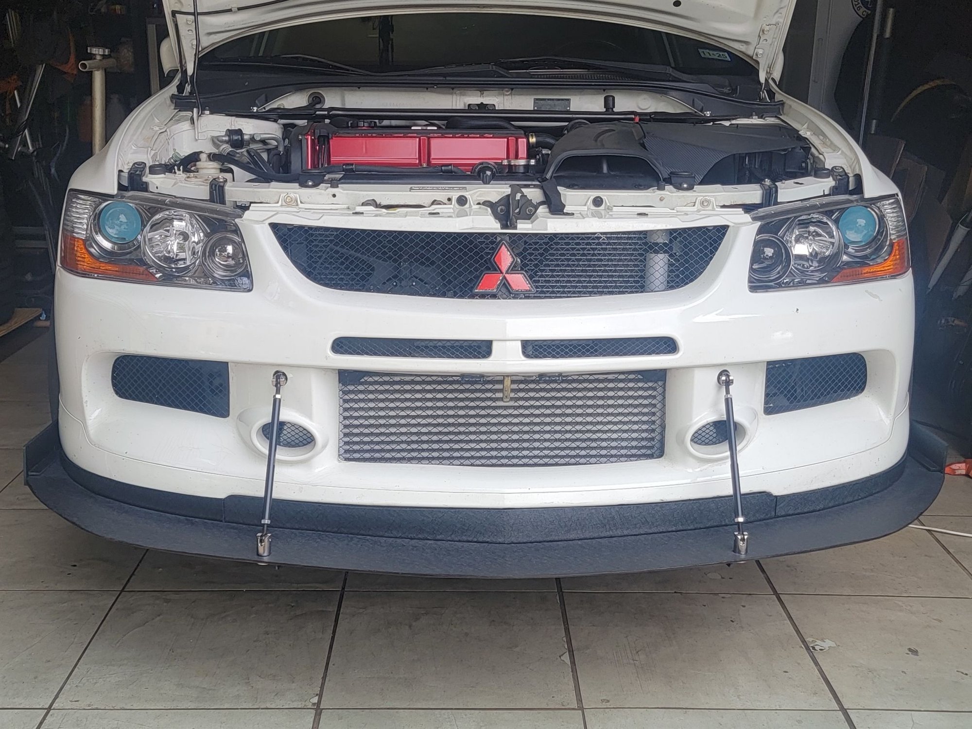

My prototype plywood splitter is ready for testing. I got into this after I learned that Racebred splitters are also plywood. I have wood working tools I havent used in a decade so I thought to give it a go. I used 1/2" BCX plywood for this version 1. I'll use birch next time. it weighed about 13lbs before sealant/wrap/airdam/foam/rods.

are vortex generators and diffuser ramps allowed on splitters in XA?
Old Jul 30, 2025 | 07:56 AM
  #6763
ViciousLSD's Avatar
Joined: Oct 2011
Posts: 3,858
Likes: 600
From: Houston
hmm in XA i believe its a gray-Yes. I've seen CAMS installed them about 2 years ago. There's wording on the rules that if you can buy aero for a specific car then its legal. The question was also asked in the XA FB group and JG Pasterjak(XA rules guy) said its legal, since even stock cars have front diffuser now. SEB responded to that question and said its covered under "Exterior body panels maybe removed or modified"
If you use birch, make sure you call your local lumber yards before going to the big box stores. Also try to get "baltic birch" which has fewer voids and a higher number of thinner plies.
The cheapest baltic birch at my local lumber yard is both nicer and cheaper than anything you'd find at Home Depot.
Next time I talk to my local plastics supplier I'll ask if they have any reasonably priced composite sheets that would work. Seems like in 2025 we should have some options for decently priced composite materials.
Thanks. I've been thinking about this and I think i need to do a bit more research & weighing pros&cons. regular exterior plywood is stiff enough but you can also add some kind of ribs. birch plywood looks really nice and is a 'harder wood' BUT i wonder if only the veneer is birch, and its still wood looking for a car part. Marine grade plywood is the most recommended because of the waterproof glue used( i dont know where to get it), so I decided to seal, apply waterproof glue & wrap the plywood, I applied glue/sealant on the cuts/holes too, so I think i got the waterproofing covered. I think there is a higher probability that impacts/scrapes would damage the splitter sooner than water/weather. anyway, i dont know, I have to see what it does in autox and see if its worth all the trouble. I drive my car to local events too
