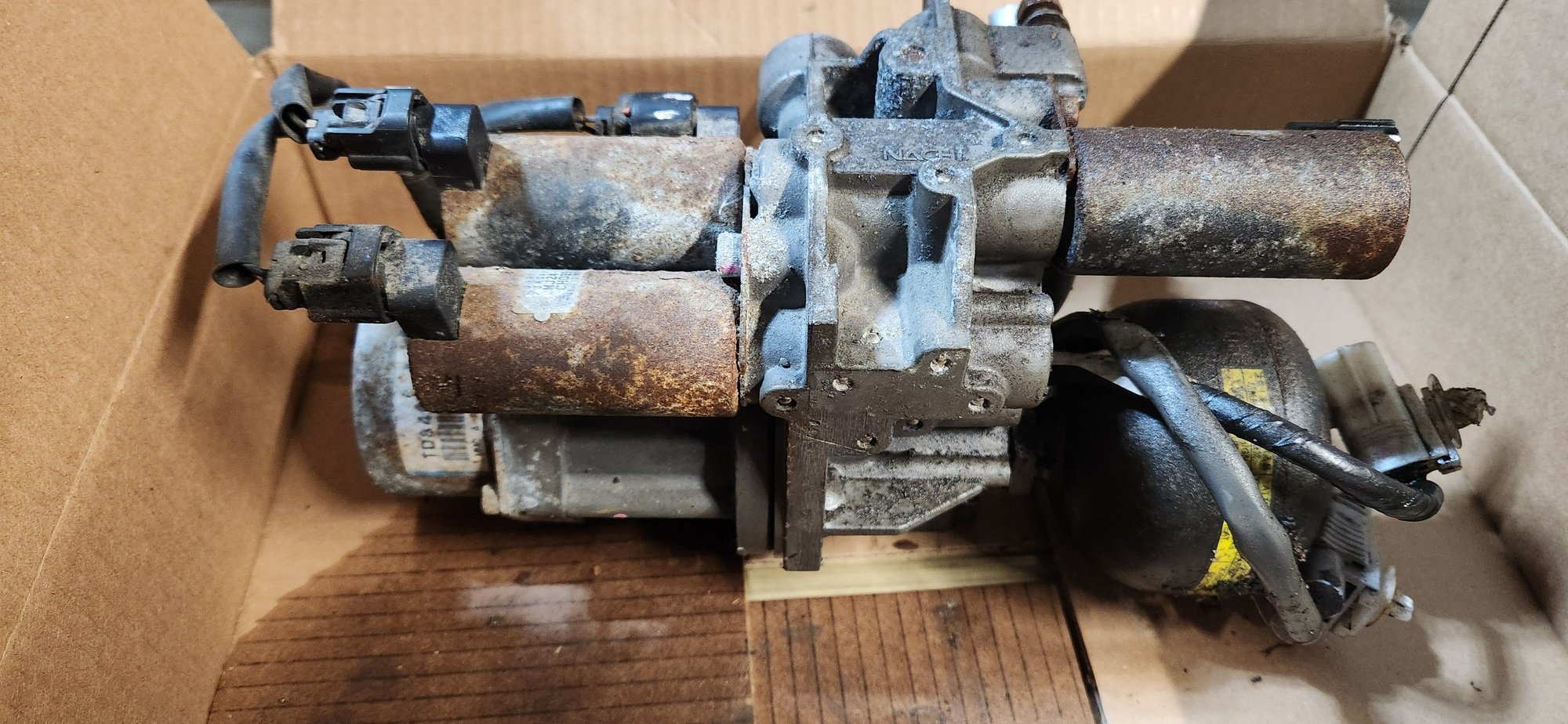

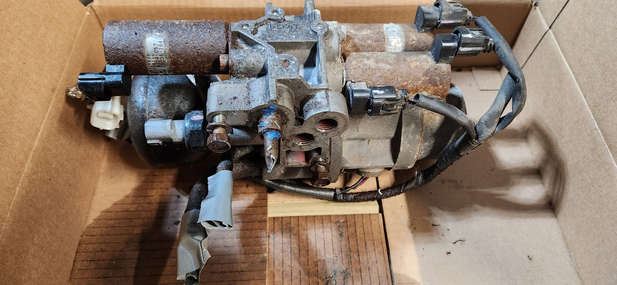

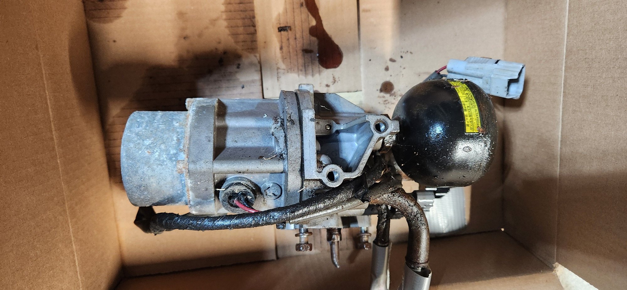

So, I finally removed my AYC pump this weekend! Few broken bolts and one snapped hard line later, it is in my basement. Of the three hard lines that connect on the side, first two came of without much fight, but the third one (all the way to the left side), didn't want to budge. So, I will have to buy a new hard line with hopes it will be installable without taking half the car out.
Pump looks pretty bad to me. Lot of corrosion on the valves too. Will try to clean it up and maybe paint it, if I could fix the rest.
Any comments on how this looks like so far? It does look a bit different from the video about how to fix those, but what do I know

just buy a used unit. and maybe work on that on the side. never too late to spray some corrosion inhibitors since you live in the snowbelt

have seen far worse...
the biggest issue are the valves and if they cracked... spray some penetrating oil on the area where the valves enter the body and try to pull them out... if they do not crack, you are ok.
the 3 bolts that hold the motor are probably going to get stuck and break. Using a small impact driver might help. If they break, no issue... just get them off, pull the motor and undo the two inside bolts. then you will need to cut the sides of the pump body, where the bolts go trough to get them loose and pull the body apart.... Looks ugly but is no issue... let me know how you get on and I will help..

I will try to take the valves out first just to make sure they will come off without any issues. Corrosion on them looks just like a surface one, so I don't expect issues there.
One thing that I didn't do is to test the pump while in the car to know that motor is actually working. How likely is that something else is bad aside from the corrosion on that plate inside the pump? Could I just try to hook up the motor to run on its own? You have something in your video there, but I am not sure if I could be able to build that test unit...

the motors on the evo X like to burn out.. and sometimes they will spin freely and then not work with some resistance later on. You can connect it to direct 12 V and see if it works.. dont need any special tools for that. Also, replacement motors are available... I just installed one we bought from canada..
as for valves.. they tend to corrode on the 5mm space between the large diameter part of the valve body and first O ring that sits inside the pump body... that is where they get stuck..
Connect the motor, see if it spins... take valves out, and disassemble further...

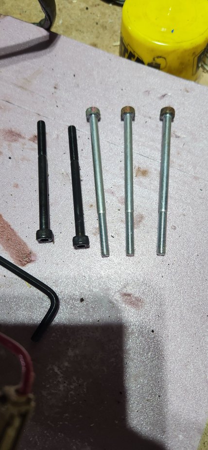

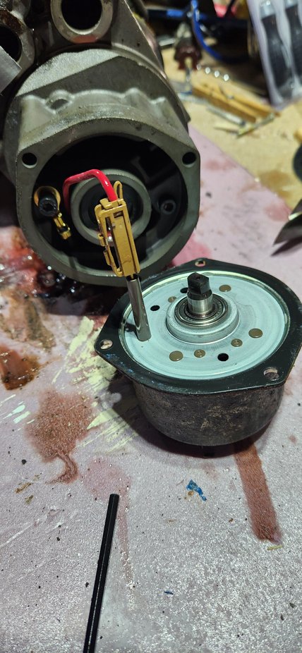

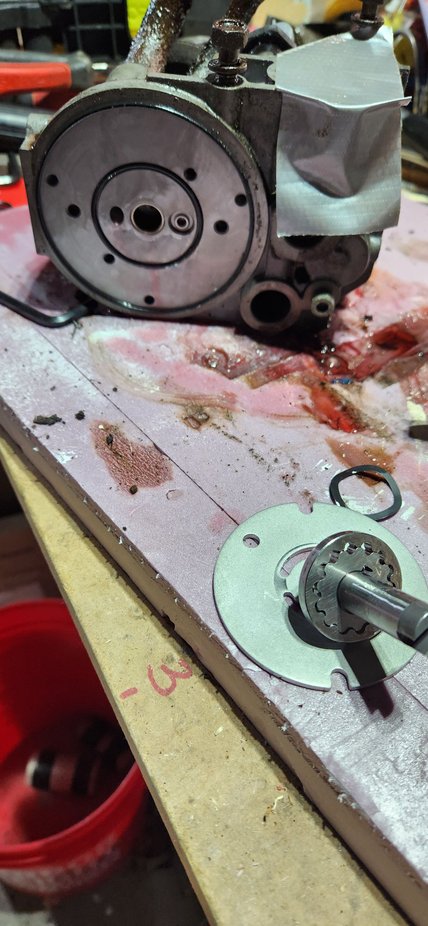

So, I decided to try to open my pump and was greatly surprised there. Valves came off relatively easy and look decent from outside. Then, for fun sake, I inserted an allen wrench in one of the long bolts and tried to budge it. Not that it did, but came all out. Same for the second and the third one as well! Then, two inside bolts came off as well (I had to take a picture to see them all together undamaged, which I didn't expect to see). Finally the oil pump side came off and there is no corrosion there whatsoever!!
So, this pump is different than those from @kikiturbo video that he shared and any other image of the pump that I have seen so far. This is a third pump that was installed on my car (all under warranty) and I was told that they did change something in how those pumps are built. This one has two extra wires inside as well which I didn't see before either. Internals also look different from the videos and images as well. The repair kit that I bought doesn't seem to fit this one at all.
So, where to go from here?
I should have definitely tested the pump while it was on the car to see what could be wrong. I will try to get the error code from the ECU hoping it would tell me something more there. From what I can see here, it doesn't look like I have a typical corroded inner part of the pump itself. So, what else could be wrong here? One of those valves might have stopped working perhaps. The motor might have given up too.
Anyway, if you have some idea what to do here next, it would be appreciated!
Here are some more images (including all 5 undamaged bolts)

all repair kits are the same... so it should work..
pump looks great, so you might want to test the motor..
please note, that turning the plate wrong way, will make the pump inoperable.. i.e. it will not produce pressure...
I would clean everything, put it back together, put valves back in and try to run the motor. If it runs, then attach a big piece of hose to the big input pipe, fill it with atf and try running the pump.. see if it will ingest fluid and produce pressure.. you should hear the pump slow down..
