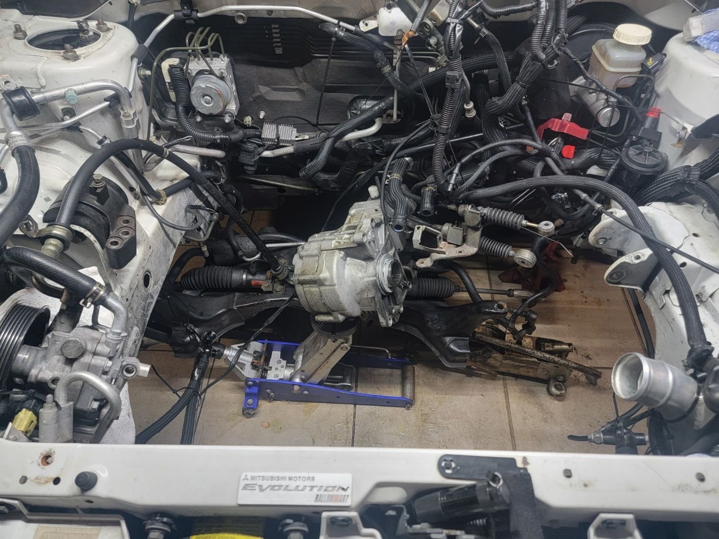

evo tcase finally opened up, and yep, my ats was failing. carbon pads delaminated. spider gearset had a few cracked teeth on the side gear. ring and pinion was worn out, but I was expecting that with the age of the t-case.
are there any performance benefits I can expect from refreshing the t-case with a severely worn down r&p? differential aside.
ats rear diff still good, will be selling that one to anyone interested.

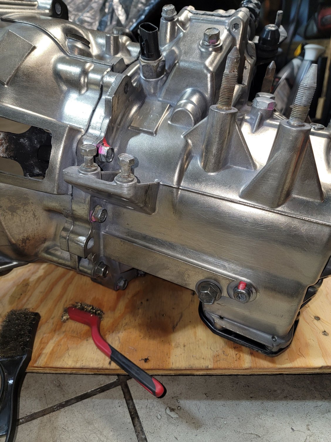

Has anyone polished their transmission? Seems like a cool project imma dremel every nook until my parts get here
Not sure if its possible for you to strip off but you could vapour blast it or media blast it or something? acid dip?

I think I'm ok with just brushed and maybe add some waterproofing spray and hope it helps where water gets stuck
