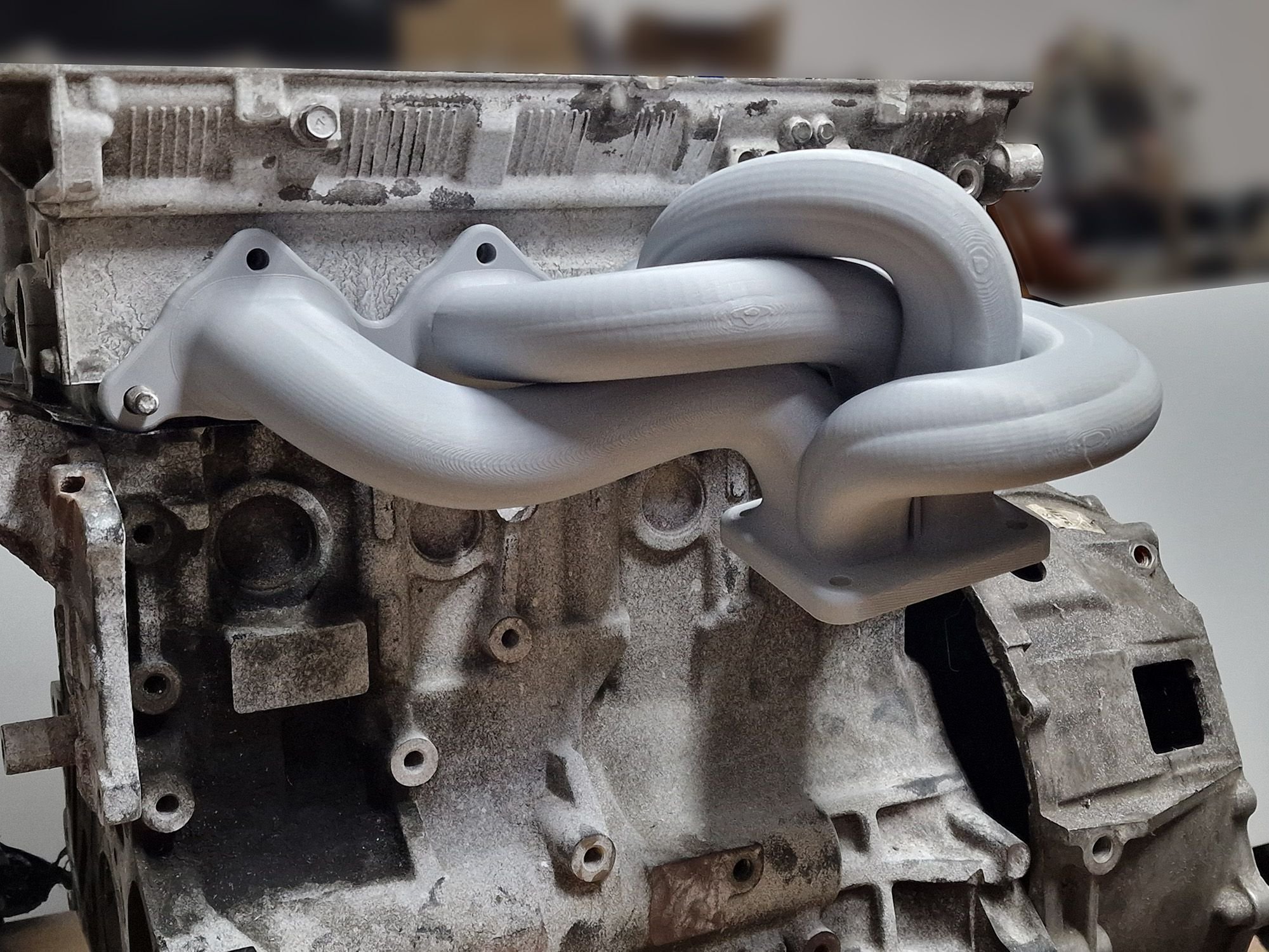

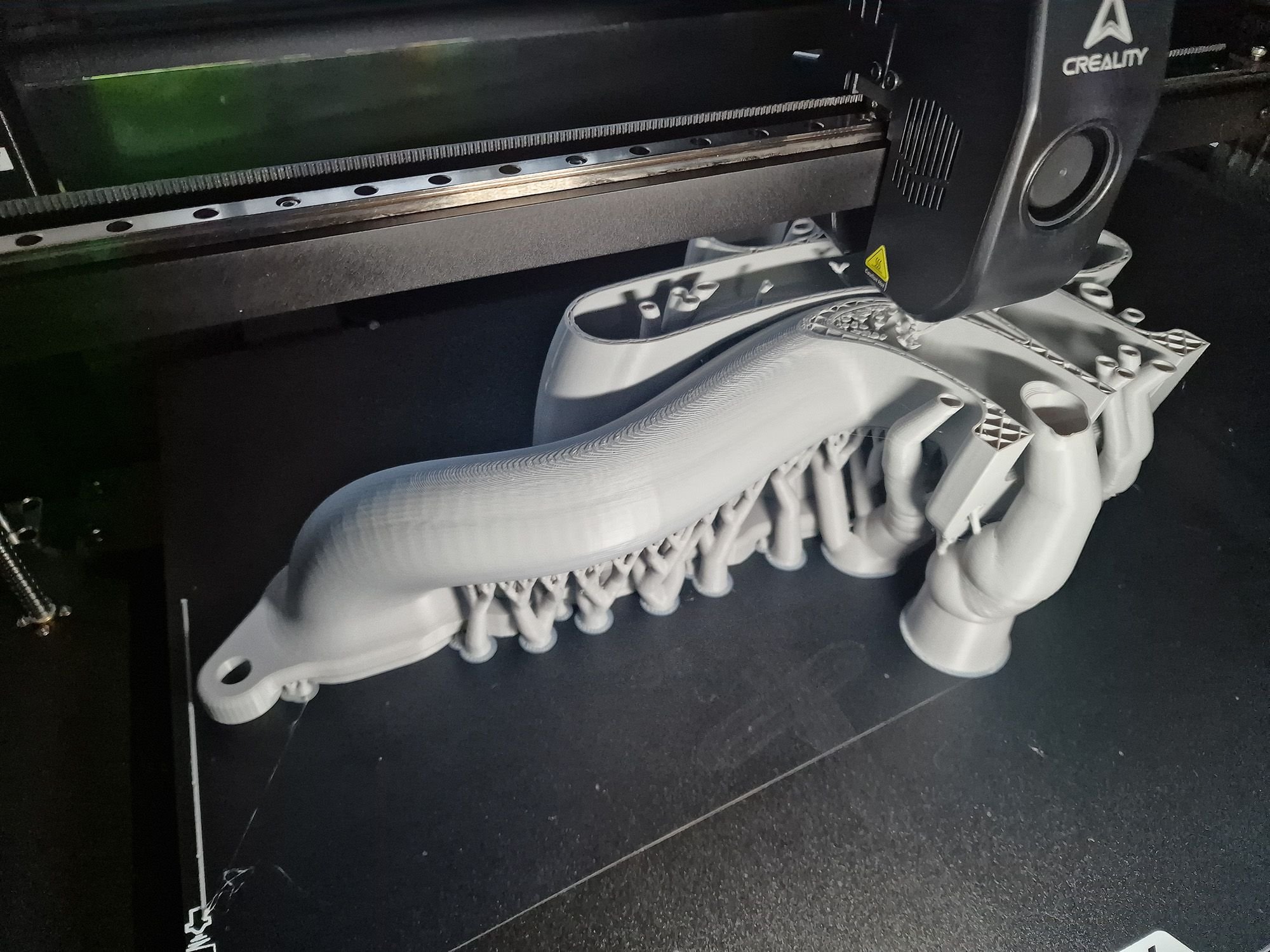

Splurged on a 3d printer...
The EFR exhaust manifold needs a few more fillets but printed it to check for fitment... It is spot on compared to 3d scan of the block in SW.. Next to touch up the design and send for printing in metal....
playing with something else too..

That's crazy bro. meanwhile my local tuners dont even want to use the ER oil pump gear which is allegedly 3d printed
dont tell me creality can print metal
ha, nooooo..... I will use outside service for metal. I bought this to do some prototypes and maybe do some light duty pieces using high temp filaments with carbon fibre

Originally Posted by 211Ratsbud
Interested to hear cost, and potential availability of a copy, my old car new owner was considering dumping the gtx3582 gen 2, 1.01 hot side for a newer Garrett G series, but the efr with an would go super hard on that 2.4 long rod for street fun 😊
I am shopping around for quotes, but right now, China is much cheaper than europe, for 3D printing in metal. It looks like a 900 to 1200 usd print cost in china. As a personal project, that probably makes sense as I will spend a lot of time to make a tube version of this.... And I did make it, and it had 100 mm longer runners and was real hard to hide in the engine bay as a stockish looking item.
Now, switching from a garret to an EFR, I am affraid, does not make much sense as it would involve mods to the downpipe, intake and pressure piping to turbo, as the turbo is mounted quite a bit towards the driver side of the car... so the oe fan does not work too..
I designed a printed manifold for my car as well and it fell into that same price range printed out of stainless using an overseas broker.
I got some prototypes of another part printed in aluminum last year. They required all of the flanges to be ground flat (high distortion) and tapping threads felt like running a tap through sand. It left me feeling very meh, but they did work just fine. It's not something I would feel comfortable selling to someone but it's a great option for hobbyists that want to do something for themselves or demoing an idea.
