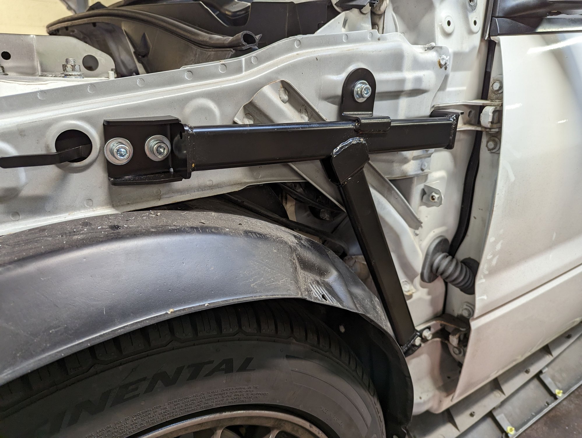

fender braces in! bf's cross member brace going in to at least partially offset the ~6lbs these add

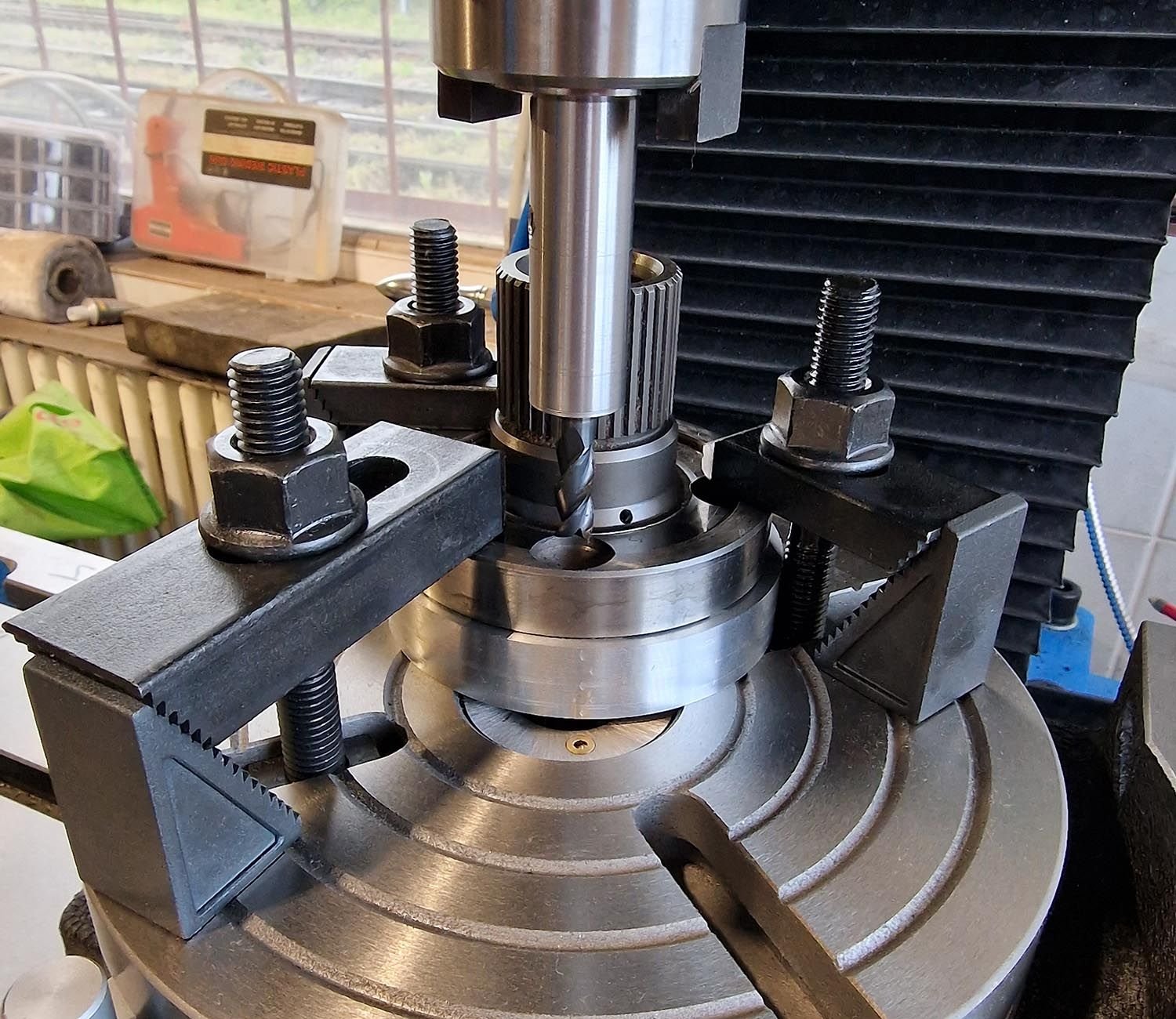

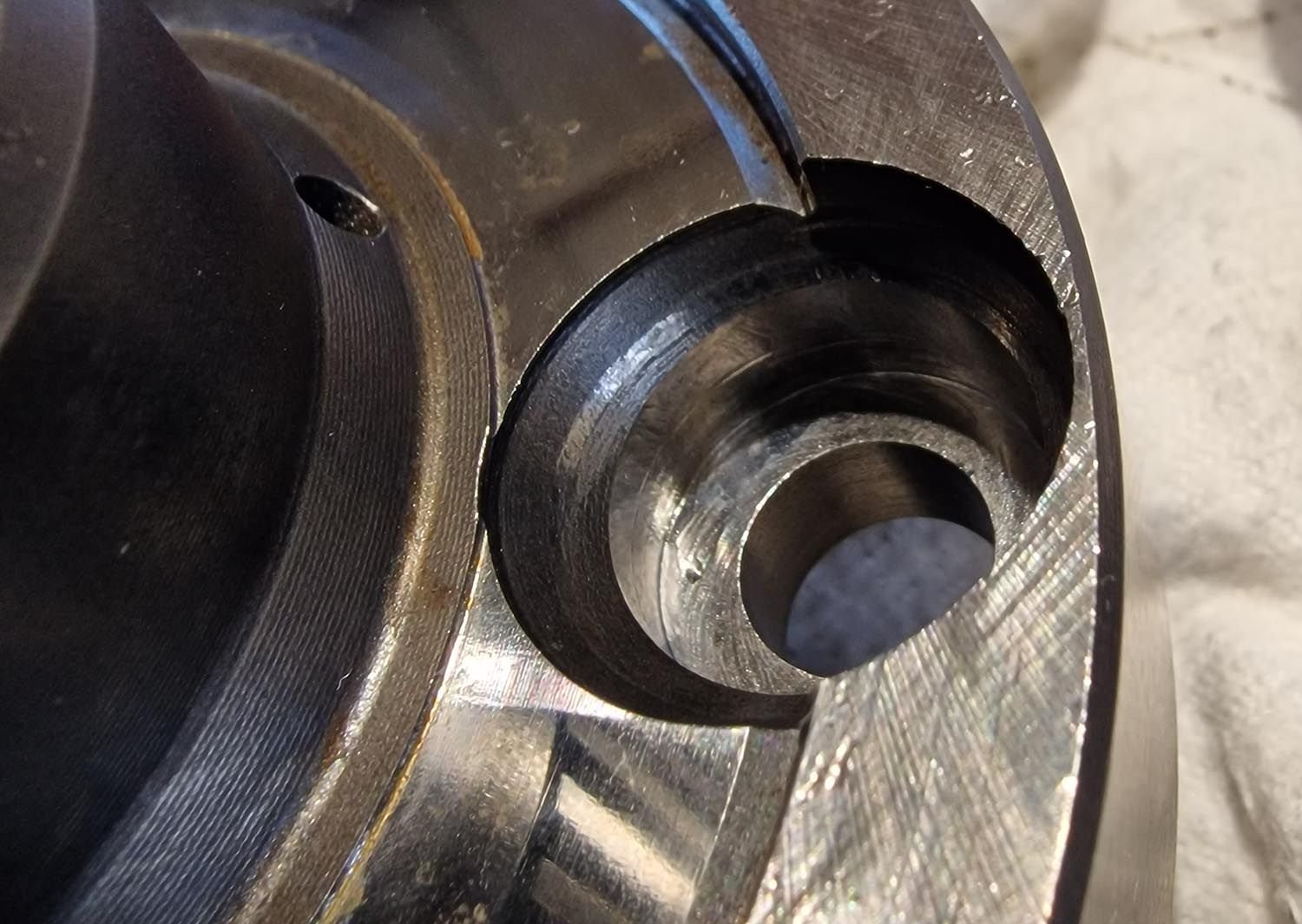

This was a short fix for an issue that is specific to older evos (like e6 and earlier).... torsen diffs were held together with countersunk bolts instead of cap bolts.. due to forces in the diff cap they could break and damage the diff housing/TC
It is a bit of a hard steel, but a special endmill (with custom extension haha) made easy work of it.. and now it accepts normal 8mm alen cap bolts

imo the evo doesn’t need those
