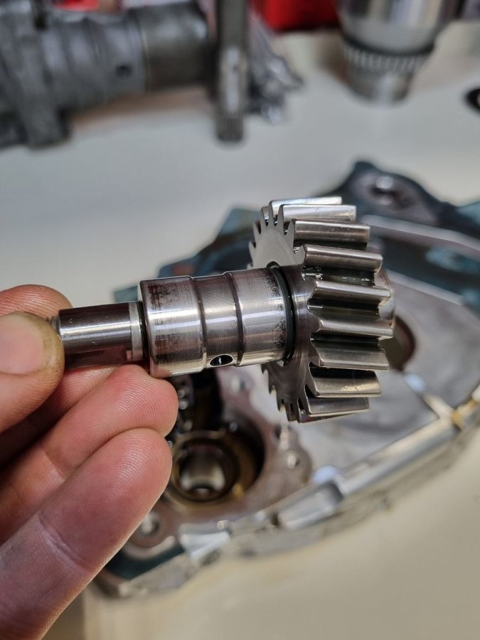

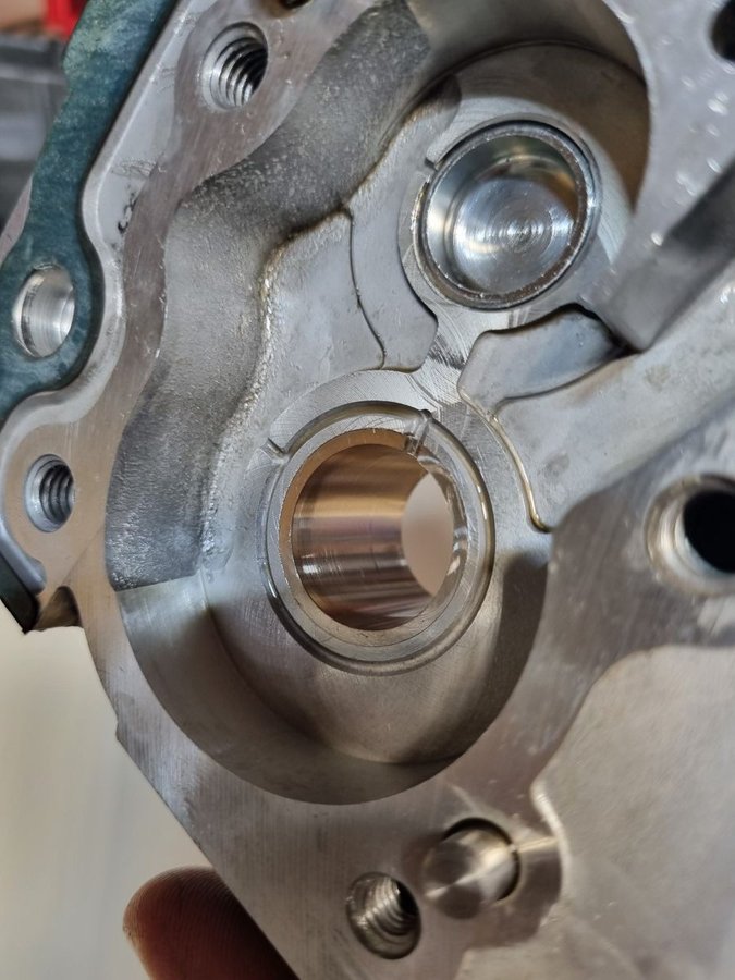

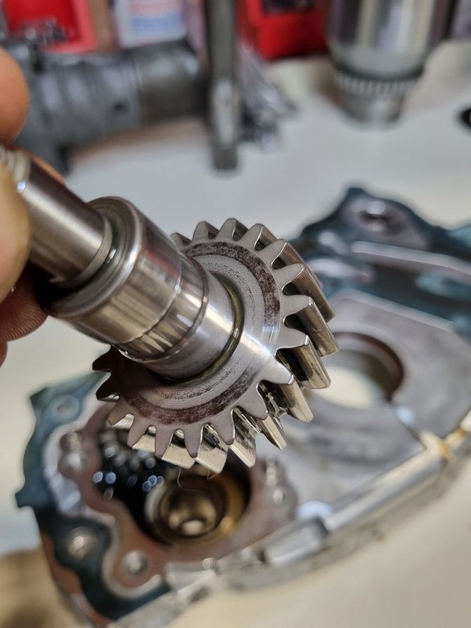

I've just finished a bunch of work on my car too, hopefully hit the track tomorrow:
Reduced front diff preload from 40ftlb to ~5ftlb.
Replaced 4th gear (again) with DLC+WPC treated unit. If this wears again i'll do aftermarket 4th from PAR or NEAT gearboxes.
changed rear springs from 11kg to 14kg (10kg front).
23mm Cusco rear swaybar with 3way adjustment.
Added catch can electric oil pump - pushes oil back to pan (controlled by Emtron).
Pulled and inspected the oil pump modification i've been using. Working very well. Will modify another one soon and test more. Hopefully go into production in the next 3-6 months.
Added a bunch more sensors with external CAN modules. Bottom radiator hose temp. EMAP. Transfer temp. Ambient air temp. Pre intercooler IAT.
Future wiring there for Flex fuel and turbo speed sensor.
Road test tomorrow morning!
