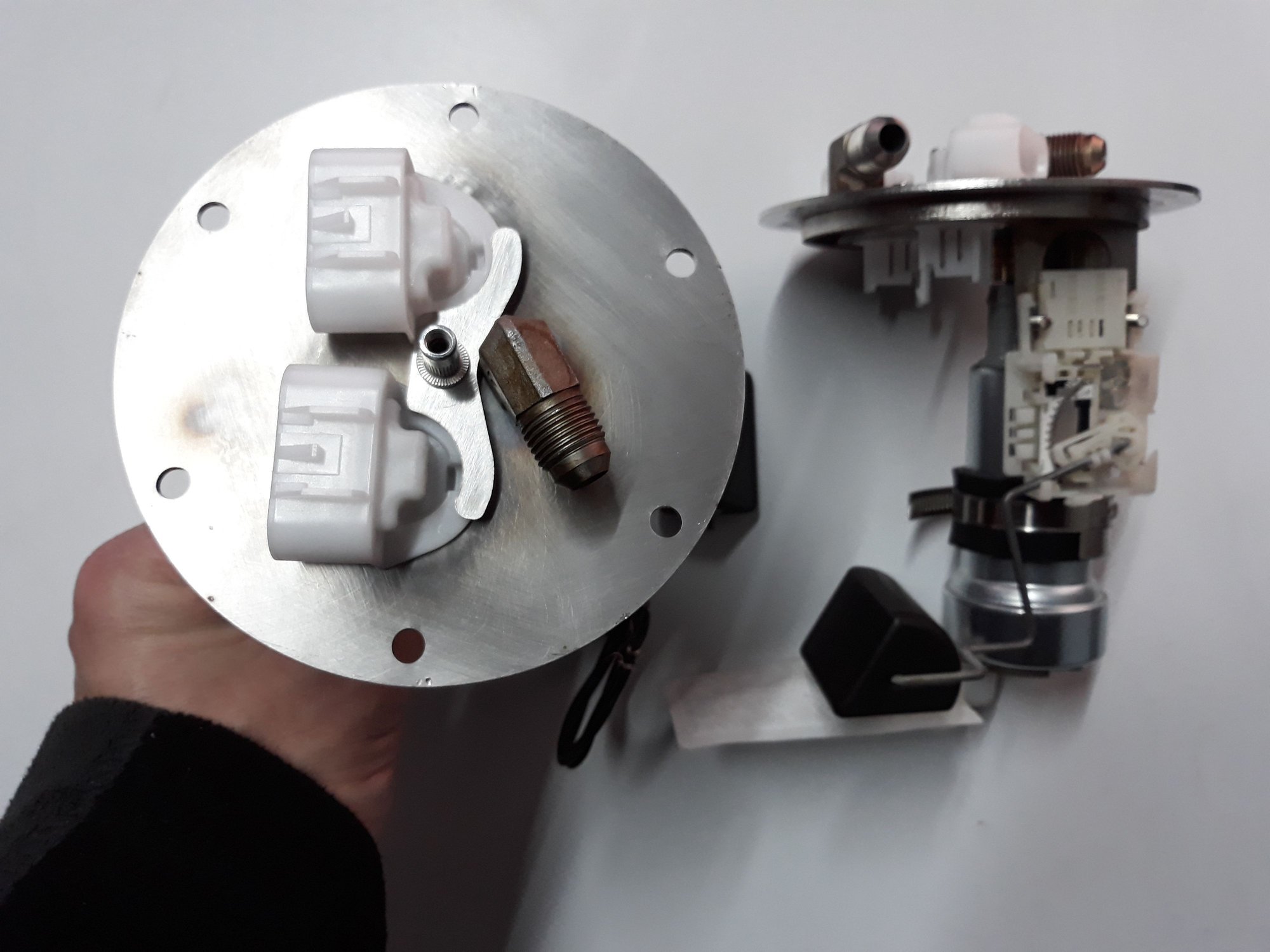

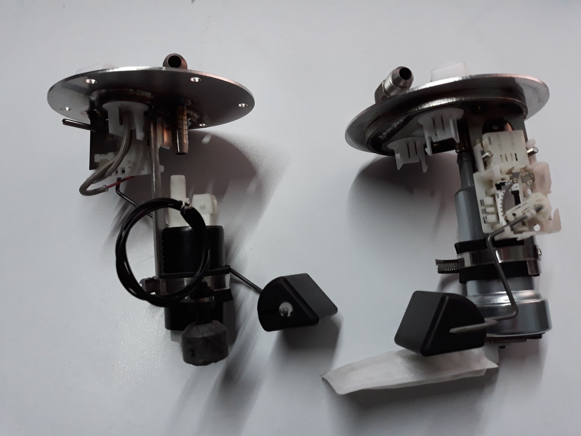

talking about this...
I always thought that we should get rid of that venturi... would make life easier when running big pumps.. also, secondary pump is a small low amp one as not to tax the electrical system. The tank connectors I found are some OE GM ones, and support high amps..

A low amp, low pressure 150 lph pump on the pass side will keep the fuel bowl full at all times, even at 1+g turns.. and the wiring is not that difficult.. plus you get more constant fuel pressure because of not having to have a venturi in line
Another option is to keep the venturi for normal driving and put the aux pump in the co driver side of the tank, but activate it from the motec.. trigger it at +.5 G left hand turn only..
