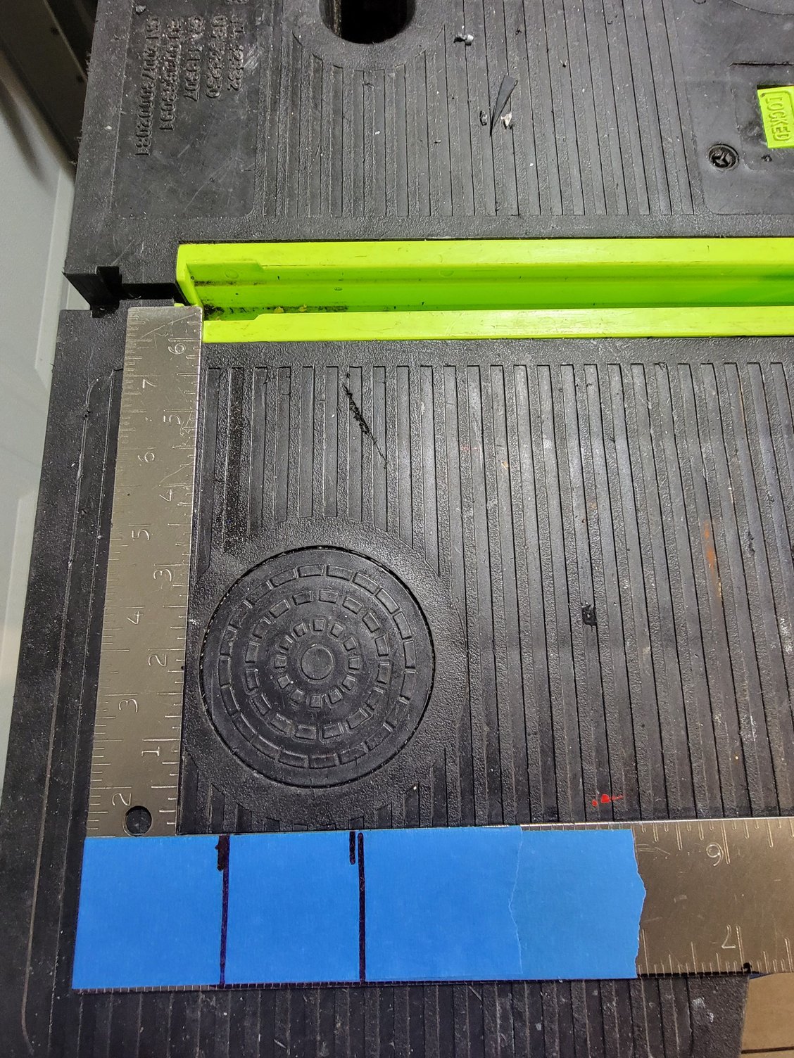

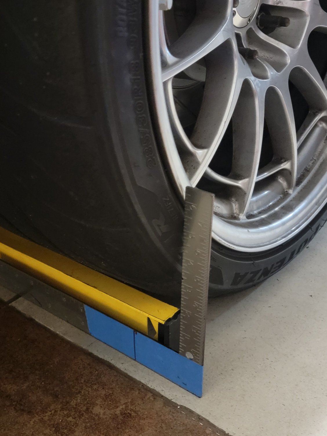

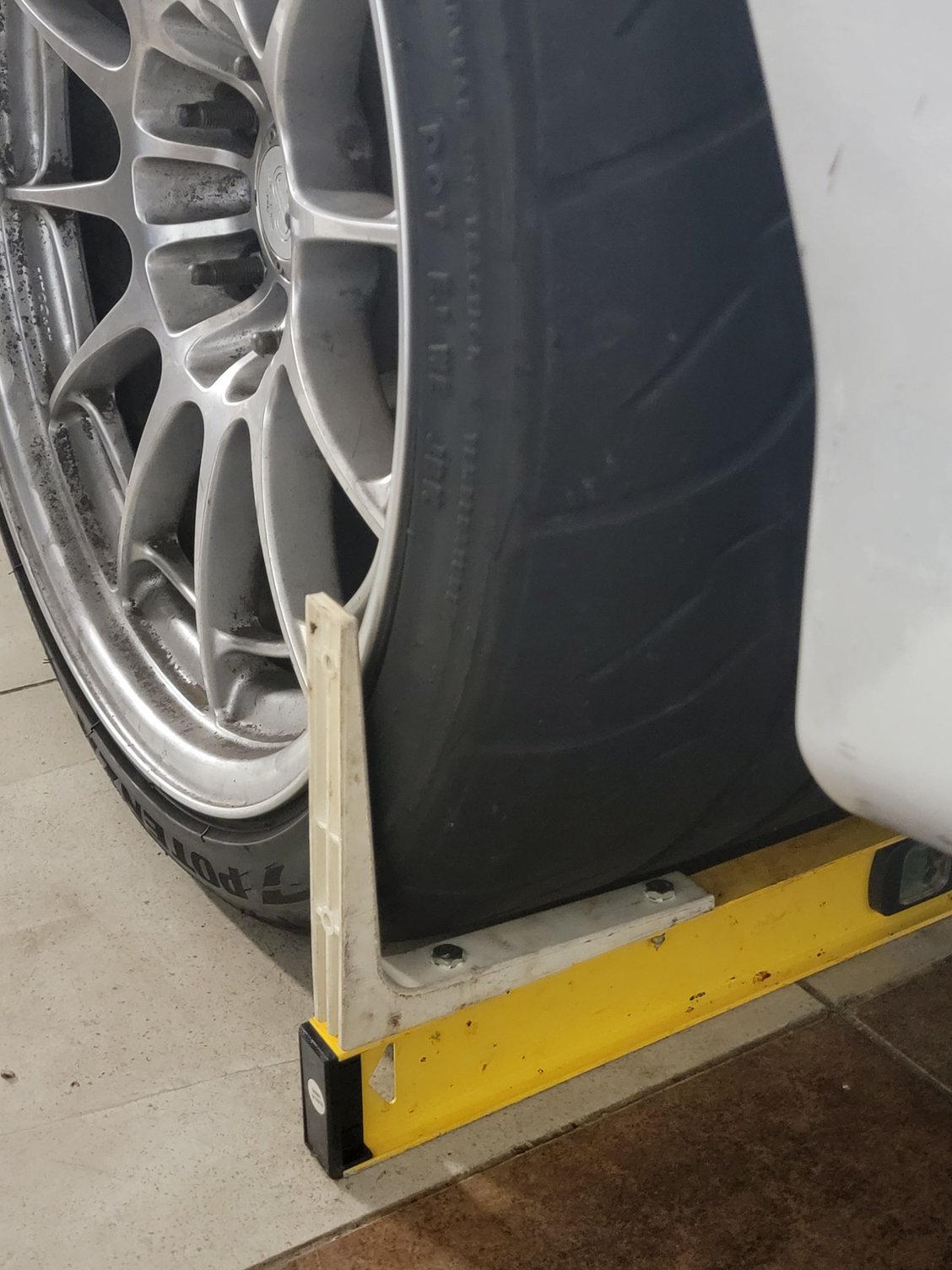

Simple tool for toe

Simple tool for toe
How do you make sure it's squared up to the two wheels?

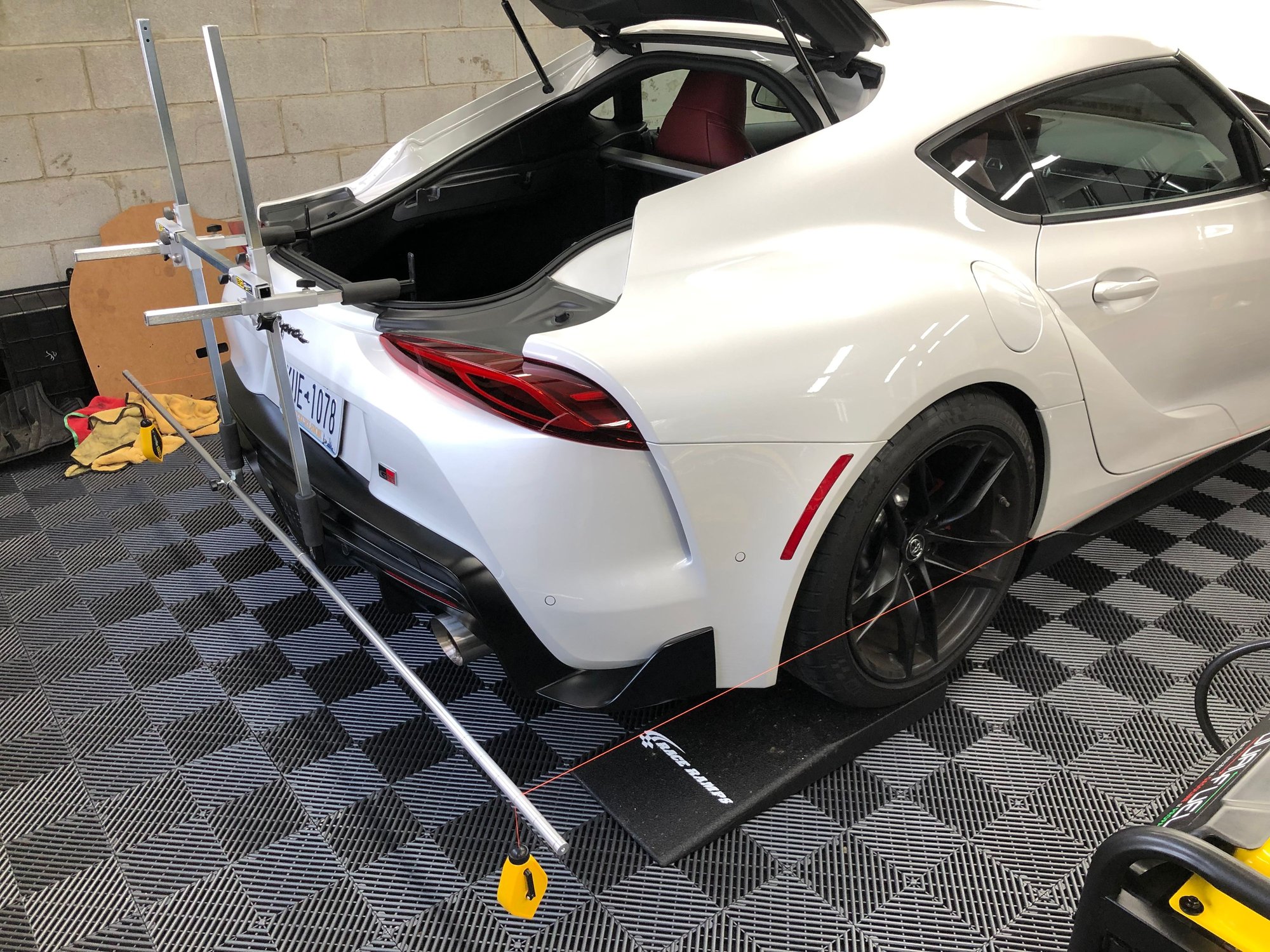

I recently invested in a string alignment kit. I've used it two times already and so far it's been so much easier to do your own alignment than I had thought. I honestly wish I would have bought something like this years ago.

Ive been using jack stands and fishing line squared up to the car for alignments for 18 years now. Its really way easier to do than people think but does take attention to detail.
Also its good to at least level the floor left/right. And not by measuring the car angle but the actual floor points.
I have to perfect the 2 rear wheels first, using 2 6' rulers and square both wheels to (or thru)the doors and rearwards. i leave tape on the floor also to measure the squareness. after that I just have a clothes line hooked onto the rear swaybar, the line goes to rear of rear tire all the way to the front bumper area using jackstands i can move when needed to open doors etc.
i dont want to be too dependent on SST
