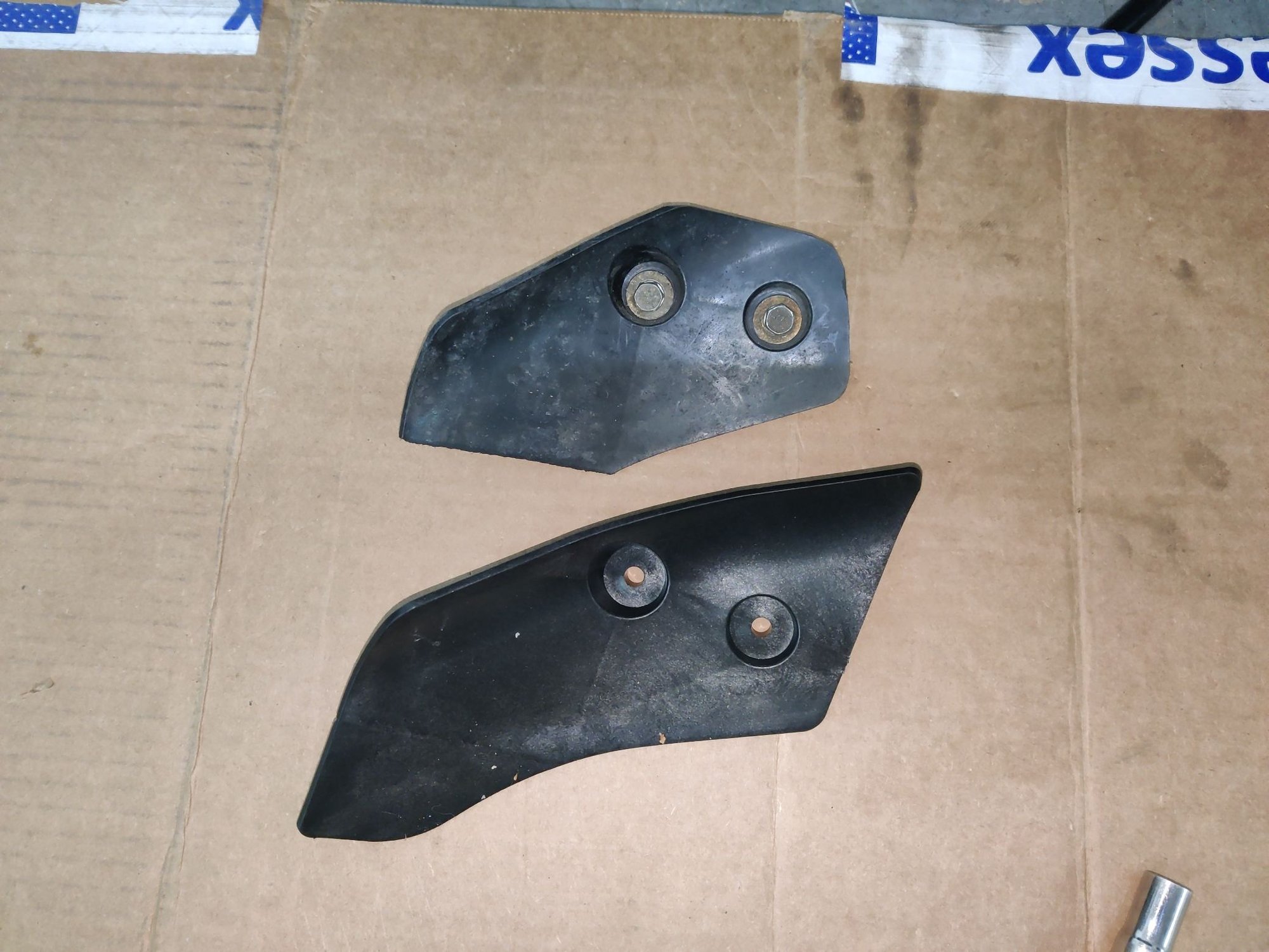

new brake air guides to help make up for my lack of ducting. looks like i broke off the bottom flap of the driver's side at some point - passenger's side still had the lower flap:
