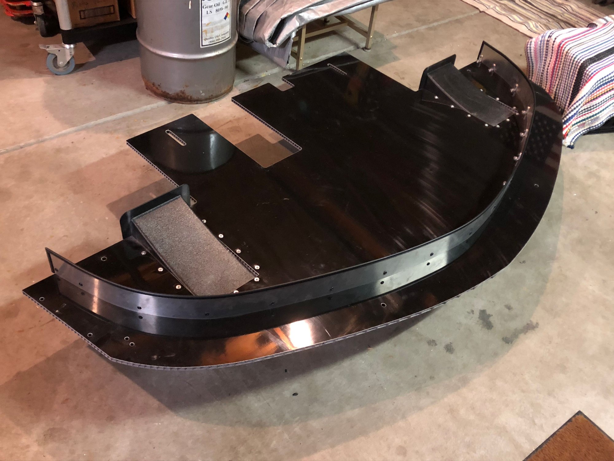

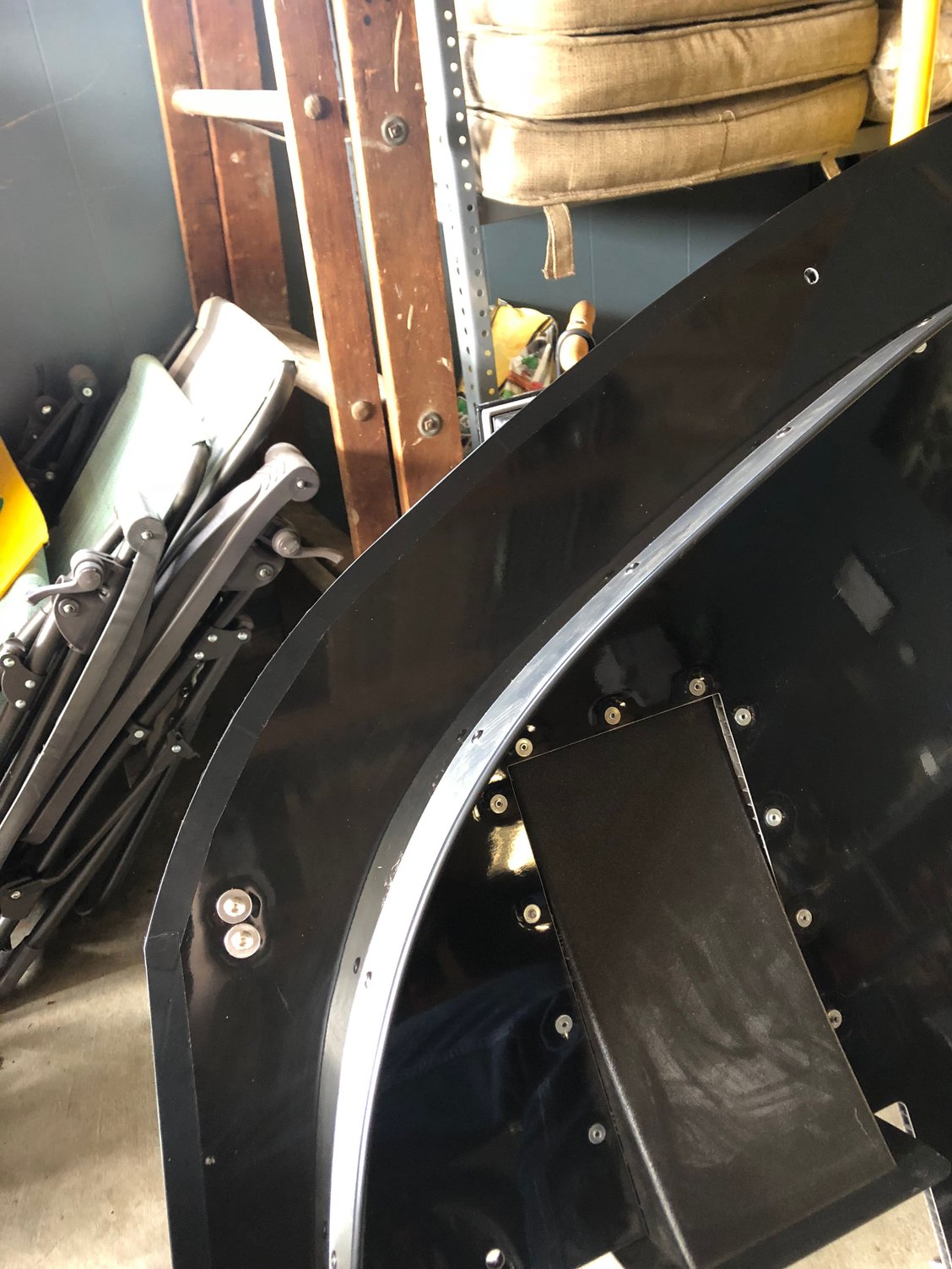

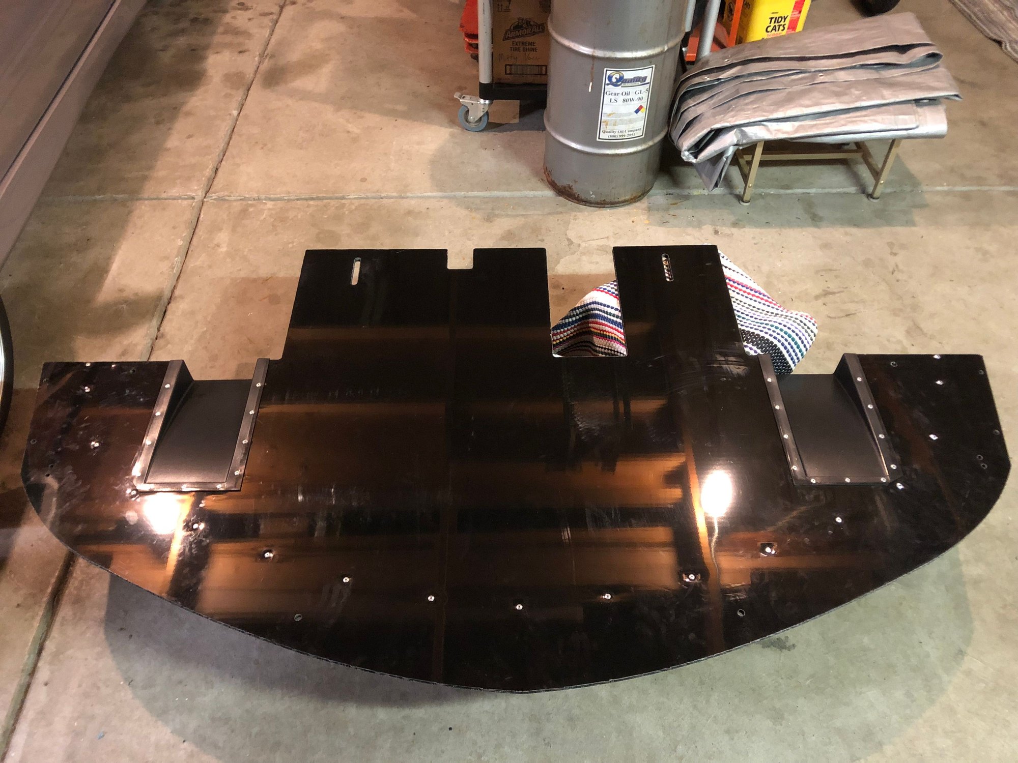

Originally Posted by bee-raddd
got any new pics of it?
Here's pics from the link I posted. I'll have pics with brackets and mounted later this week:

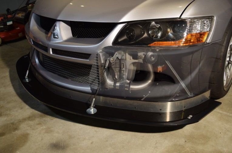

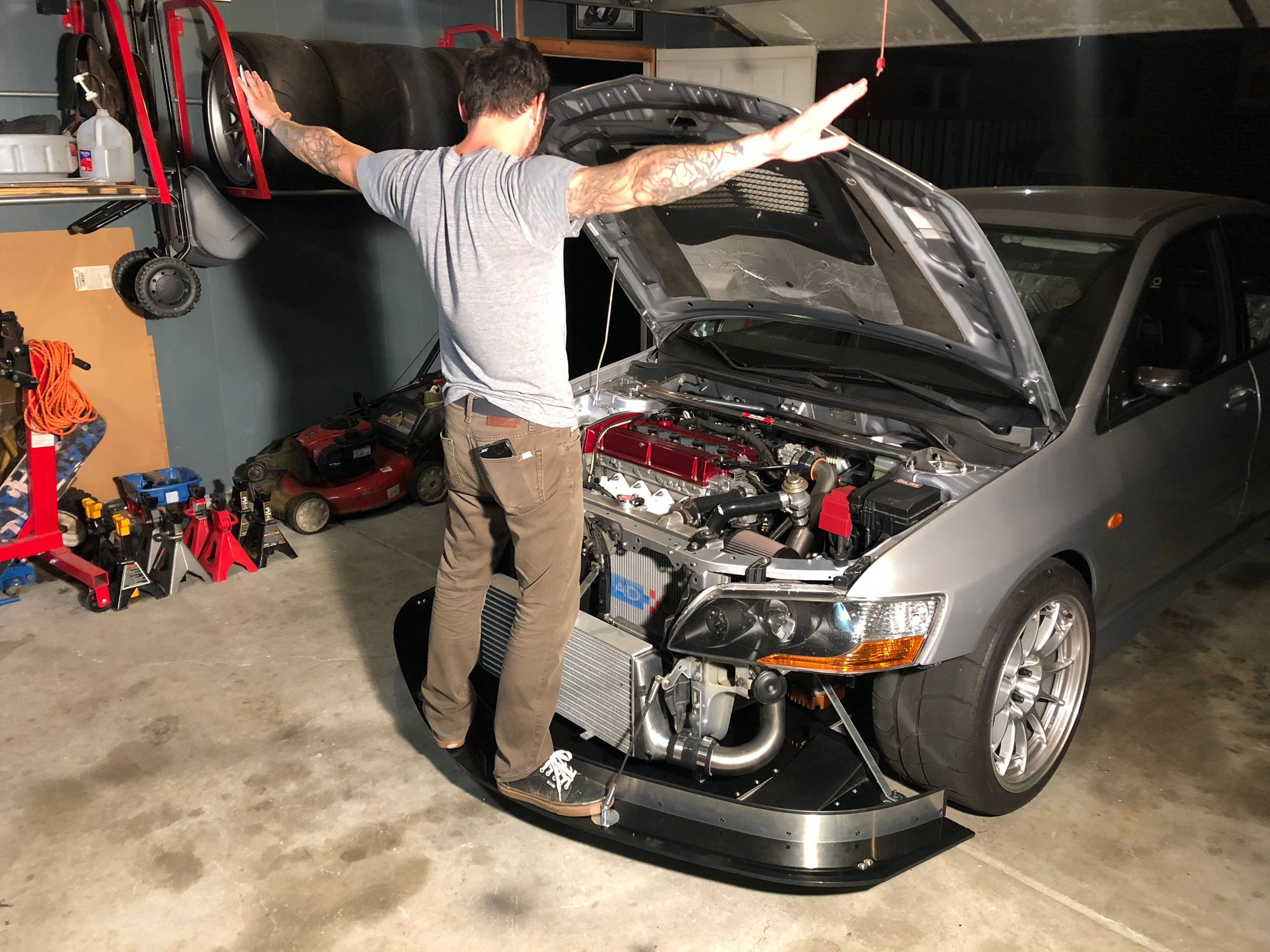

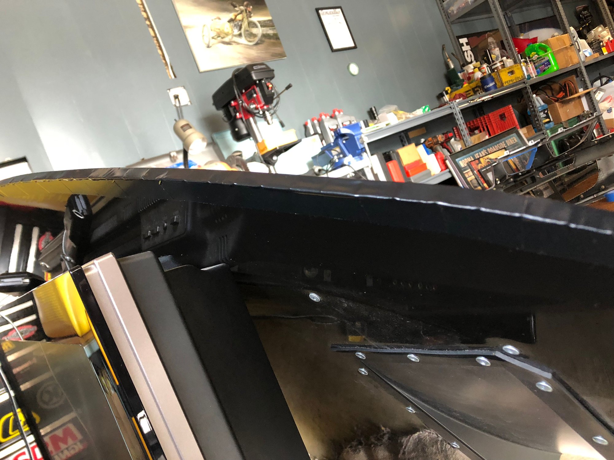

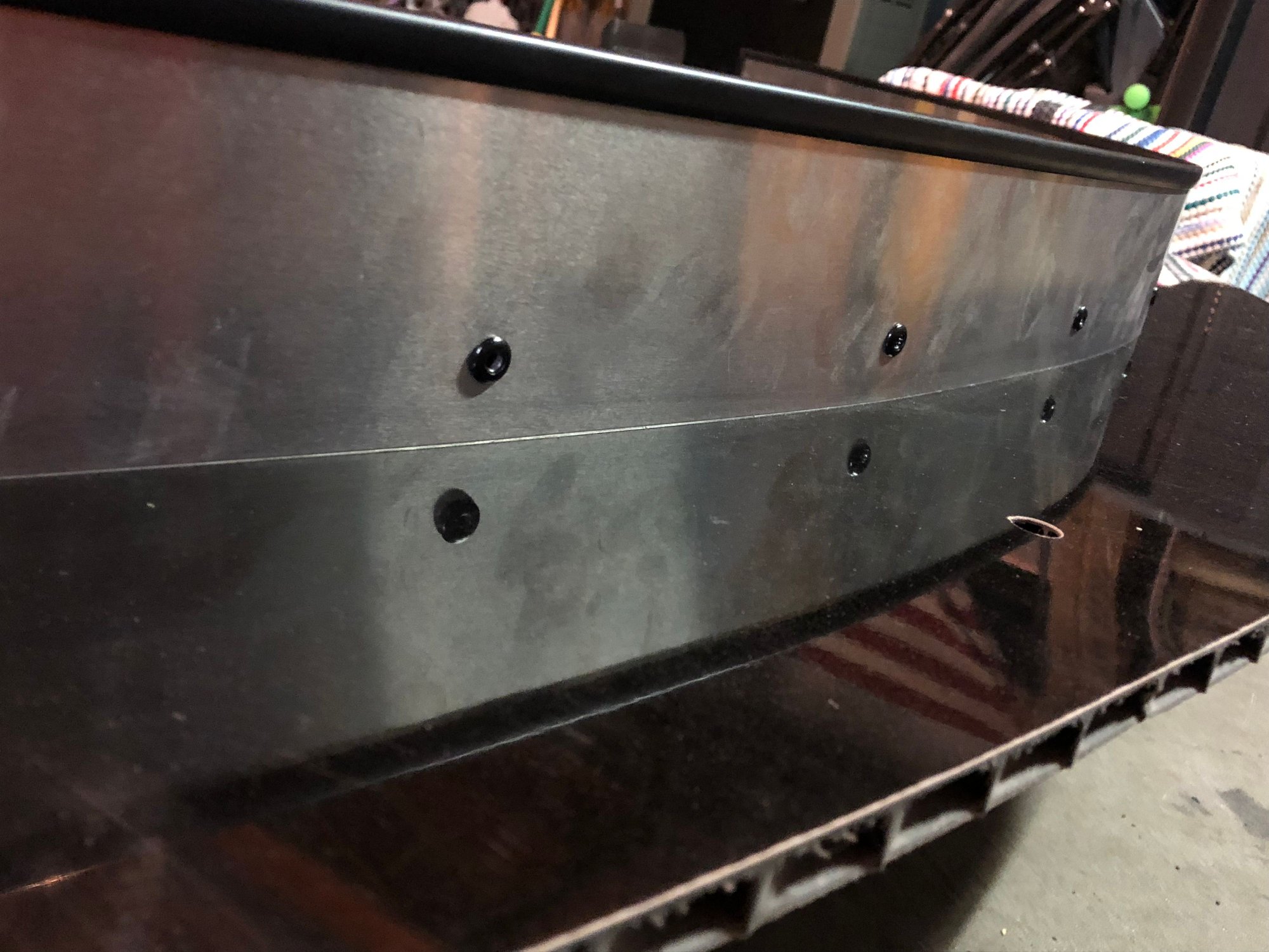

Finished up Marc's splitter for the most part this past weekend. He opted for a 5" extension length. It all bolts up requiring almost no permenant mods to the car short of some small clearancing of the bumper cover. Holds his weight no issue, 160lbs off the leading edge w/no flex so this thing is going nowhere.

looks really good!

Sweet! And the air dam looks it will most fit the IX bumper cover.
Does the lip stay on the bumper?

I'm' still trying to get my hands on a local 9 bumper to confirm but it does look very likely based off photos I've found of guys running 8 lips on 9 bumpers. Marc doesn't have a lip on his car so I can't comment about whether or not it would fit but I will say if the lip protrudes forward at all it would be good to remove it as the air dam will be way more effective if it can sit closer to the bumper cover rather than be pushed forward by the lip and leave a gap.

All of the brackets are height adjustable and if you trim the rods right you can adjust them too but for the most part there isn't a whole ton of angle adjustment. The alumalite hugs the underside of the car pretty good and it doesn't bend much so it inherently can't change angle too much.
