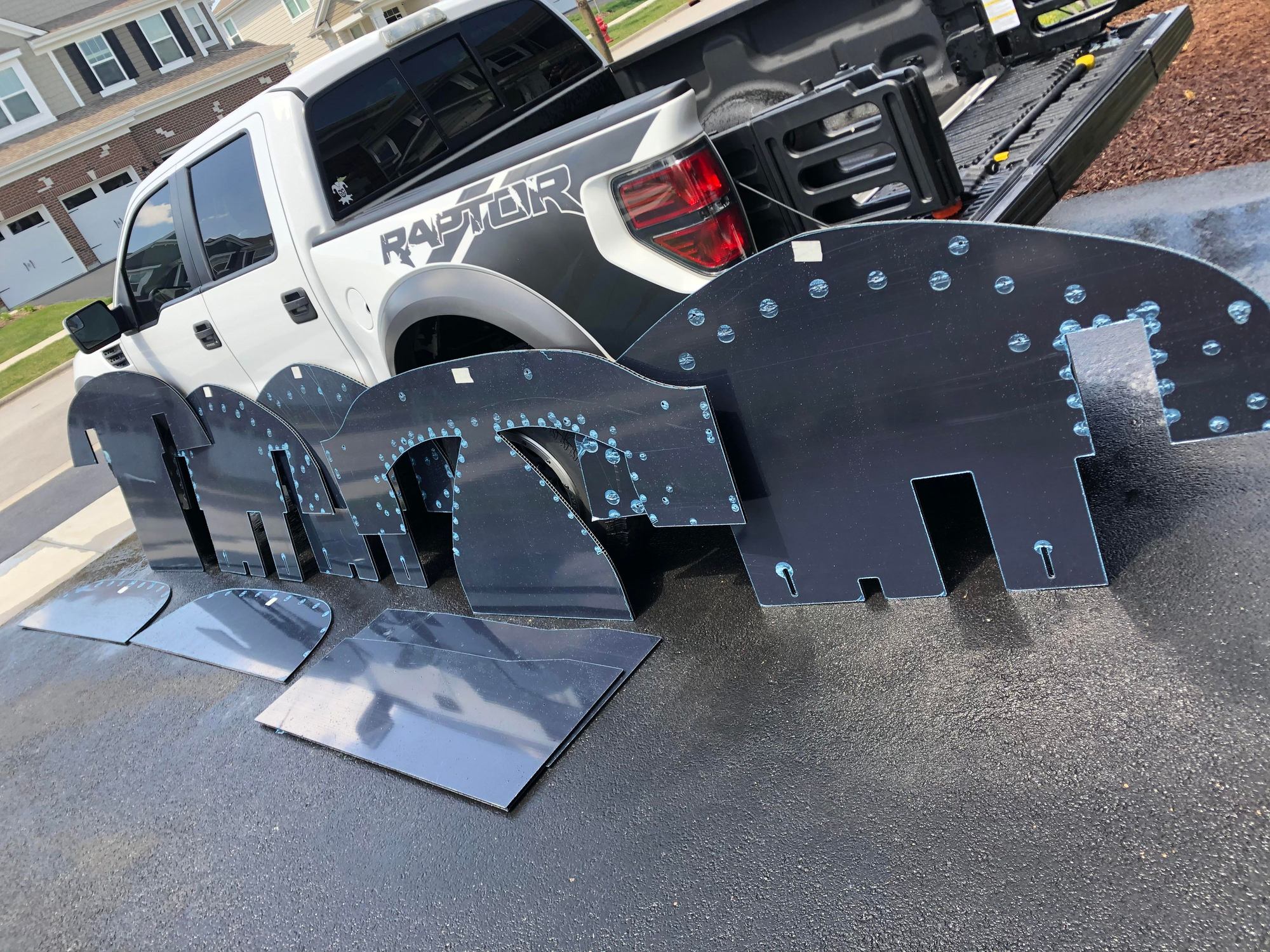

Been slowly cranking these guys out over the past couple months. Production is painfully slow thanks to COVID.
Only 3 in the photos are for evos. Still working on polishing the some of details for these but happy with how they're turning out thus far.

Nice man. If I were to be critical on improvements for a moment, the front mounts are "too simple?" Most of us SHOULD be running some kind of crash beam up front, I had one made of solid aluminum about 10 years ago that I still run that would interfere with that impact area, as would STM's. So I'd look at getting STM's at least and making it so it either mounted behind or a new bracket to fit one or both?
Then you need to start making Voltex style ones, and then carbon ones

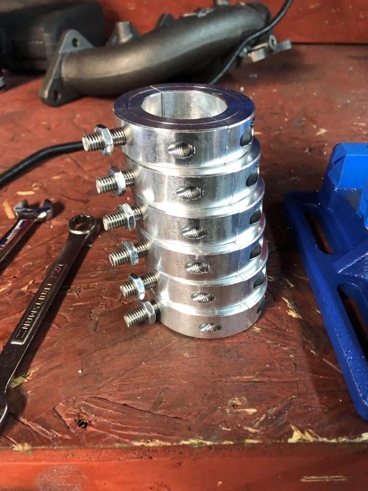

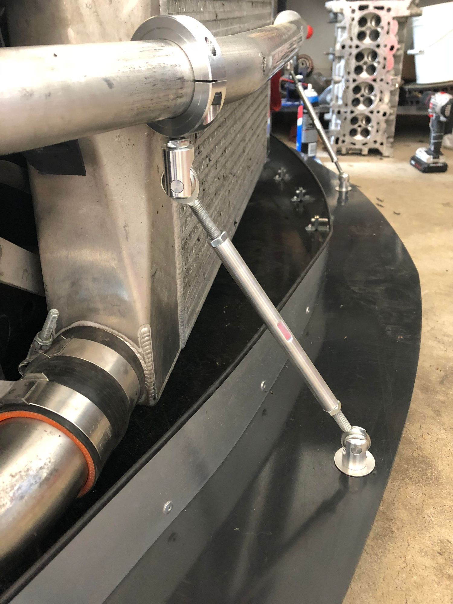

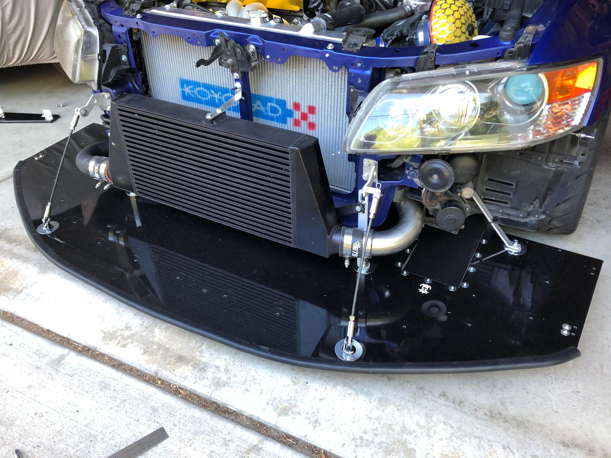

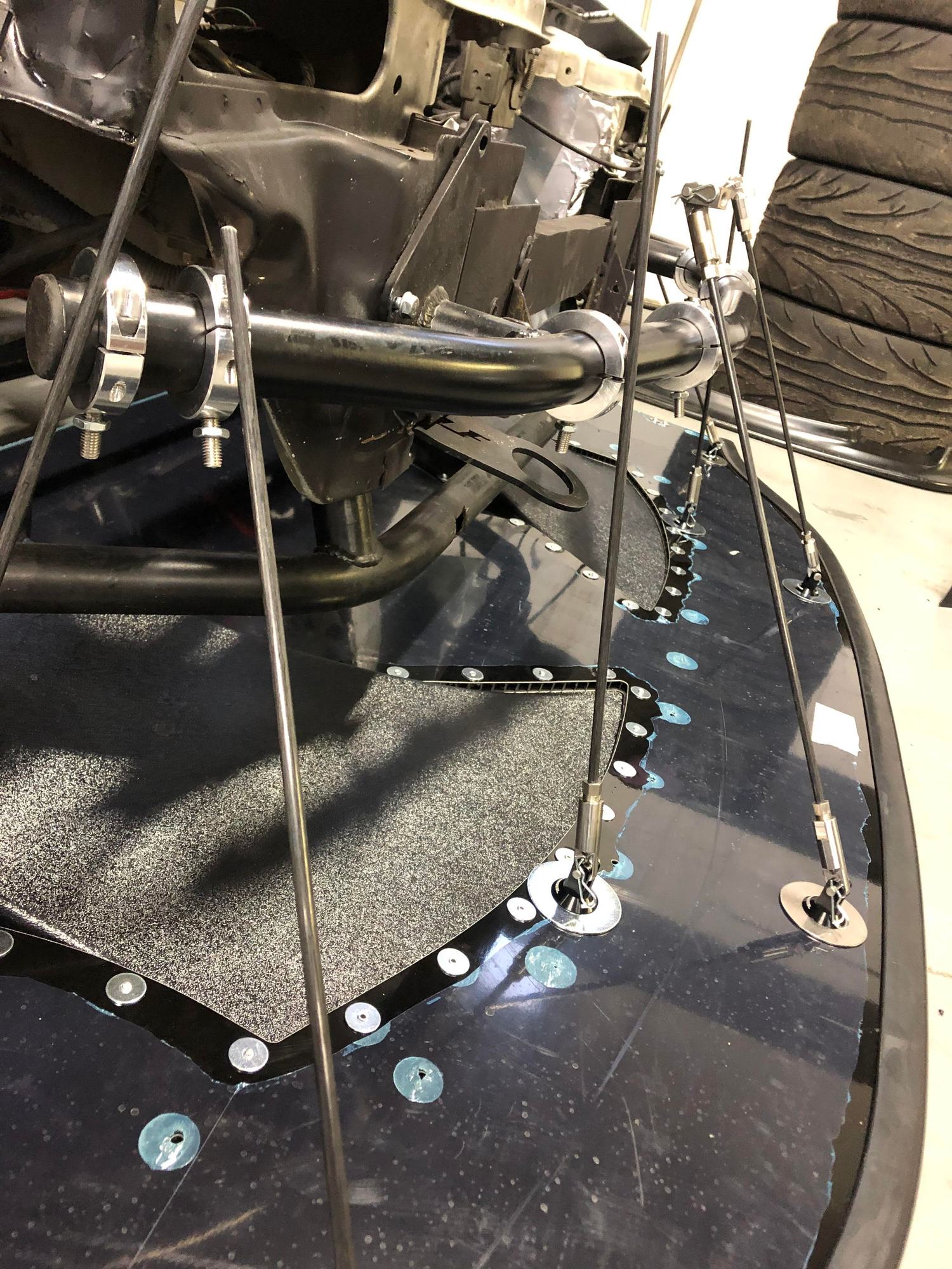

I have a tubular aluminum crash bar on my car. I make and sell rod mount collars to mount rods to those style crash bars. I've sold around 20 of them this year so far. Just filled out an order for 6 more yesterday! Here's an old photo of them on my car as well as a customer's miata I'm setting up:
The blue car in the photos is rocking a knock off Voltex bumper. It's a Gridlife Street Mod car so he's limited to 5" extension, and it's within 2mm
The next evolution of the mount setup is incorporating Pro Awe quick releases so mounting and dismounting the splitter is a completely tool-less affair.
