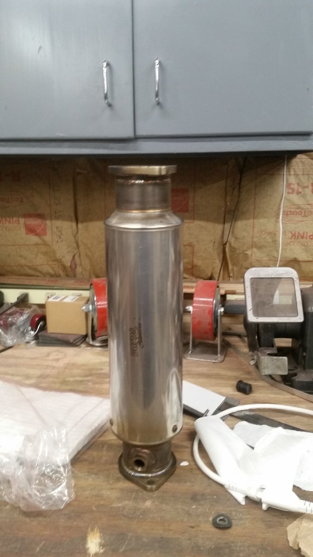

You could get Ti resonators from Vibrant and add them in. One in the test pipe location, and one in factory location right before the rear diff.
https://vibrantperformance.com/catal...b6b29633910b54

I picked up a Burns muffler to replace my test pipe and just repacked it and threw it on the car yesterday. Didnt get a chance to fire it up but I doubt it'll be enough.
