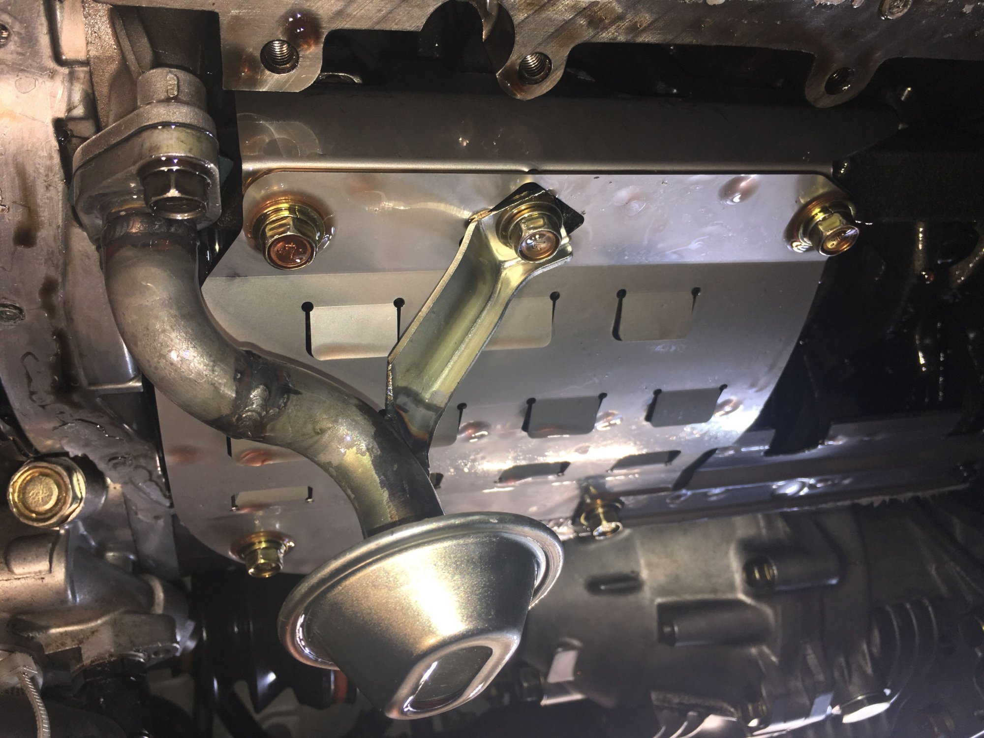

I think I might know the problem. It's not that there was an air leak at the pickup flange. The gasket was in there and the pickup was sealed. I know this because when I loosened the bolts, oil flowed out of it from the suction to the pump being broken. What I noticed is that the foot of the pickup, which is modified by RaceFab (note the welding on the tube), doesn't sit square in that hole in the Tomei windage tray. I should have caught this when I installed it. I believe that because of the overlap of that foot and the windage tray, the pickup is getting pushed down a couple of millimeters and may be too close to the bottom of the sump to allow sufficient flow. So, I'm going to make yet more modifications to the Tomei parts to open that hole and allow the foot of the pickup to sit squarely against the cradle (rather than being slightly shimmed). I'll then verify that the pickup isn't touching the bottom of the pan before sealing everything back up again, hopefully tomorrow. Doing the R&R is definitely faster than the first time when I spent a lot of time pondering next steps and getting up and down to get the right socket/wrench. Hopefully, I report success tomorrow.

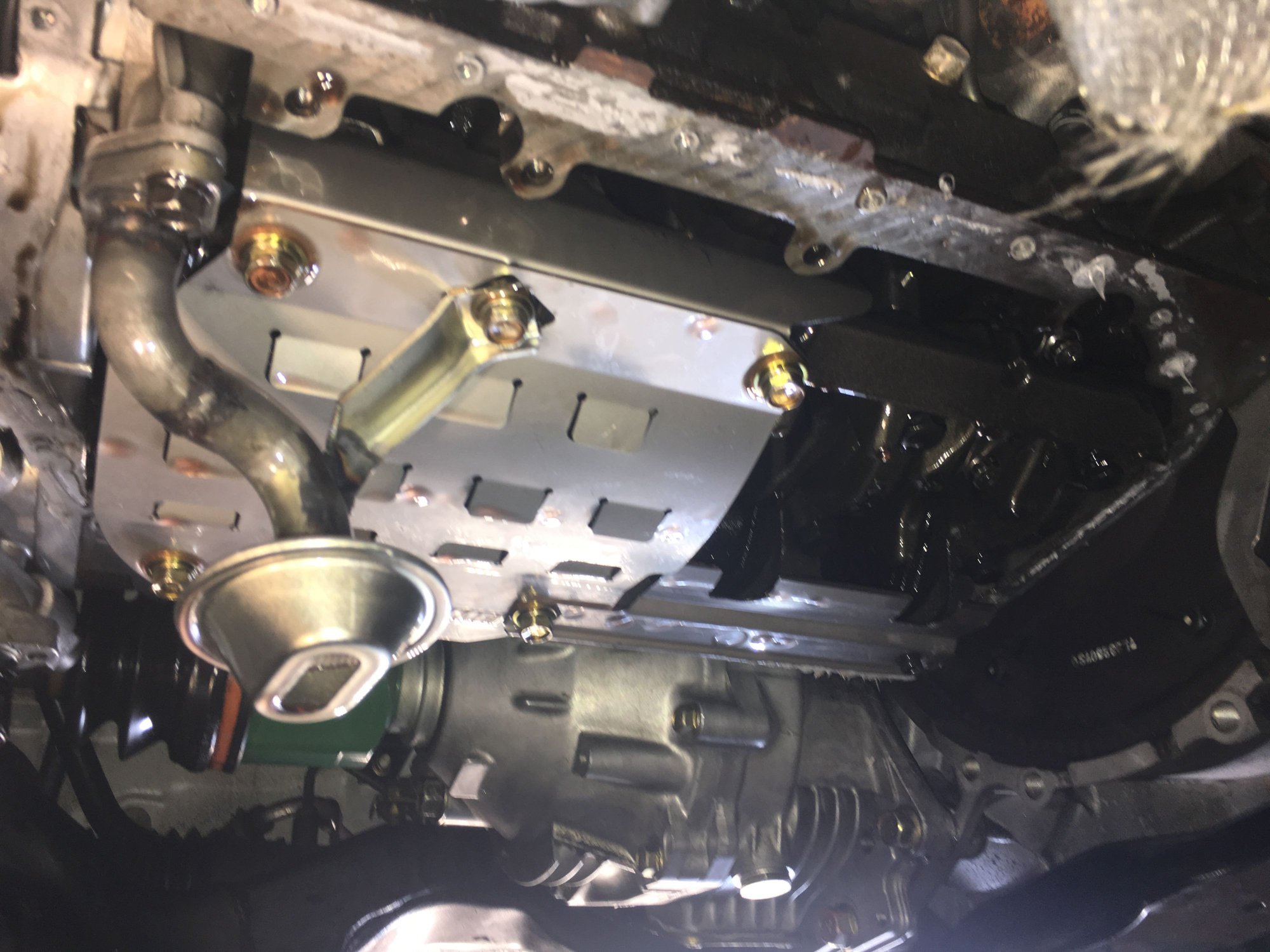

Found this pic from my build thread. I didnt have to do any trimming of my crank scraper but looking at the pics it appears to sorta sit on top of it a lil too but not as drastic as yours. Even so might just be as simple as a bad filter. Im not sure if the pan is glued back on but you could always just stick the pickup in a container of oil and crank her over to see if it builds pressure with no filter installed.
