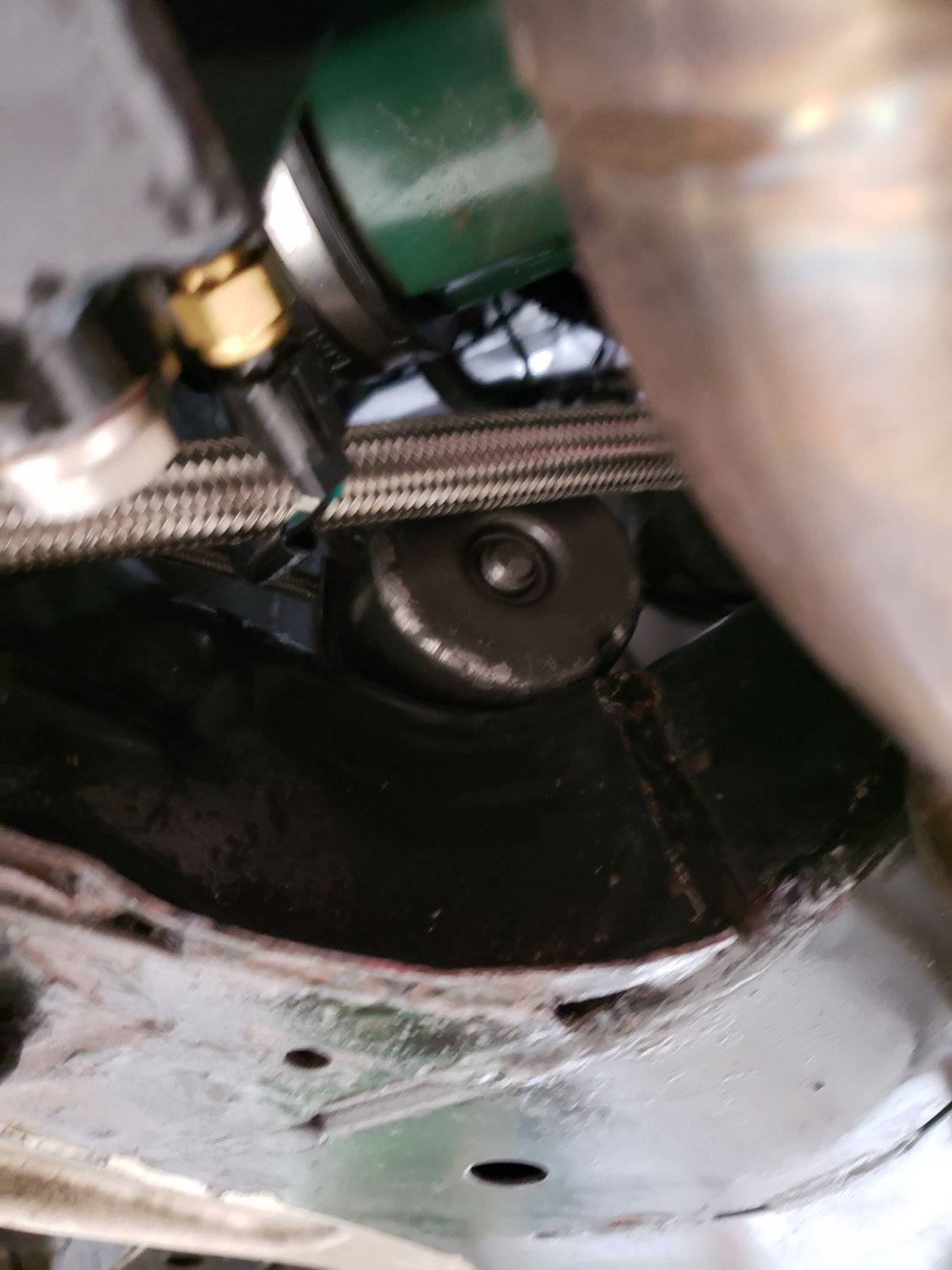

It seems my car has crossed the line from where in the past was modified and driven hard yet remained fairly reliable for what it is. Of course I'd go through it after events but things remained fairly status quo. Now on the other hand seems after like every drive I need to go through the entire thing but far more meticulous. Take my most recent PS bolts backing out. There are 3 bolts on the bottom and I bet they didnt come out at the same time so I clearly missed that in my last health check. Now I know but I would have never thought about that in the past.

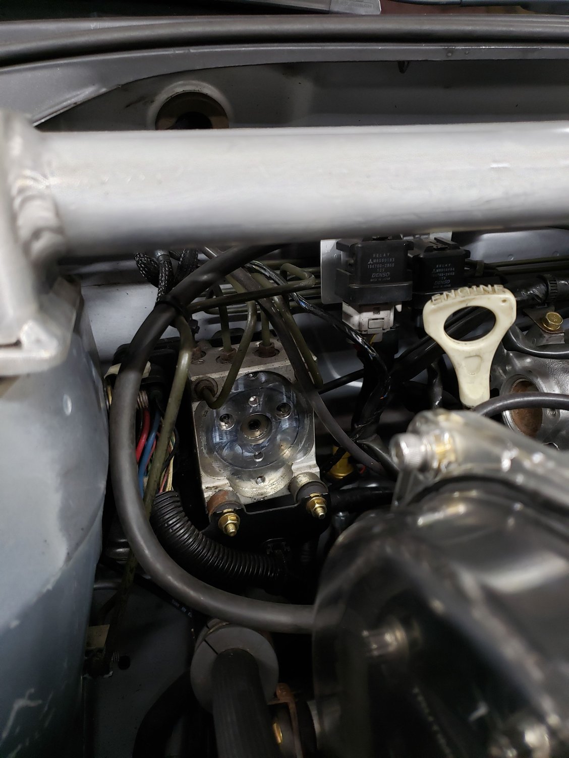

I sent Sean this pic from the other day...LOL! So when I did my motor rebuild I pulled off the pump to clean off the rust. Well, I used antiseize on those 2x M6 bolts. Guess they're getting some blue this go around! Sucked bc lost ABS after 1st run and didnt notive that until I got home hahahah! Whoops!
Great catch subframe!
