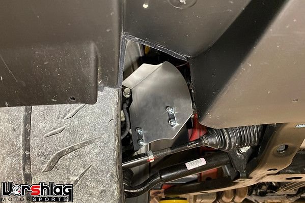

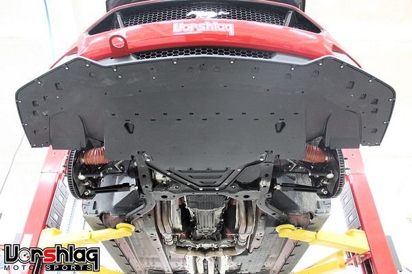

I was thinking about having diffusers coming off the splitter aimed to spray air on the deflector ducts.
Kind of like the ones Professional Awesome sells except not $150+, though I haven't seen a good alternative yet so I might end up making my own.
Just stumbled across this again. Seems high end S550's already have the diffusers.
Kind of the next level that our factory undertray has. I'm not sure there is space on an EVO to do that with
an upgraded oil pan (and/or oil cooler in factory spot) like many run (including me).
https://vorshlag-store.com/products/...-deflector-kit
