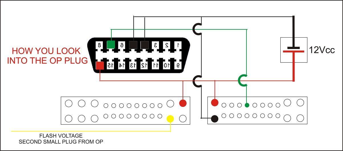

You do not have to change the factory wiring, you can instead make a bench loom for flashing the acd ecu... however you need to unplug it from the car then... and if you make lots of changes it is tiresome..
this is the diagram but you doo need a 2.0 openport cable.. Definitions you can find on this site or I can send you some but mine are old..
My car is wired up to in-car flash the ACD so no problem there. Plus its more convenient to change map to map at the track when trying new things.
