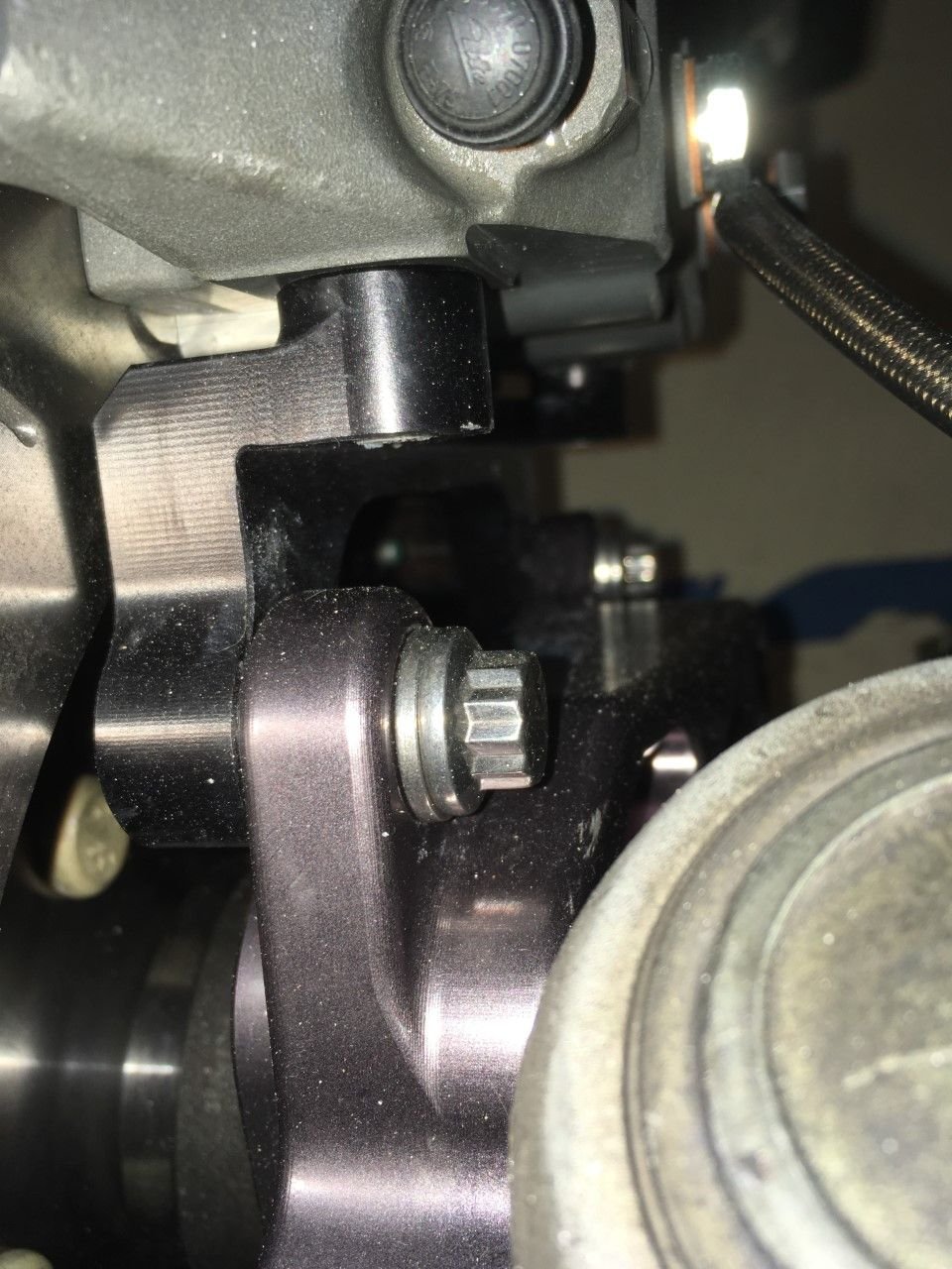

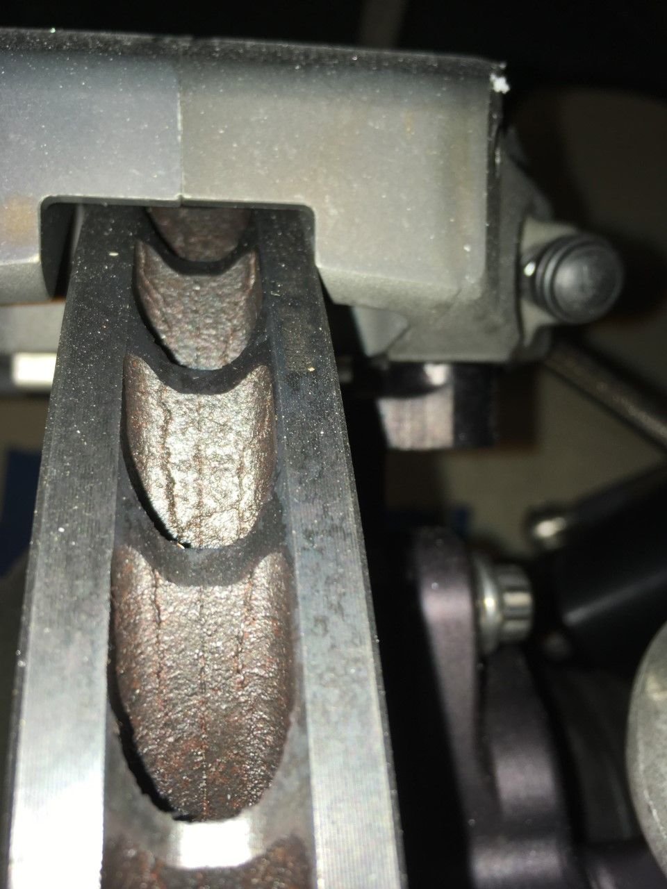

It looks to me like the rotor has to come out more not the caliper. As it sits my rotor is hard against the inside pad and caliper surfaces, putting a washer would move it out more, Compounding this instead of spacing it?
Old Feb 25, 2020 | 03:55 PM
  #62
Dallas J's Avatar
Veteran: Army
Posts: 5,969
Likes: 811
From: Portland, Or
Unless his brake mount goes the other way, with the bolts coming from the outside and the bracket mounting on the inside of the hub? But that seems like a pretty odd/terrible way to do it.
Yeah, spacing the caliper is compounding the offset from removing the heat shield.

They do, sits on the inside of your ears and the bolt head is reachable from the outside, would be impossible to get a wrench on it if the bolt head was on the inside. It says DISC on the side facing the disc, and the alcon numbers face up. Caliper wouldn't begin to mount any other direction. Both brackets are identical.

Got a picture of it?

Like you said it's not much, a couple mm. But one tries to fathom why when a rotor hat was clearly designed NOT to accommodate for the e-brake, that they design the rest for the e-brake.....
From what I can tell this is Alcon's kit and Ross sells the pieces. Bracket is Alcon's too. Because race car.

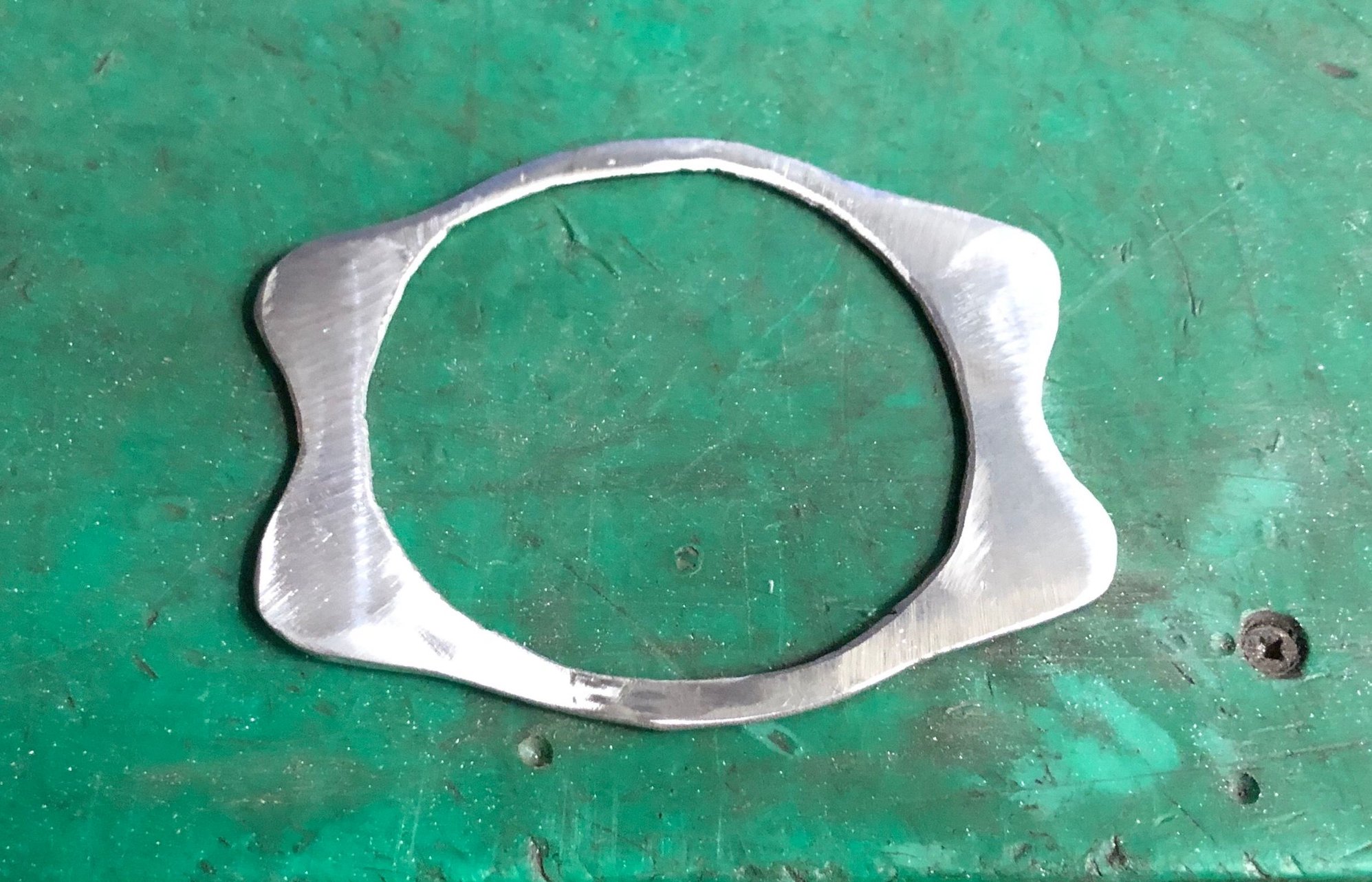

If it needs to be centered and you need the caliper more towards the center of the car the easiest way to achieve this is to machine the required amount off the mating face where the caliper meets the bracket. safer than spacing the disc itself out from the hub.

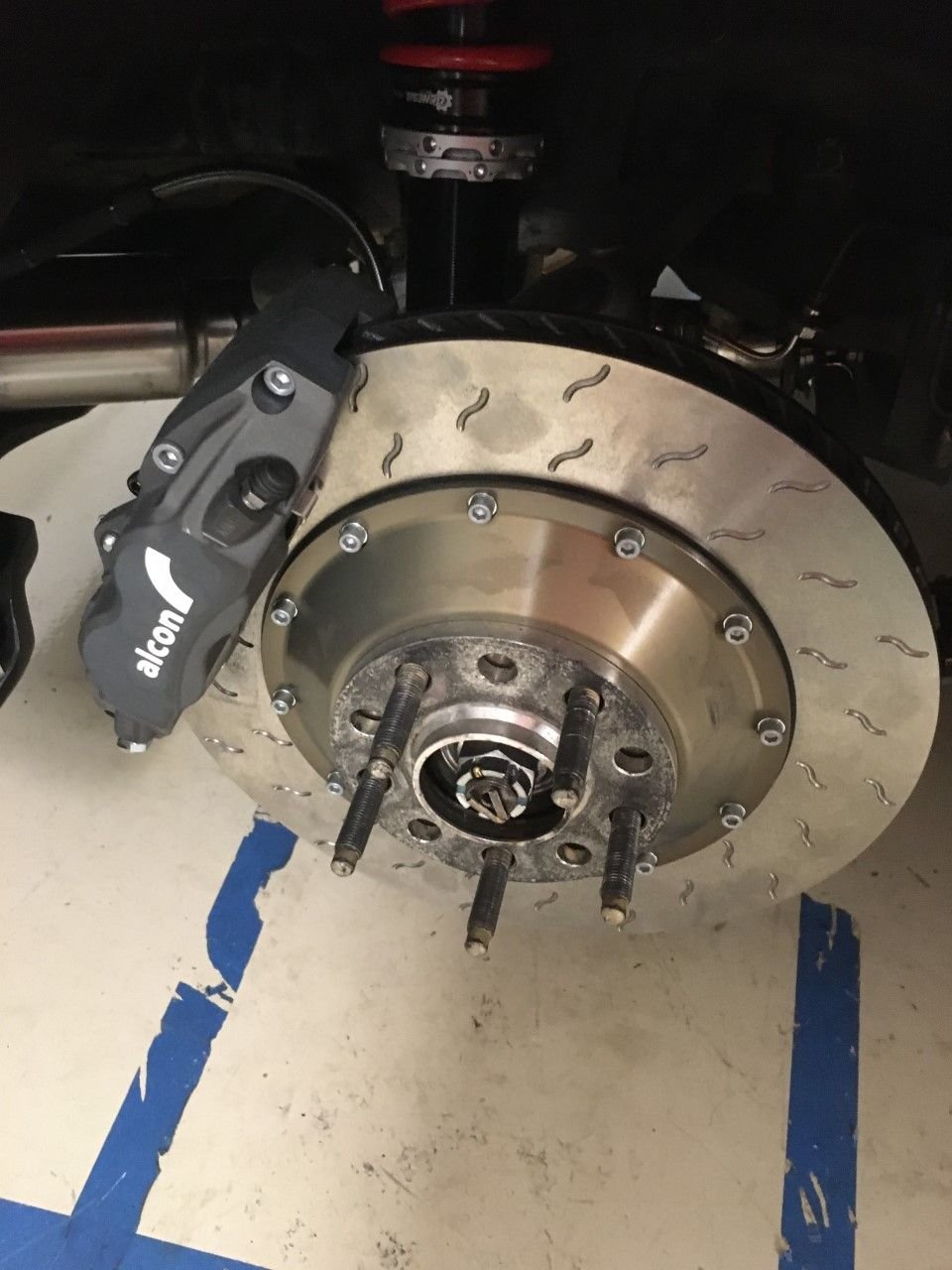

Thats a serious brake setup for the rear end!

Originally Posted by Phil1291
I have the OEM Uprights and the brakes where 3mm offset.
After talking to Ross from Ross Sport, we quickly discovered the problem.
It‘s the missing heat shield between the hub and the wheel bearing.
So i looked for a quick solution and made a „spacer“ from 1,5mm Aluminum between the wheel bearing and the hub.
Now the brakes are perfectly centered. We‘ll make them better for the ones we will really use. This was just the prototype.
I got the same exact shim with the grN Brembo kit...
