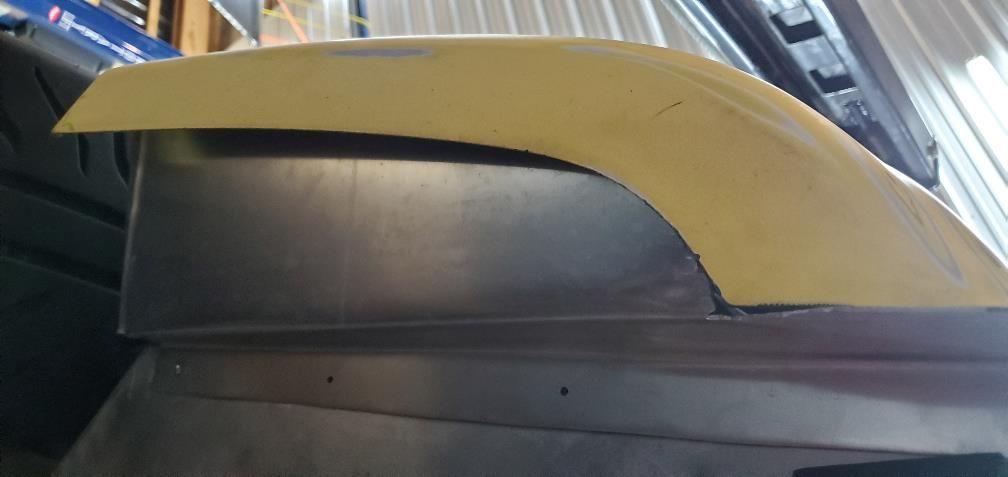

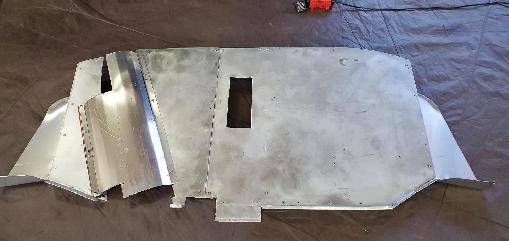

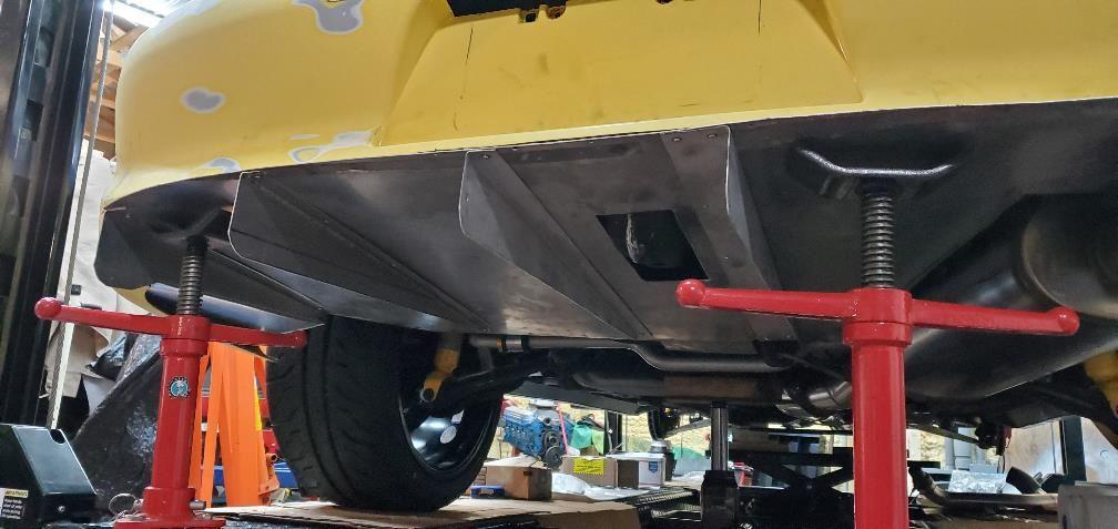

A lot of time recently, combined with mostly free materials, and a pretty well equipped shop.
Will it do anything, probably not, fun to build anyway.

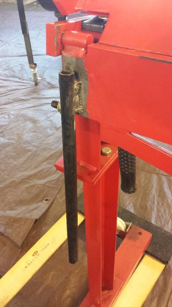

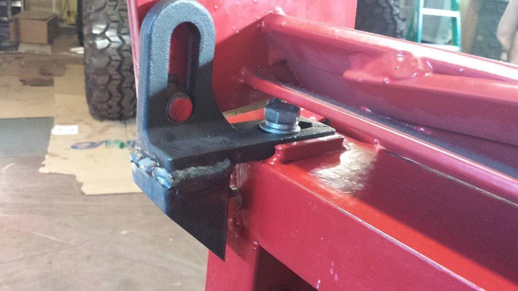

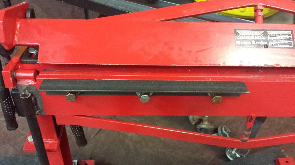

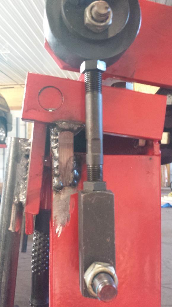

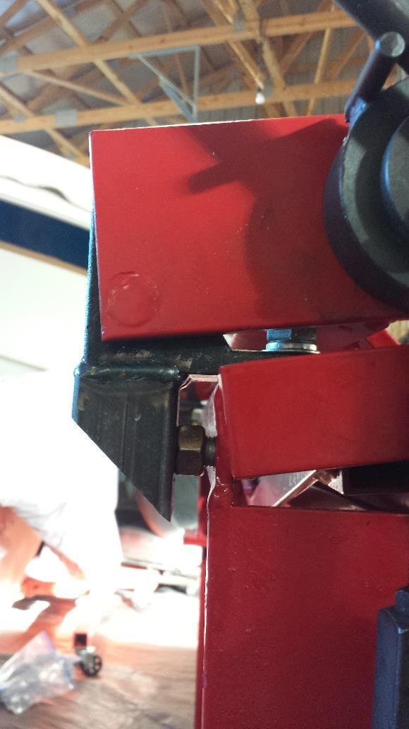

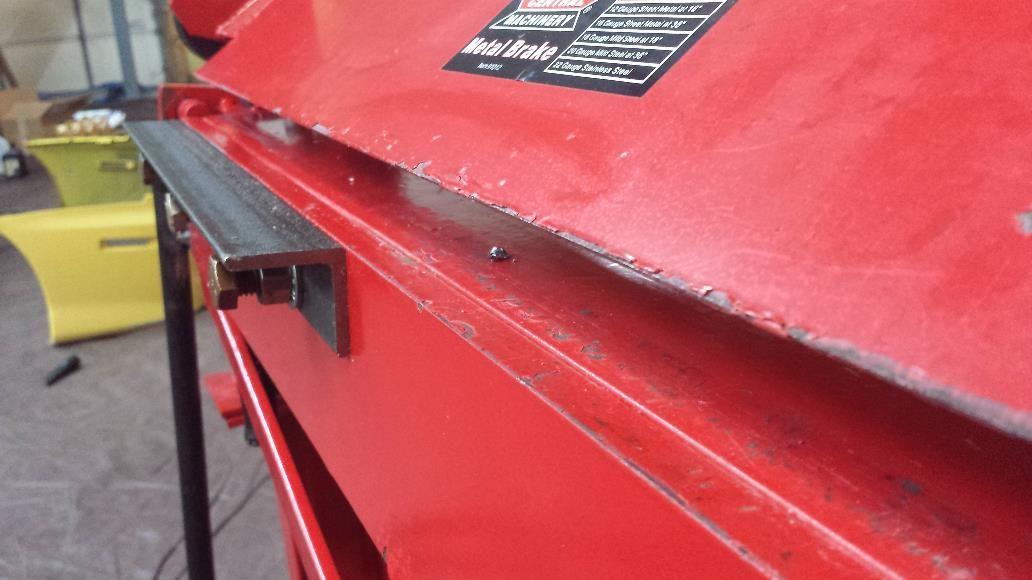

First thing I did was upgraded the HF brake........

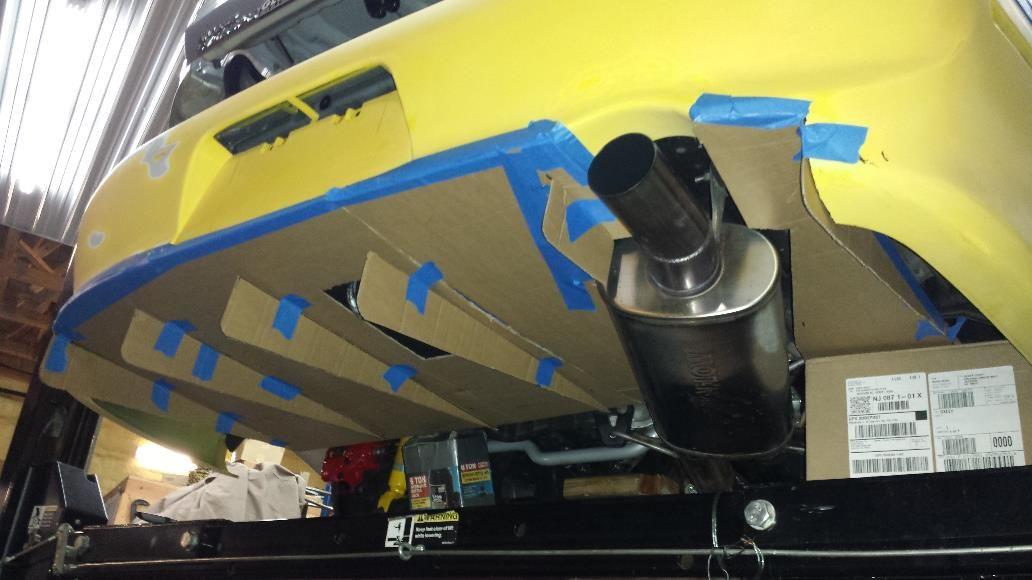

Decided to get used front and rear bumper covers to hack up, since my car is pretty
low mileage with very little scratches/chips.
In cardboard.......

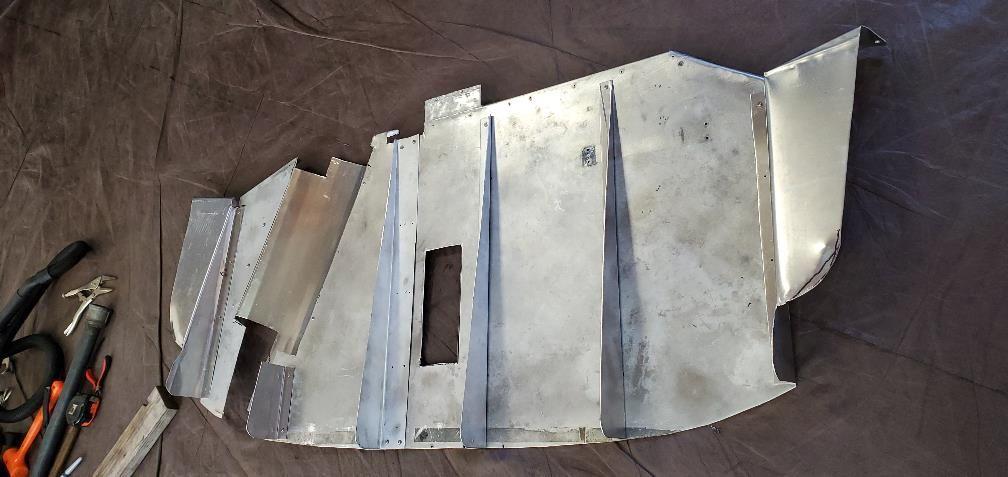

Mostly done...........

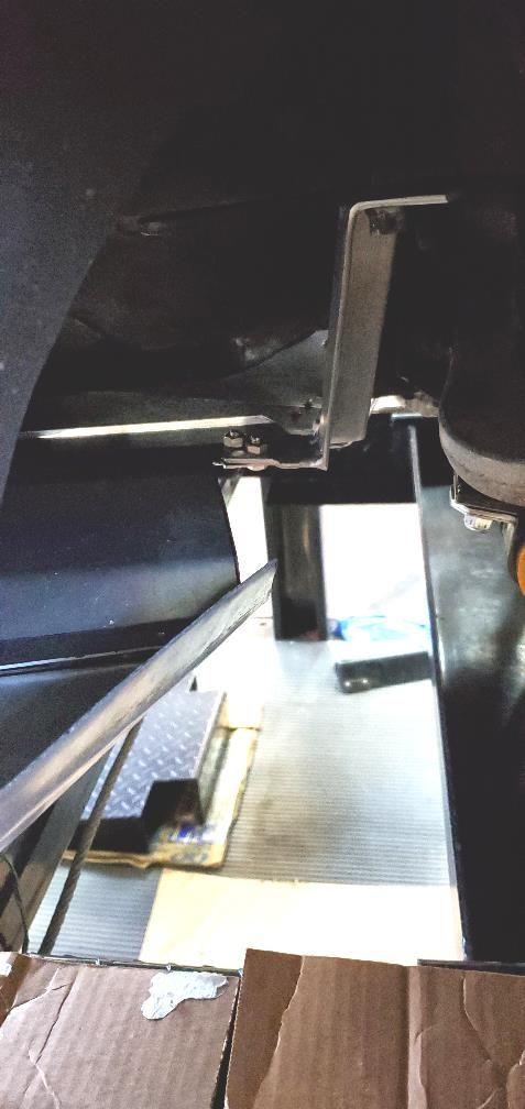

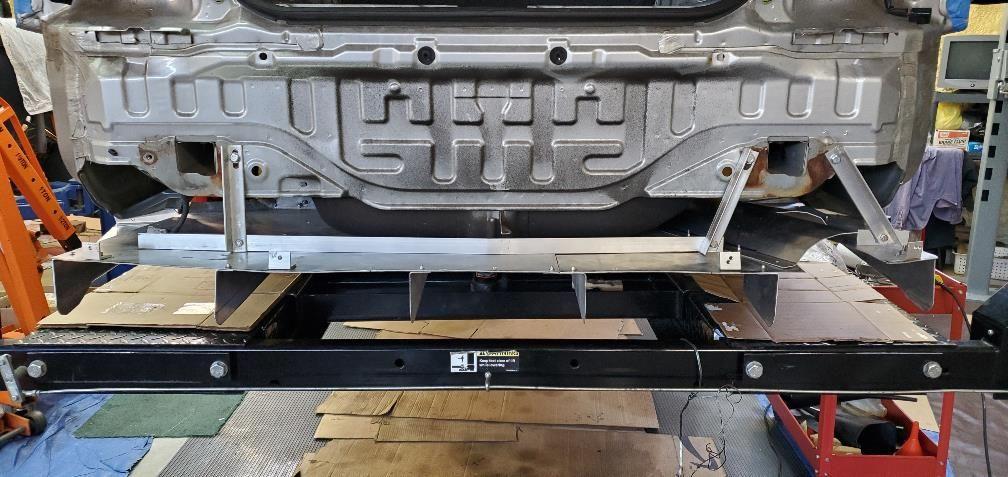

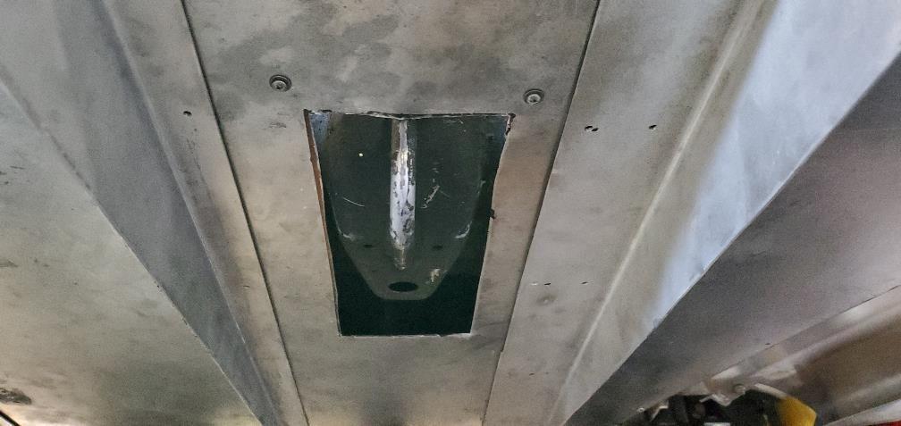

Frame mounts.........
Tried to incorporate stock tow point to save a bit more weight.......
Need to sand it all down, finish all the "fin" mount holes and paint flat black eventually.

​​​​​​​I can measure how far up I cut the bumper. Any farther and the flat surface hits gas tank and you can't get the angle you want.
Originally Posted by kaj
Nice! I'm also looking to make one...but no materials to use...
Made it all from 1/16ish alum (might be 3/32). Used electric cutting shears with steady hand to cut pieces.
The most expensive part was the brake really. Even if you paid someone to bend pieces, should be much
less than $200 total.
