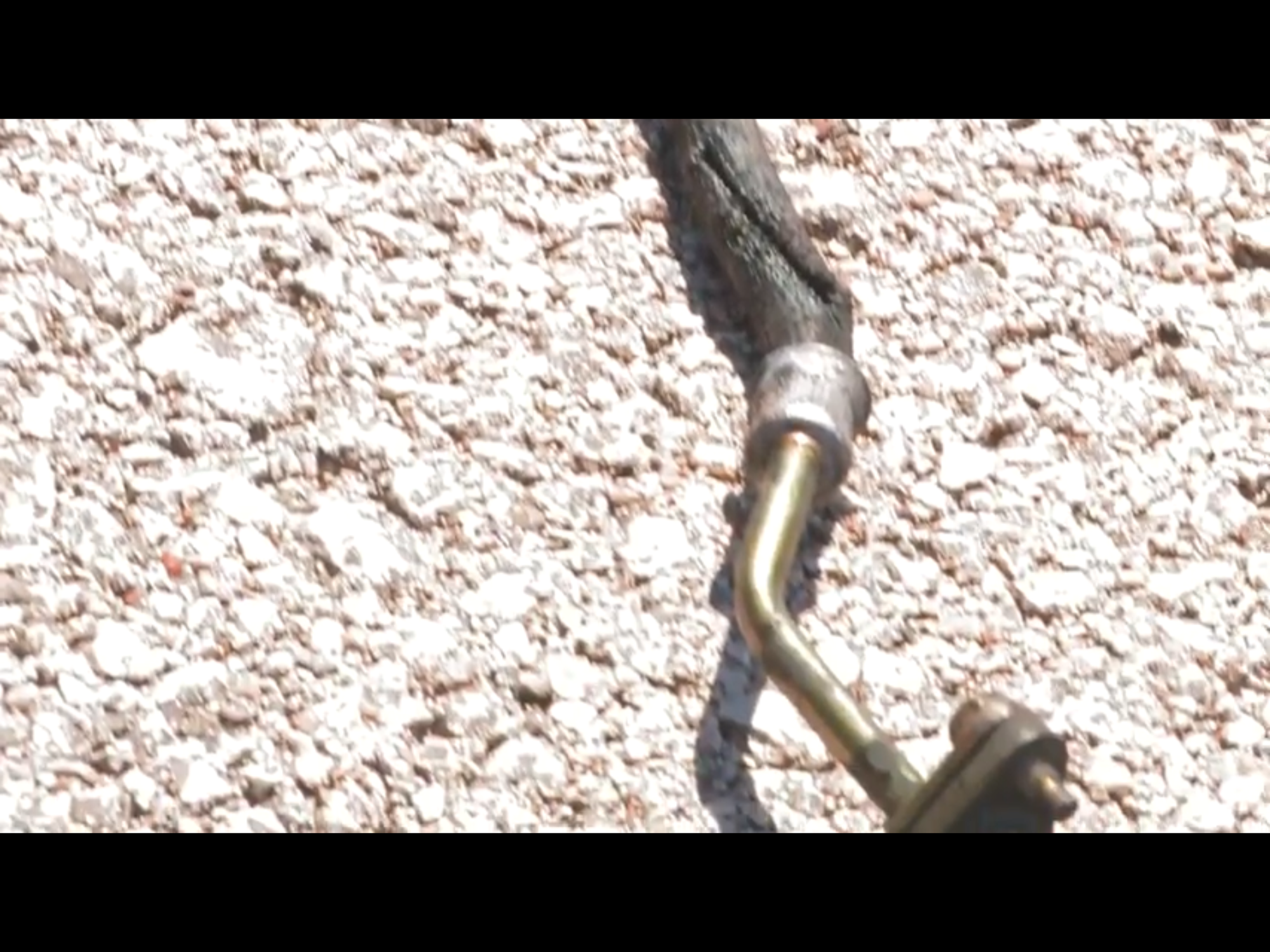

From: Northern Virginia
Another thing I’ve wondered about is the reliability of the stock feed line. This video is always in the back of my head.
Old Aug 16, 2020 | 12:18 PM
Chrispy0530's Avatar
Joined: Apr 2009
Posts: 307
Likes: 23
From: Miami, Florida
This is scary! It's for reasons like this that I keep a fire extinguisher in my trunk.
Old Aug 16, 2020 | 03:33 PM
LetsGetThisDone's Avatar
Joined: Oct 2013
Posts: 15,973
Likes: 1,629
STM and Radium sell a kit to replace the under section of the fed line with 6am race hose.

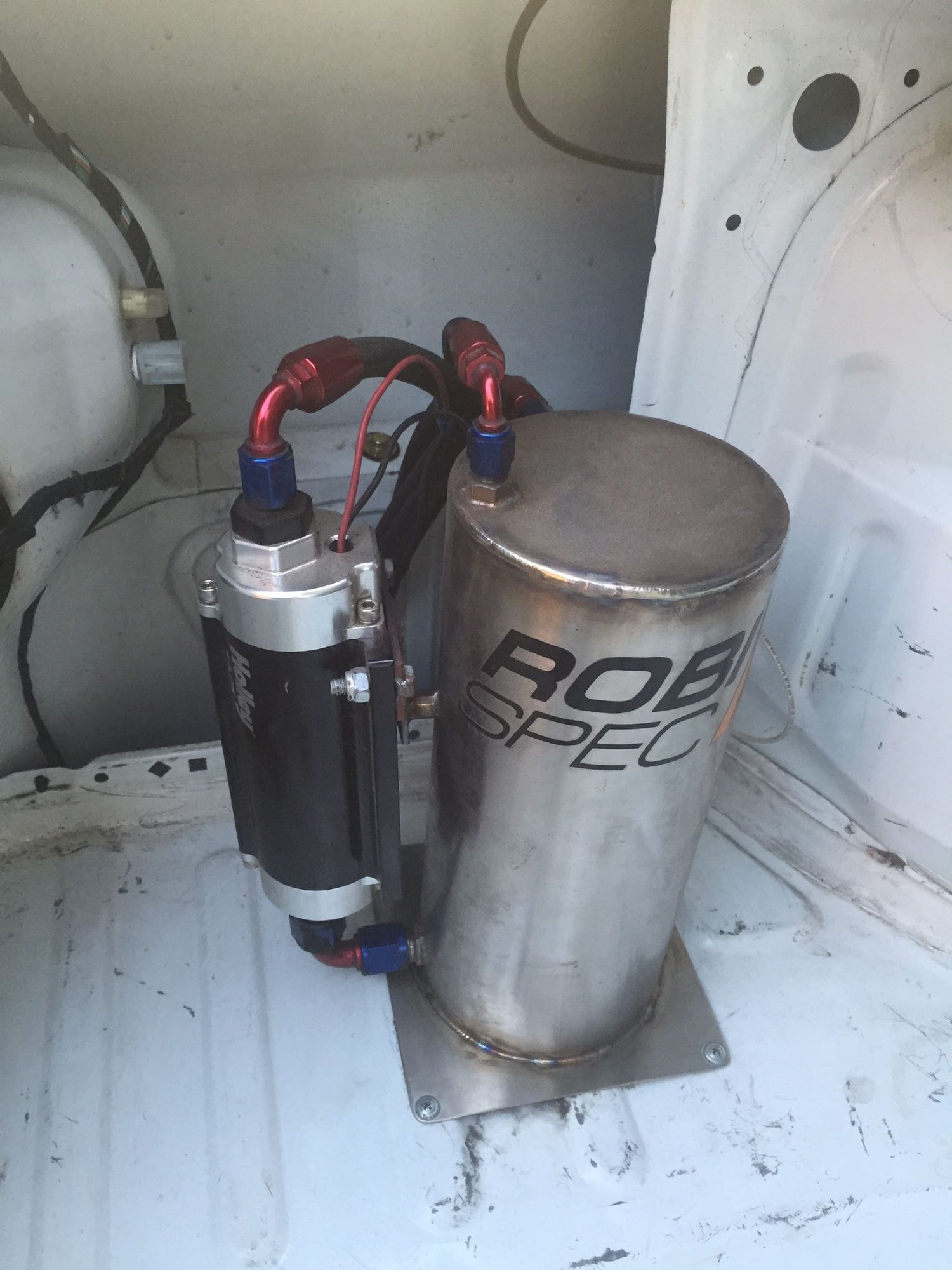

Old Aug 26, 2020 | 12:38 PM
Driv200's Avatar
Joined: Mar 2005
Posts: 739
Likes: 55
From: Oklahoma
My surge tank set up. Mainly to have extra fuel when low fuel light comes on. Peace of mind on long turns to.
Twin external fuel pumps.
