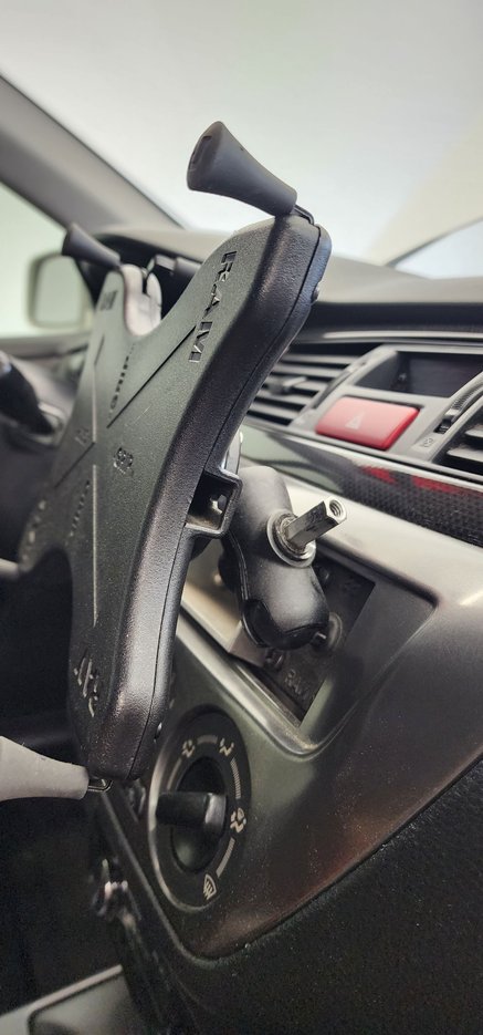

Doug, what mount are you using for your tablet?

IIRC they use the ball mount from Ram Mount and their bracket to attach to.

thanks Brent, and yeah, I relocated the stereo and put an aluminum tube+bracket in the DIN, ball mount+short arm and ram tablet mount.

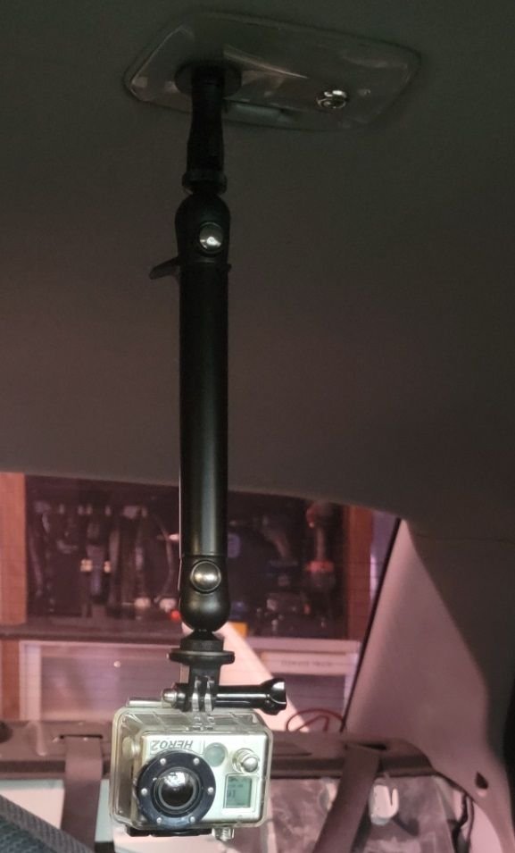

@4wd4me I bought this.... and just as I hoped the screw(s) is the right size. my dome light bracket is not as rigid so the camera end is kind like a tuning fork. I will need to add something between the roof and the light assembly hoping for more stability

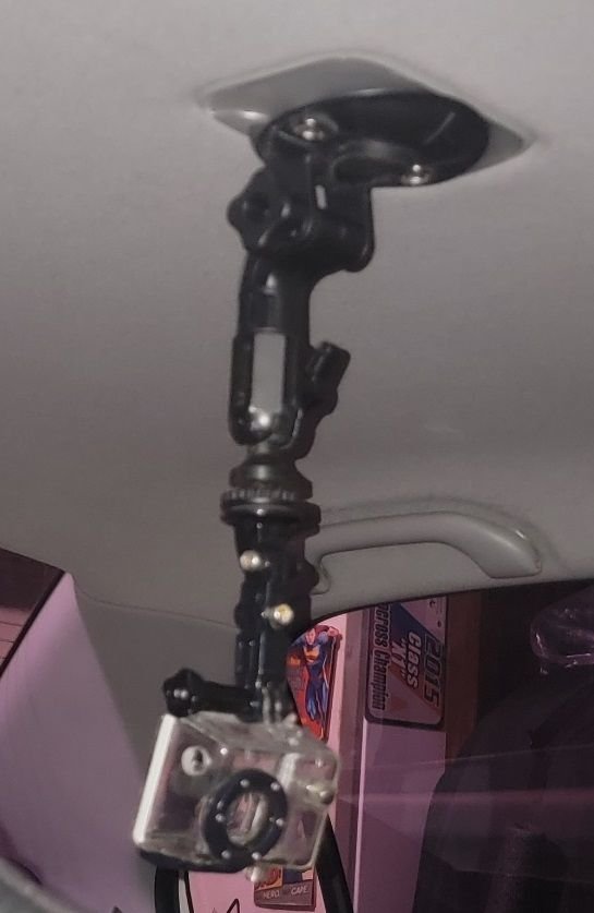

I also tried a suction cup mount (without the suction) using 2 screws, which is a bit more stable and centered. added a bungee cord hoping to stop the oscillation. no dice lol

are you using a gopro or other lightweight camera? if I remember correctly ours was fairly stable (hollow rod also) but we did eventually just replace the dome light with a c-channel and aluminum cover plate.

I was planning to use my Hero2 which has a jack for the mic extension. I think the main issue is the mounts are too straight. I need to add some triangulation/support. maybe 2 of those mounts in separate attachment points should do it. There's also a lip on the upholstery, where I had to add some HD foam. For now, I'll test what I have so far
