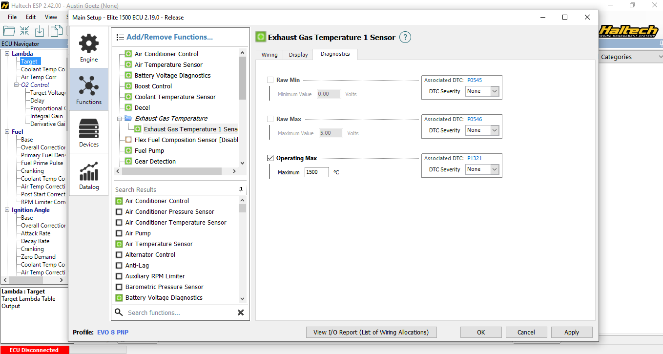

Upon reading on Hal - it seems the failsafe's are very specific - not included among them was EGT. Or am I just reading this wrong?

Originally Posted by Balrok
For real lol.
There are safeties for EGT. EGTs are read over CAN through their EGT module so you have to enable the module in the ESP software. Safeties are easy to setup.
