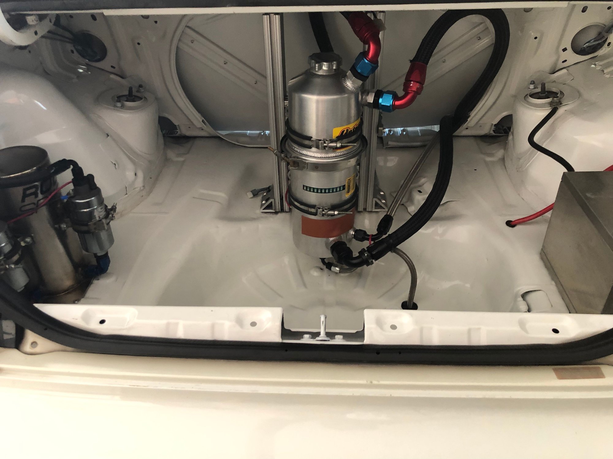

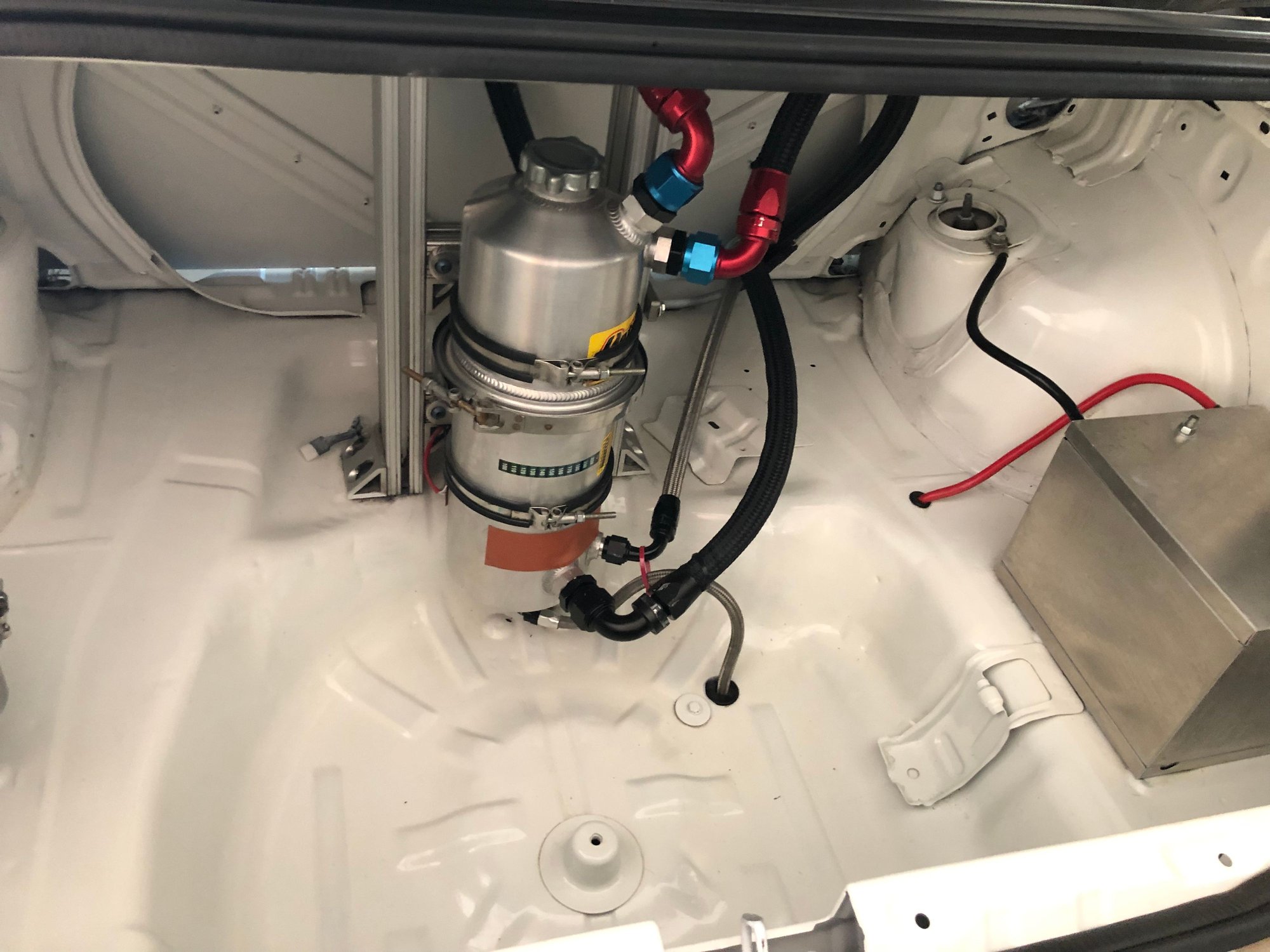

You’re not really paranoid till you do this.
