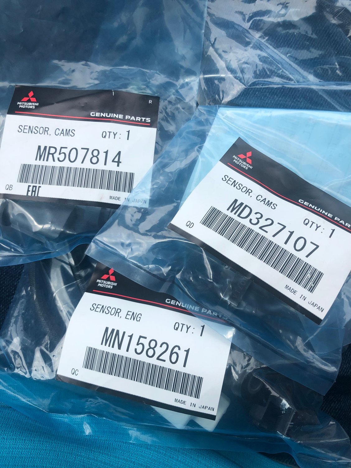

Do you have another car you can swap the cam angle sensor with? I’d try that if you haven’t checked it yet. That was my issue and decided to try it after reading MrFred’s thread on it.

Just arrived. Trying all sensors.

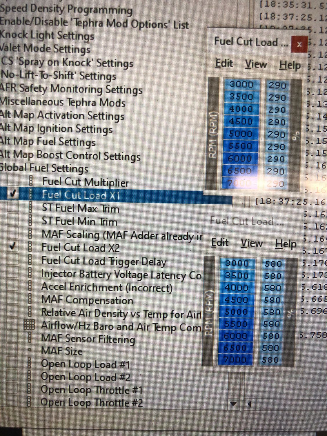

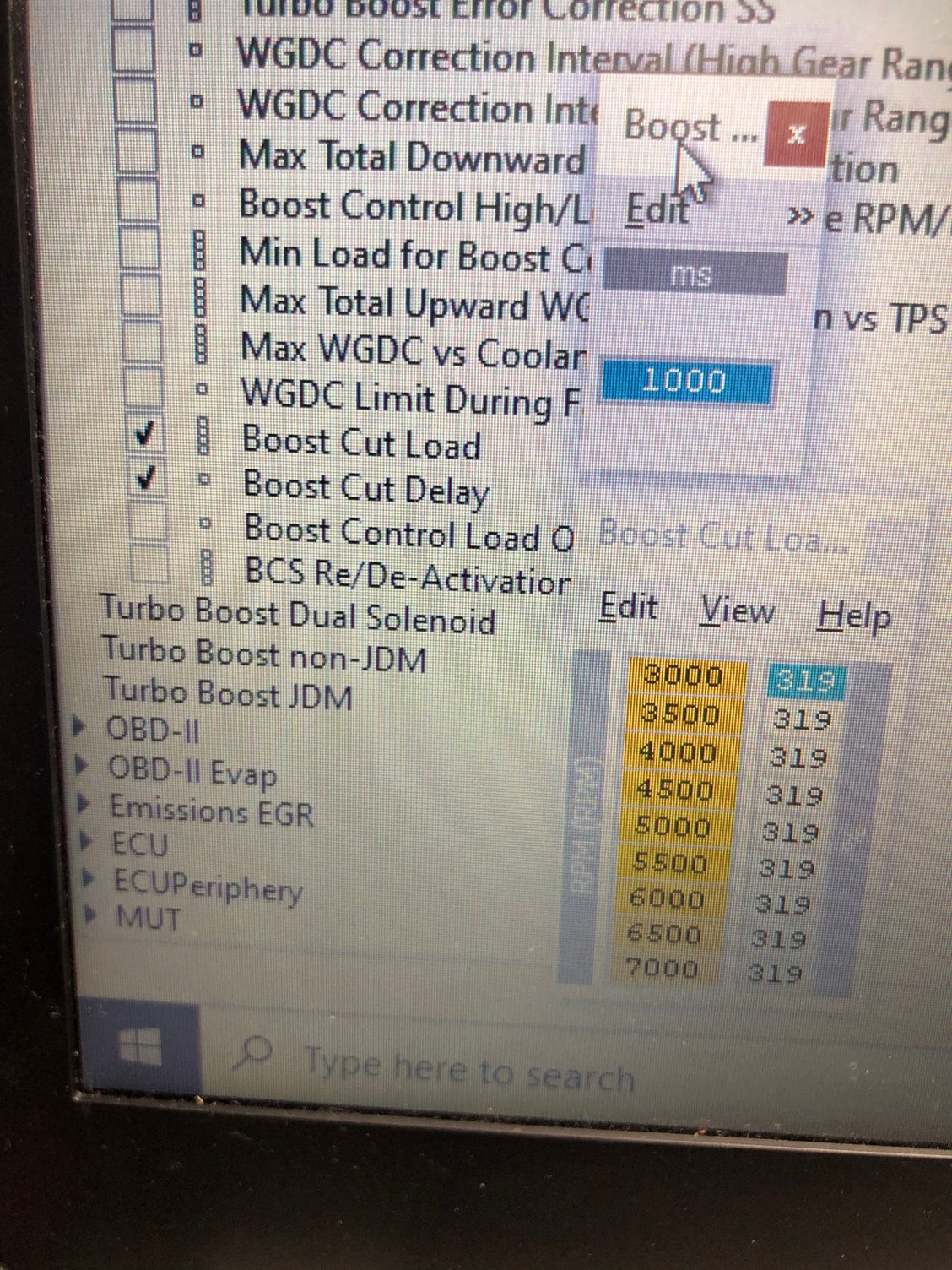

S. O. S.
New sensors in. Exact same problem. Load threshold is 350%. We are hitting load at 150%. There is a setting somehow that is causing car to shut off fuel. WTF! Out of options. What could have possibly changed by swapping to different style clutch and new trans?

Did you check the load/boost cut limit??

From: Oklahoma
Here is boost load cut:

From: Oklahoma
Fuel cut load 1 & 2

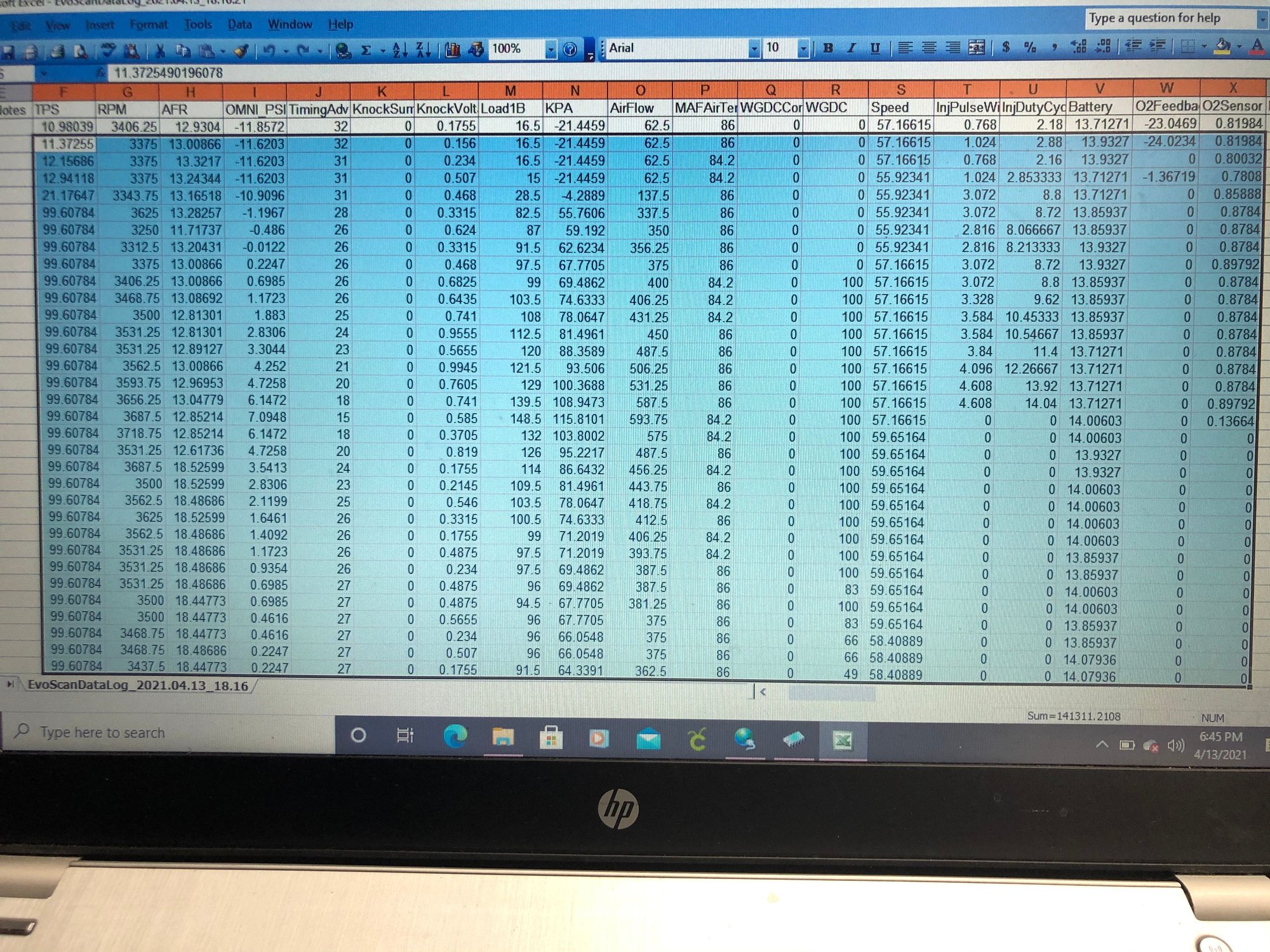

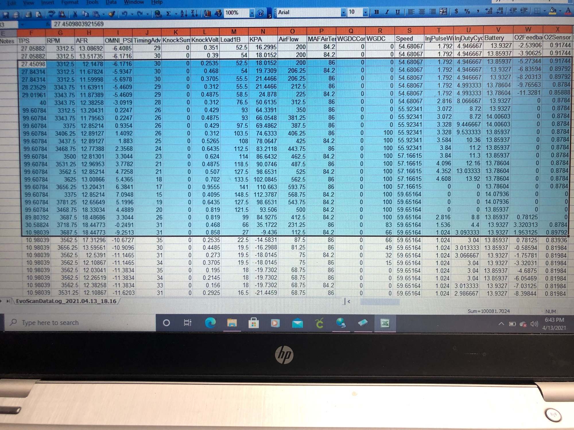

Latest logs: check 150 load
NLTS - no lift to shift is only setting we have at 150 threshold
We can email the ROM to anyone interested.
