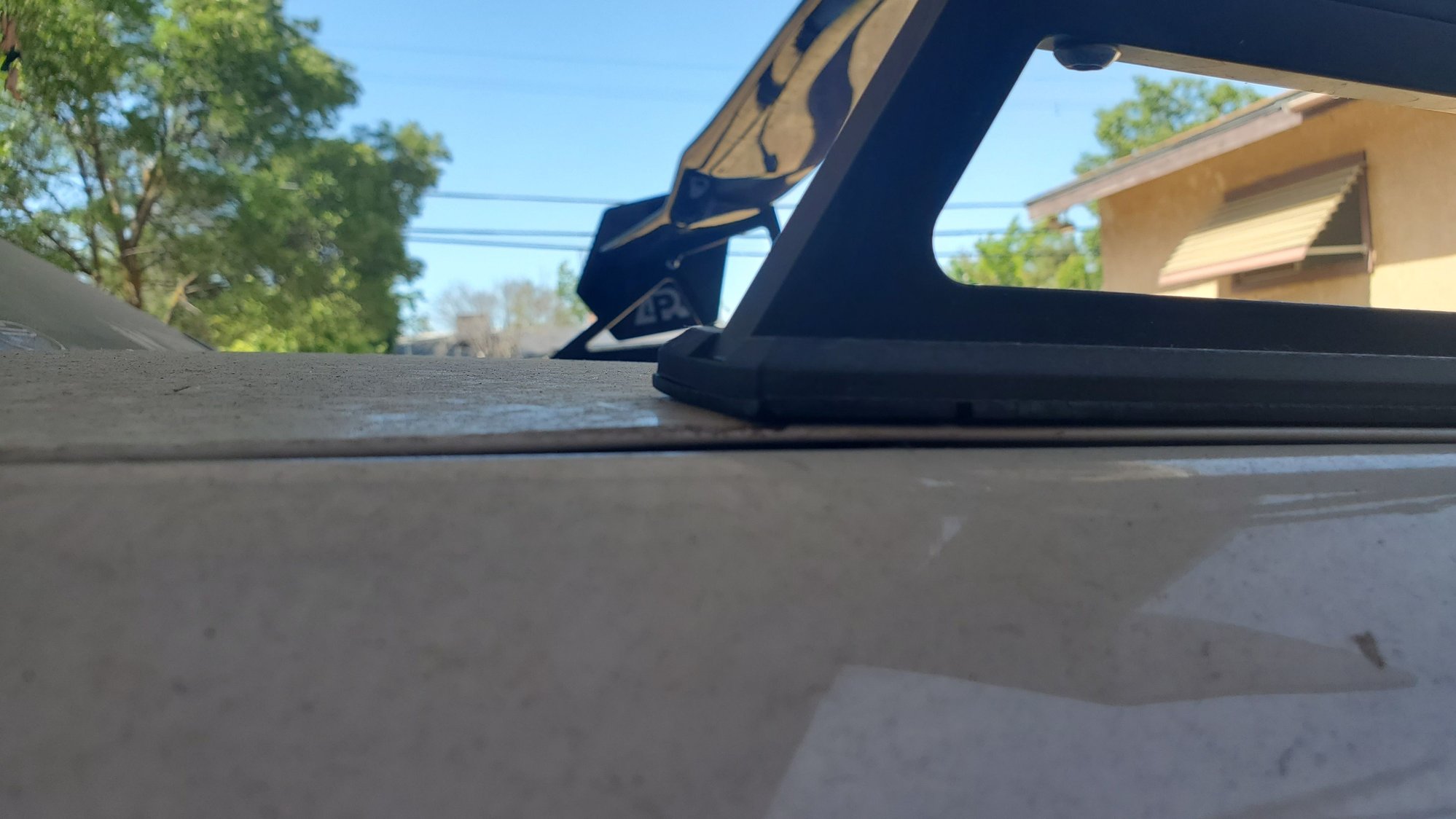

I have an APR 300 wing. Looks like it's producing enough DF at MIN AOA to left the sheet metal of the trunk. I can see some deformation right in front of the mount. I am not moving a a larger Kognition wing and so am obviously worried about it being worse seeing how it uses the OEM mount points. To make things more complicated, I have a dry carbon trunk I'd really like to use.

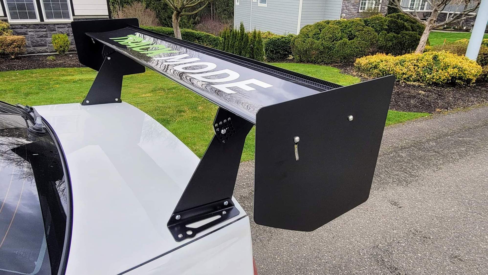

Maybe just doing w/Tim did w/one of his rear wing versions. Wide base foot print (see pic) and removing the rubber trunk feet & going to a solid foot. Pretty sure he moved on to a real serious Cognition wing where the verticals descend down through the trunk sill & onto to the trunk floor
That may work on my metal trunk, for now. The new wing has a really nice-sized base.

When I say the wing is lifting the area in front of the mount, I mean right in the middle of the trunk.
I can actually see and feel where the metal is bent.
It's like this on both sides.
I can't imagine this Wing would put that much stress on the trunk, but I can't figure anything else it would be from.
