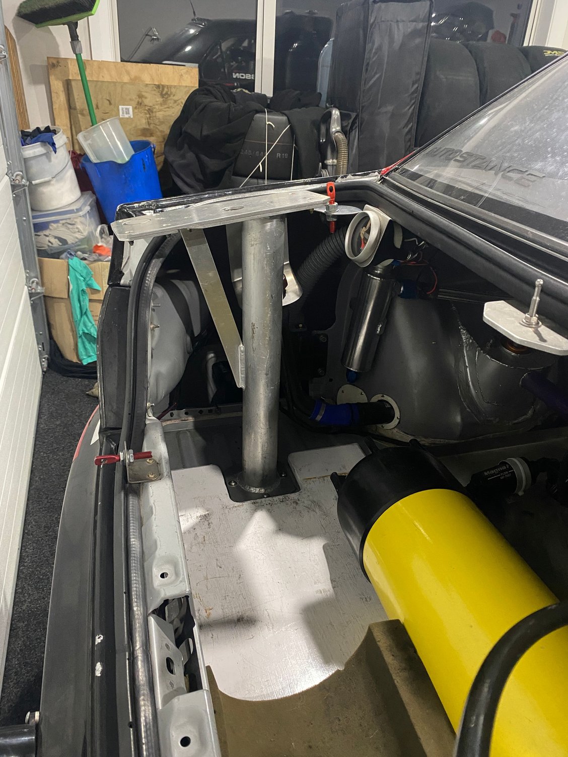

Again, I'm not worried about the front of the trunk lifting. Okay. I am now LOL. My problem was the middle of the trunk bending due to the front of the current mount pulling up on the metal. I didn't have this problem until I did the ROVAL at ACS. Will I go that fast again? Not sure... but now I know it's a problem, so want to fix it.
I'd imagine an adjustable stop on the back side of the mount would help. As would a hood pin. I'll do both.

Bit irrelevant now after seeing ur reply but these are my turret mounts for future reference or anybody lurking.
the middle front of the trunk lifting is a decent issue and u wana address it for sure.

Scuba Steve hahah thats for the air jacks i just cbf taking it out. i also dont leave the park bench plank in there either thats so i can store stuff when we go to n from the track haha.
