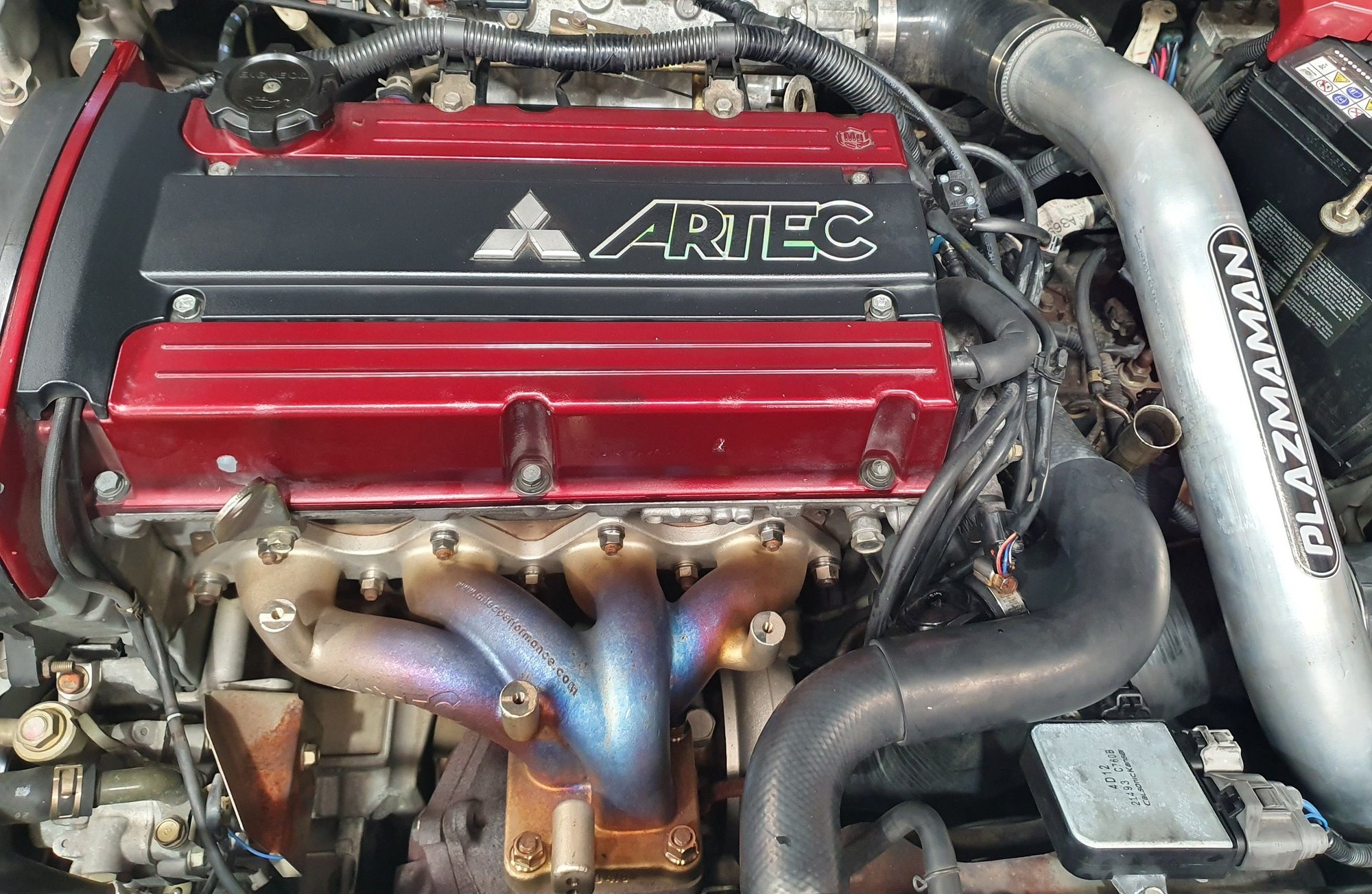

A recent pic of Ben's own 9 wagon eng bay. The car has been doing a lot of wot runs with a box I built.
Interesting to see the heat color change in the cast S/S exh mani. To me it shows the heat at the head is fine!
