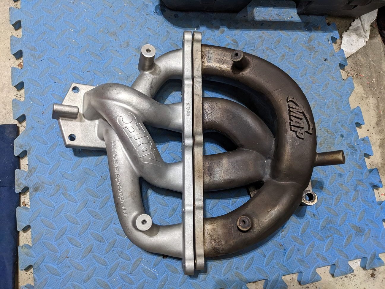

The ARTEC manifolds (I can speak to the X, as I've been running it) are made of 347 stainless steel. This is superior to say 310 which is used for the MAP EVO X manifold:
AISI 310 Stainless Steel vs. AISI 347 Stainless Steel :: MakeItFrom.com
Maximum mechanical temperature is of interest: 870 vs 1040 !!! (20% increase!)
By using a superior material, the walls can be thinner and thus the manifold lighter.
here is a pick of those two manifolds compared, from my build thread:

man that artec evox manifold looks skinny

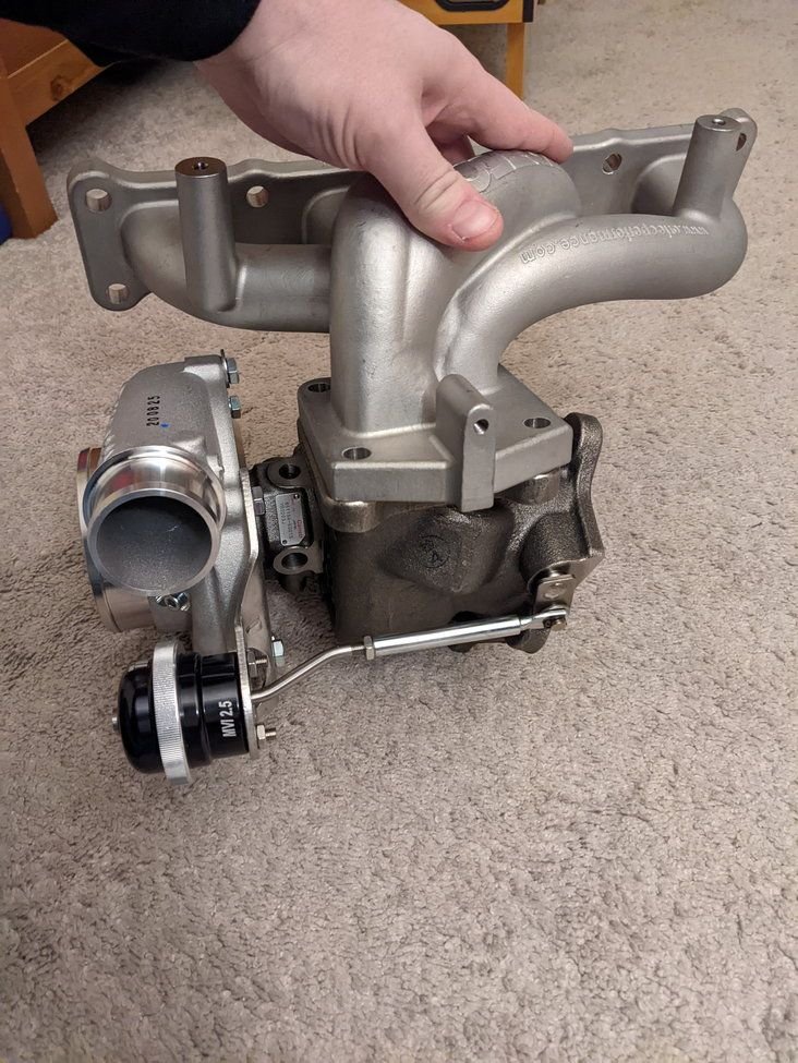

Well I didn't think that until you showed me the Evo 1-9 manifold!
These are again pics from my build thread:

I suspect the Artec is also much easier to install? There appears to be significantly more access to the two bolts closest to the motor on the manifold to turbo flange.
