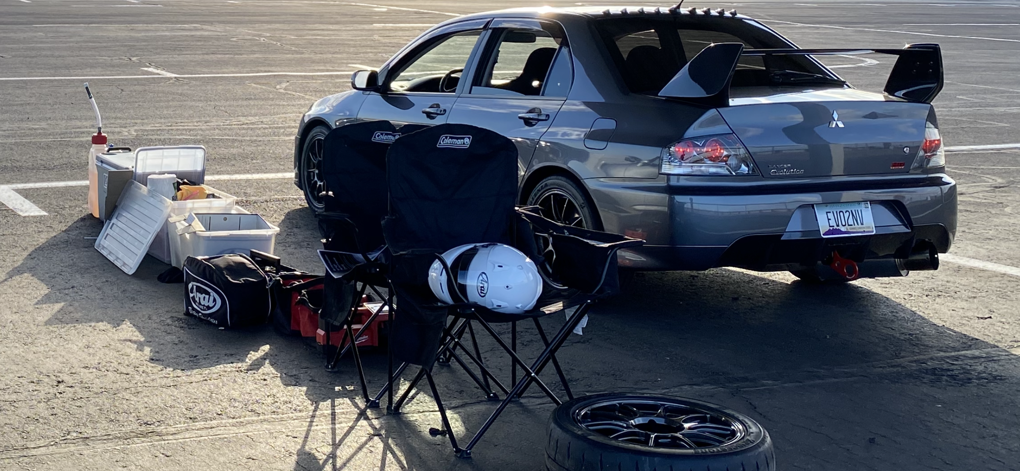

HOWDY!
I purchased a 2005 EVO 8 MR and started modifying it for reliable and fun track days. Now I want to build something competitive but keep the mods as mild as possible. I don't care at all about higher HP, I come from racing spec miatas and the EVO is FAST!
Anyhow, does anyone
race their EVO in TT4? Any advice if I decide to move forward. My friends joke that the EVO is the fastest car ever made under 300hp, I AGREE and want to prove this!
