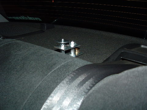

$8 worth of fasteners from Home Depot and I get a great view out of the entire windshield plus many of my body movements.
I don't think suction cup ones will pass tech, but the one I pictured below passes tech and most of the one listed in the above posts will pass tech AND are officially SCCA approved.

That's a wicked cool interior mount, Brian. Is that all fasteners, or are parts of that welded?
I'm surprised that SCCA groups would have a problem with something like stickypod, but wouldn't with a VCR in the back seat....? Yes, I know you're strapping it in somehow, but it seems that a VCR is at least as heavy as a digicam and would be at least as likely to want to fly around the cabin.... plus you need a power inverter (something else to break loose and take off toward a window or your head)..... but, whatever works.

Well, I haven't seen stickypod, so I could be wrong. As long as it's considered secure, it's fine. I don't get any problems with mine at SCCA events. They recommend I use a lanyard if I ever get a camera that weighs more than about a pound, but they say it's not going anywhere.
And as for its construction, no welding required. I made that out of flat stock with holes in it, 1/4 bolts, nuts, and washers. It bolts right into the child seat retention mount and only requires a couple of wrenches and a hacksaw to make. For anyone who wants to know, most cameras use 1/4" standard threads, so there's no special hardware needed.
